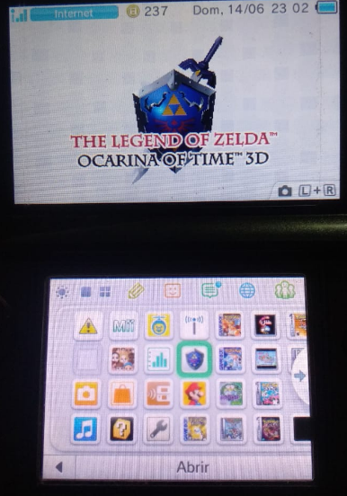

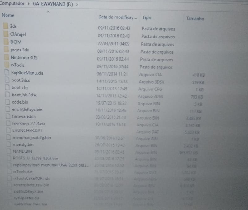

I found my old 3ds and wanna play the new pokemon game (ultra moon/sun) but my cfw needs an update... it's been 1262 days since i last played (thats what CIAngel shows xD), the only problem is, i have no idea how to upgrade it, i read that rxtools is dead so i need to change my cfw. All guides i find only show you how to install Luma+arm9loaderhax from zero, but not how to migrate from rxtools... I'm lost, i need to delete/unistall my cfw to install a new one? I need to upgrade cfw first then the original firmware? can someone shows me what to do?? I really dont wanna brick it cuz i'm new to this and the games i already get installed is working fine.
Thank you guys for helping!
some info:
RX-E 7.1.0-15U
Ver. 9.2.0-20U
Picture of whats in the Sdcard i'm using and the games working...

View attachment 213425 View attachment 213426
Use soundhax install boot9srap then m3rge EmuNAND to sysnand then do as guide says
https://3ds.hacks.guide/homebrew-launcher-(soundhax)

If you know what you're doing, you can just replace the rxTools payload with SafeB9SInstaller, which will cause the B9S installer to run at boot.
