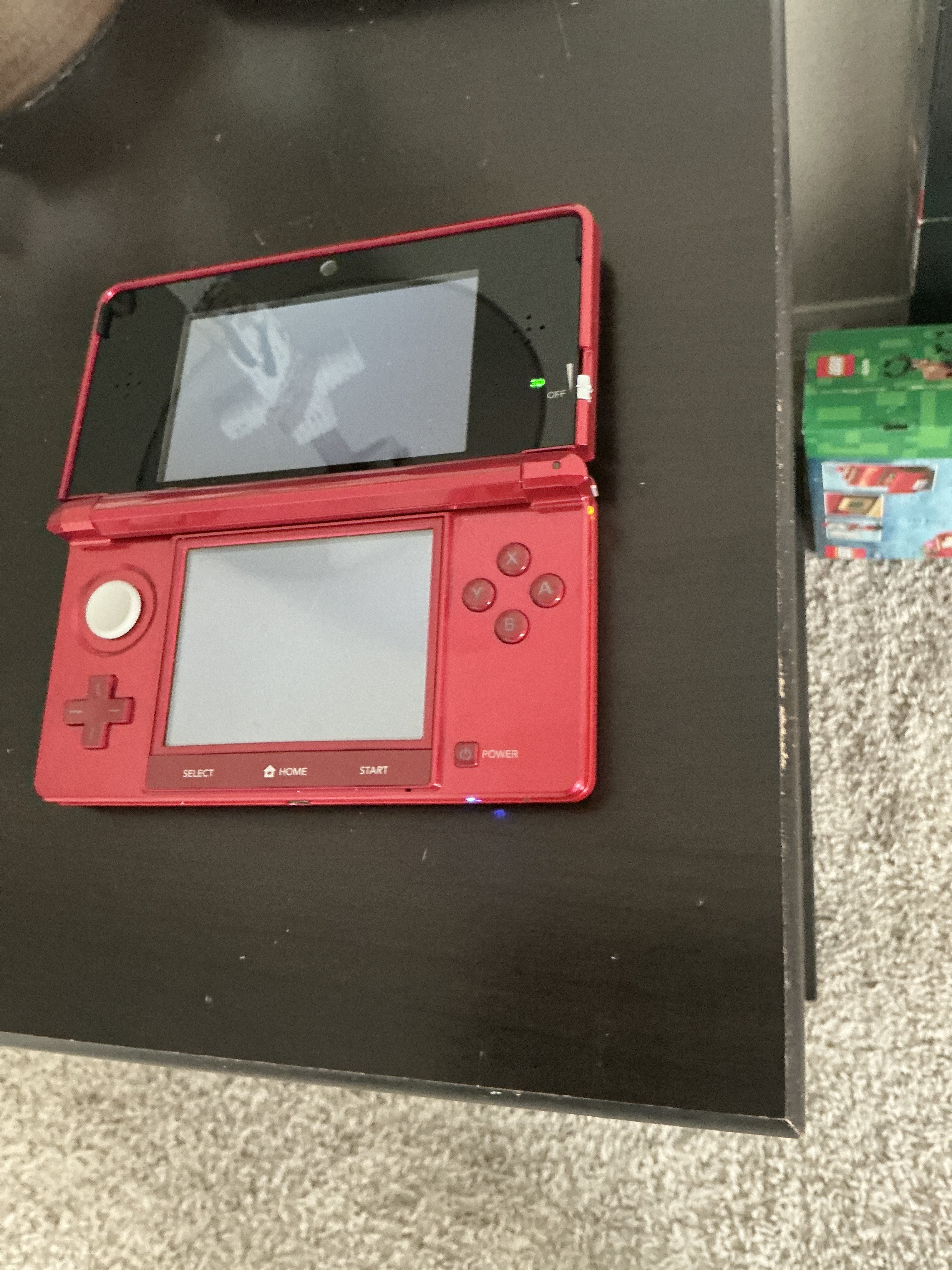

I’ve tried to see if it was the RTCBug, and that didn’t work, I’ve tried to boot into the 3ds safe mode, and that didn’t work either. Ended up trying the SD Home Menu ext data and CtR transfer too. I’ve been trying this stuff since last months using the different guides, and I still can’t figure it out!
This console also has stripped screws cuz one of my friends gave this to me for free in non working condition cuz it was dead and the port wouldn’t work, which someone helped me with, so if I needed to get into the console, it’s gonna take a while…
Also, is the WiFi light, and 3d normally on during this issue or no? Cuz now all light go on, but no scree or anything else. Luma, Rosalina, and GM9 are all accessible
What exactly do you mean by Luma and Rosalina being accessible..? Please be precise.
Also, does anything different happen if you turn on the unit without an SD card inserted? I don't know if you tried that because you haven't said anything about that. Don't you think that would be useful to know?

I mean I can get to them without a problem, no issues. On the other hand, the home menu doesn’t load. I think that’s
Nope, nothing different. Same lights are lighting up, and no home menu screen. I did try that, like first thing, but it didn’t work. I can’t even get into the system cause 2 of the screws were stripped before I think I ever got it.. I only have had it for 1 year, sitting in a drawer, waiting it fix it. Which I did (somehow), and then now I’m stuck with it again

My friend tinkered with the charging port by bending the pins back without opening the console, ok? That was not messing with the internals. I do think it could be a component, like the WiFi board, disconnected, or the ribbon cable. But I don’t know. That’s what I’m asking. I’ve given images, and all I know about this system.
