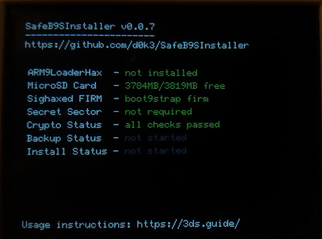

Your 3DS should have launched SafeB9SInstaller with that FIRM payload named as boot.firm like this.
If your 3DS still hangs at black screens, it seems the motherboard is not able to properly communicate with the SD card.

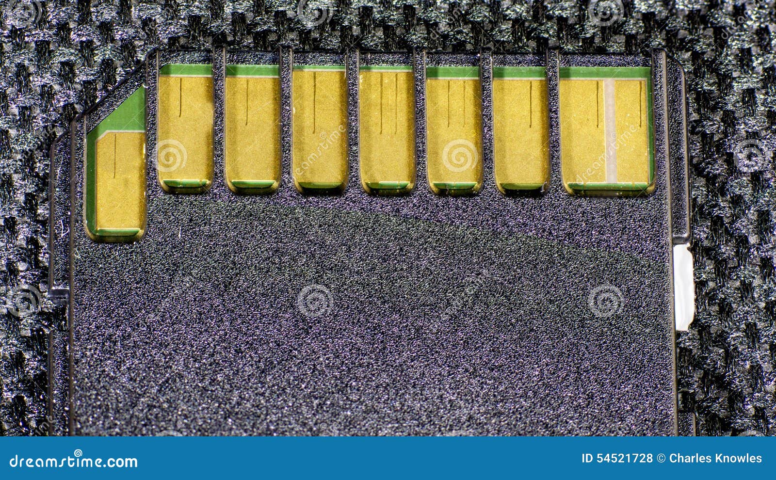

2. Clean the golden contacts of the SD card. Picture #2.
