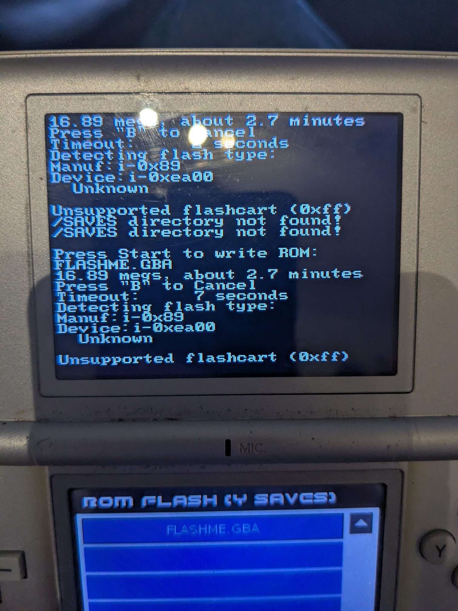

hmm, does it work for 128M aswell. I just tried this new tutorial. And I read on github 1.7b should work with 128M aswell. But i get error message
