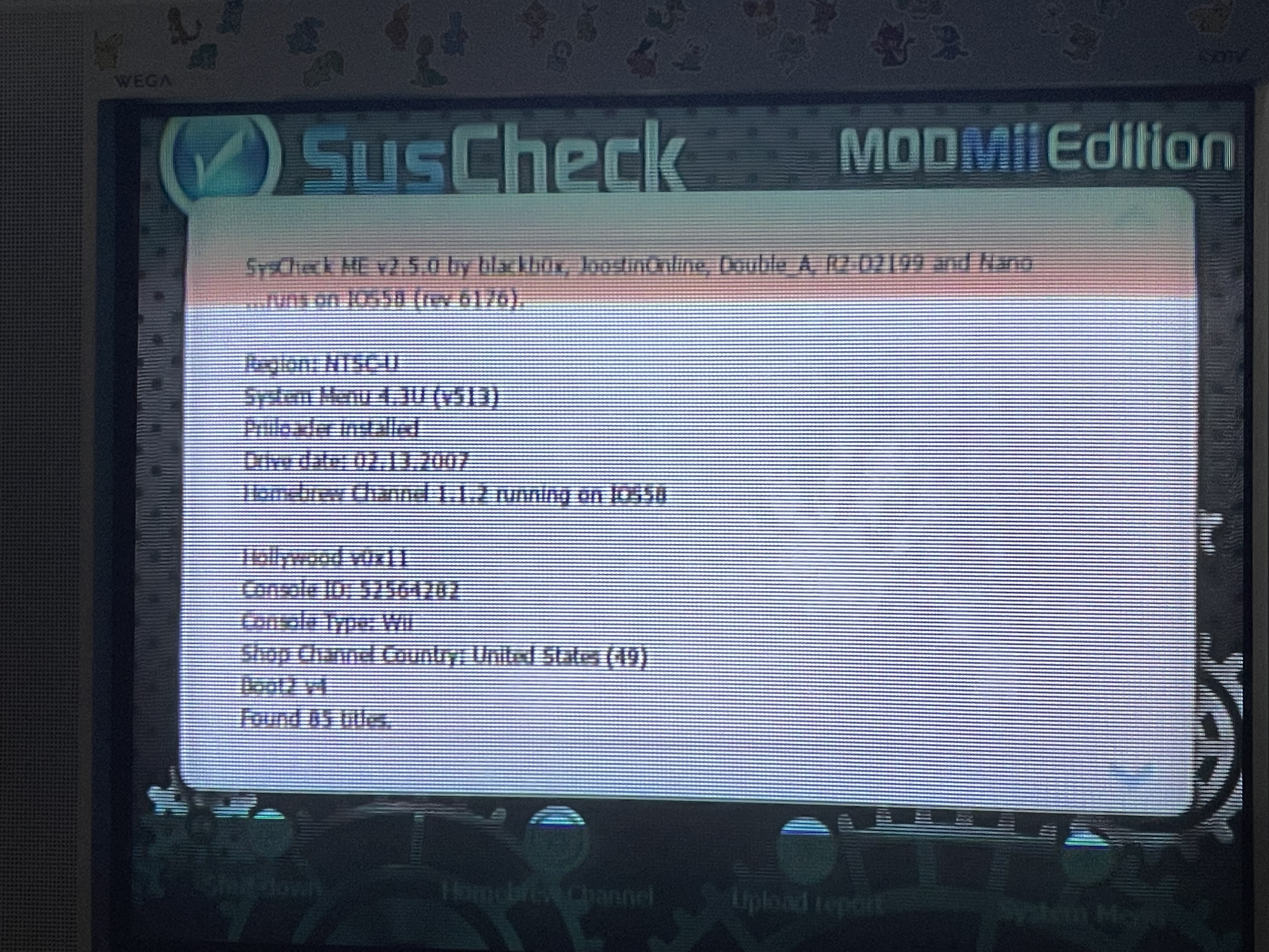

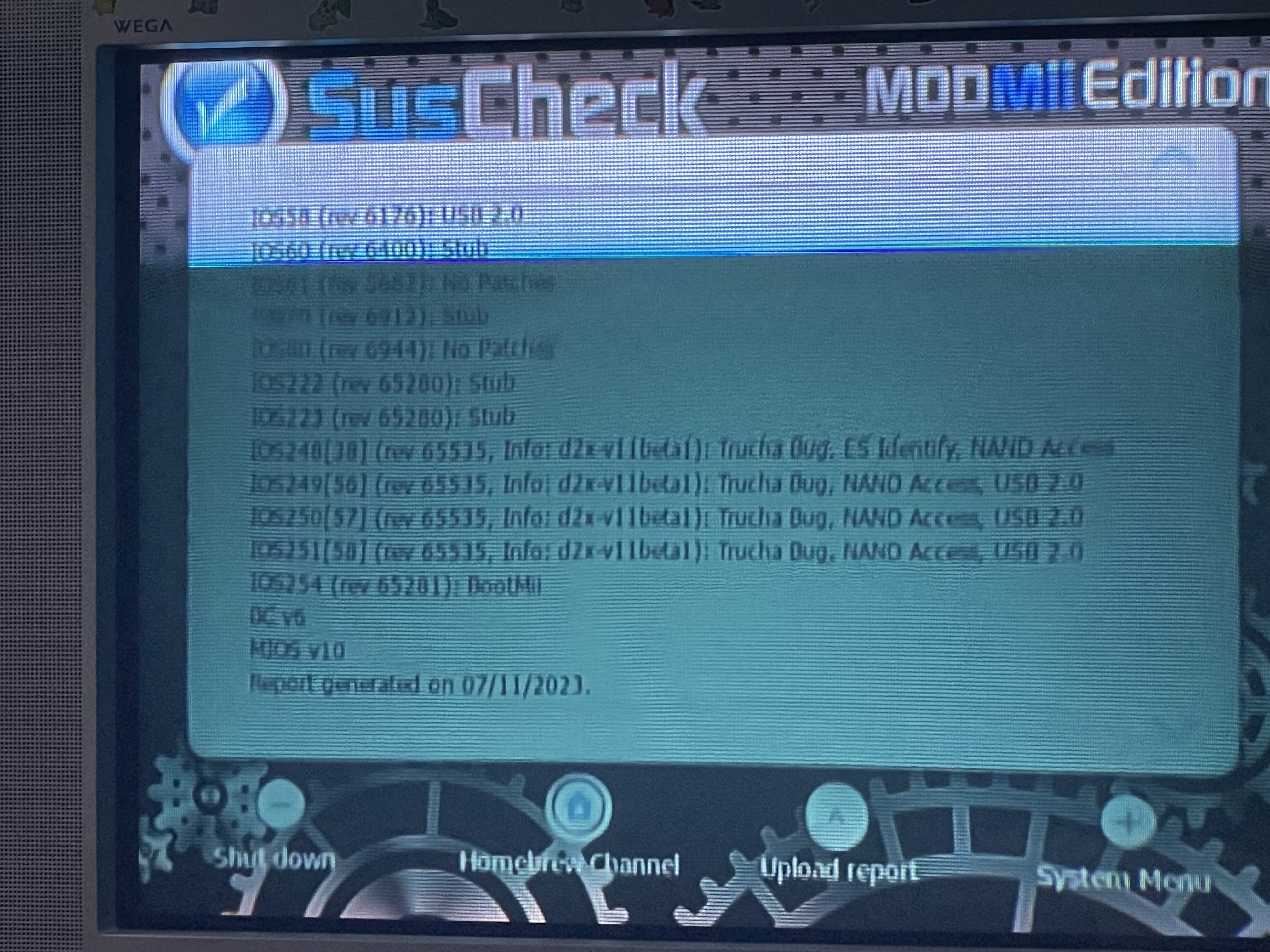

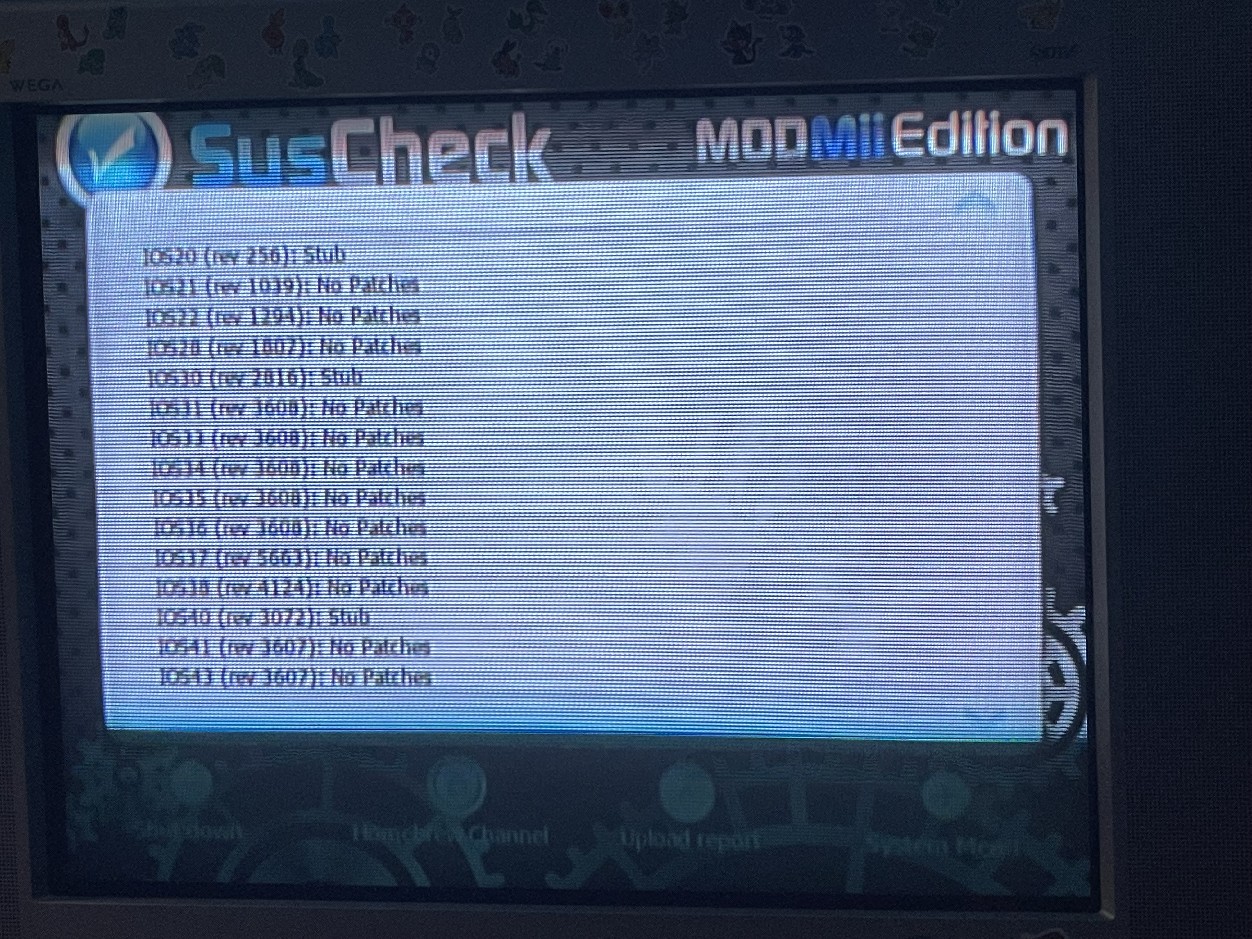

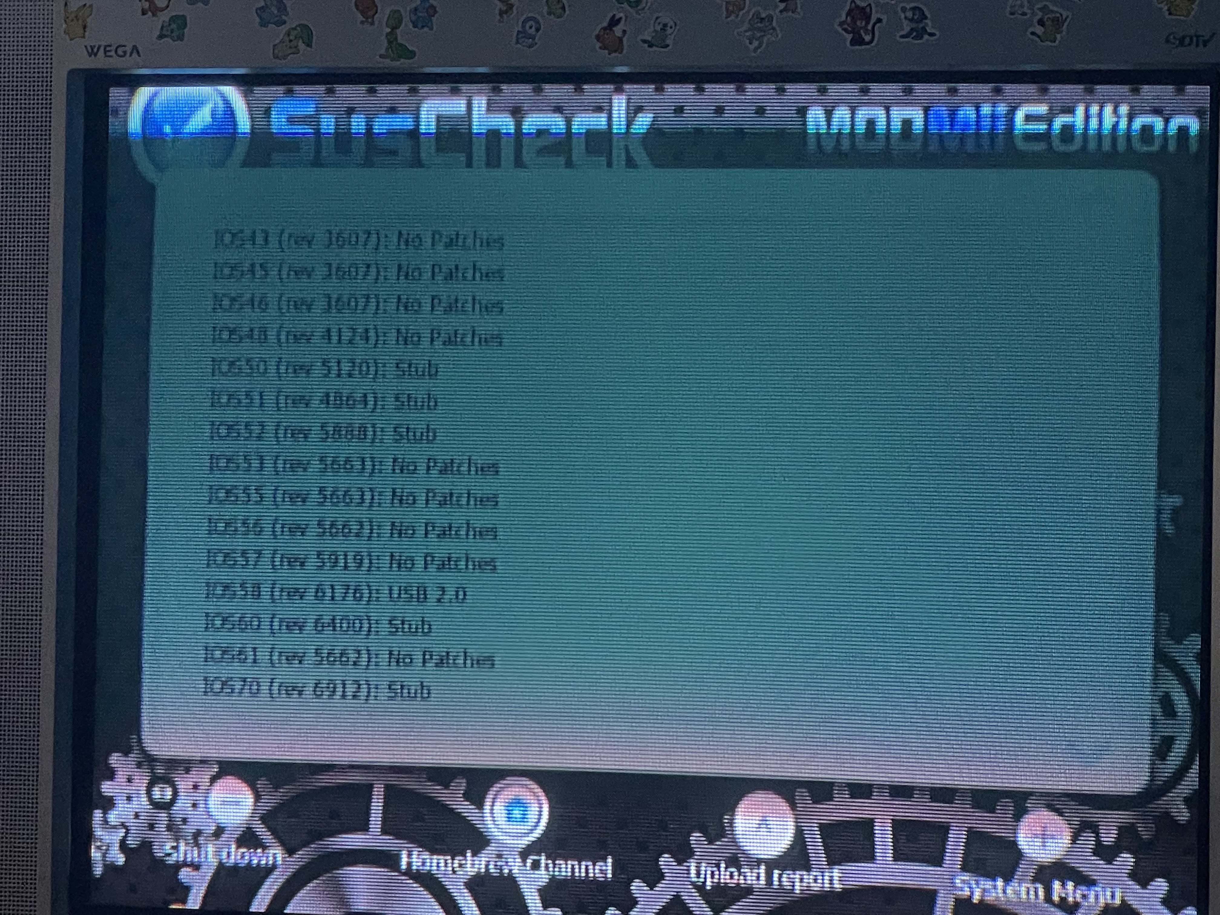

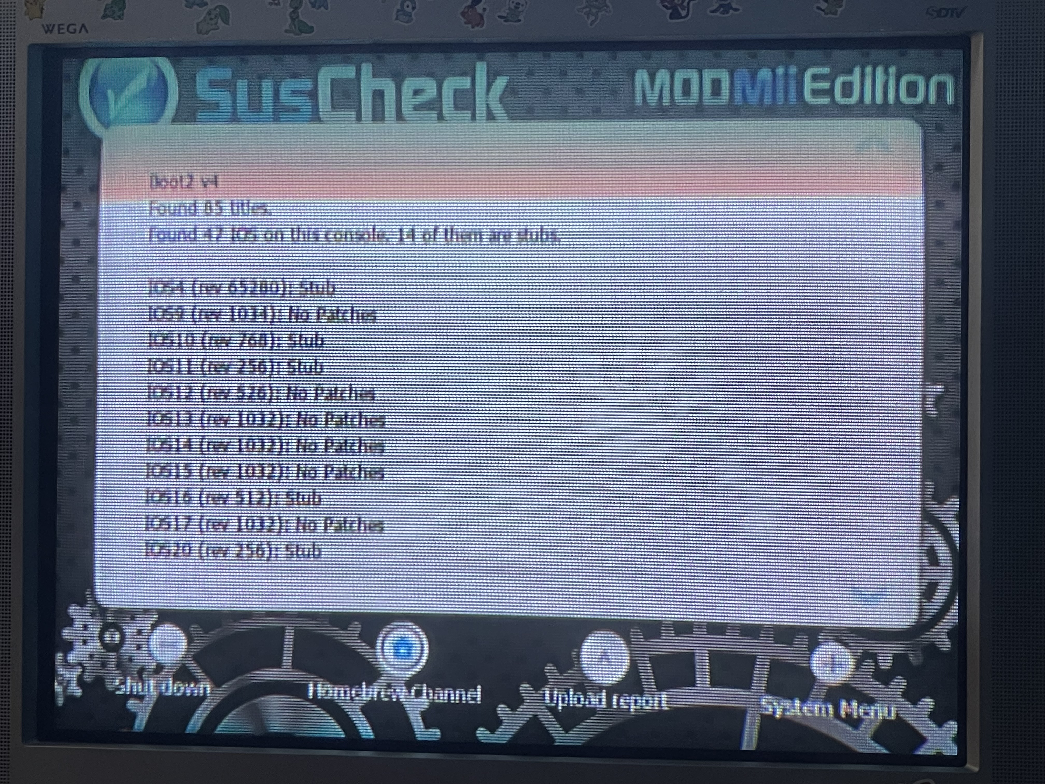

Install the latest cIOS:
I checked in there. I installed the wads an the iOS correctly if I’m not mistaken
your syscheck report is correct.
USB FAT32 support??
your games are placed correctly on support??
EDIT: @SylverReZ : the cios are correct, given the syscheck report

Since Nintendont uses IOS58 and that's not working the issue is likely with your USB storage device. So are you using a 120GB USB HDD or a 128GB USB flash drive?

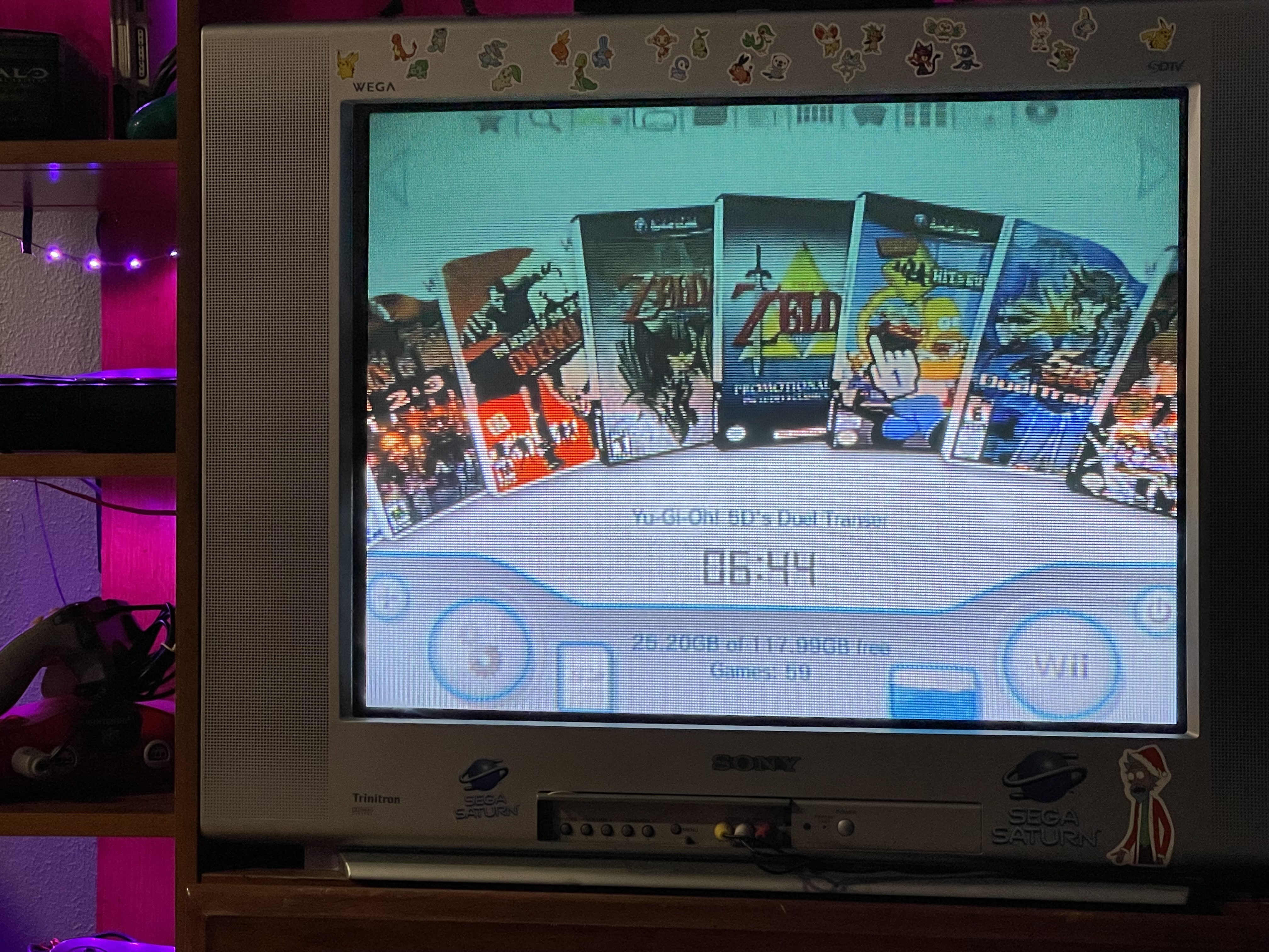

I thank you new thumb drive and all the wii games boot, just not the gc games. Big improvement. Any clue where to start to resolve GameCube games booting to a black screen and having to physically shut down the system to reboot.

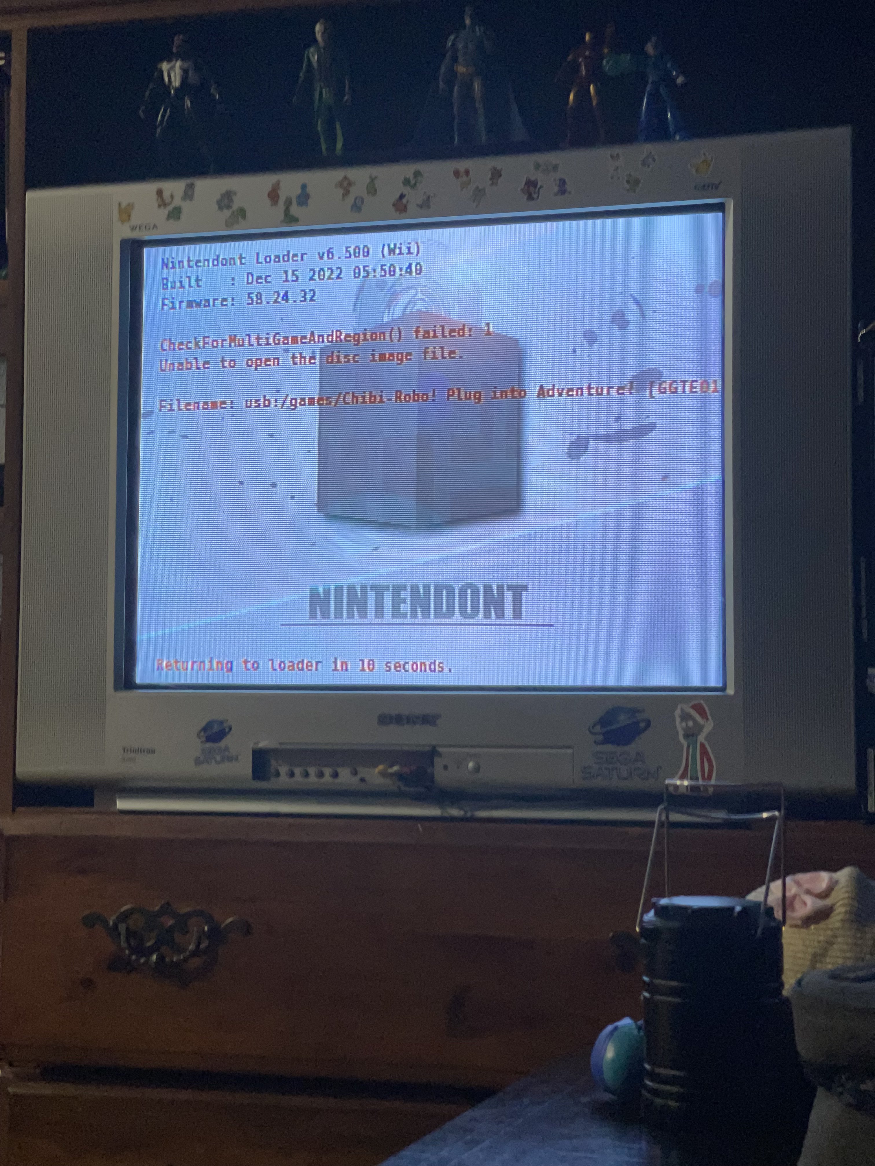

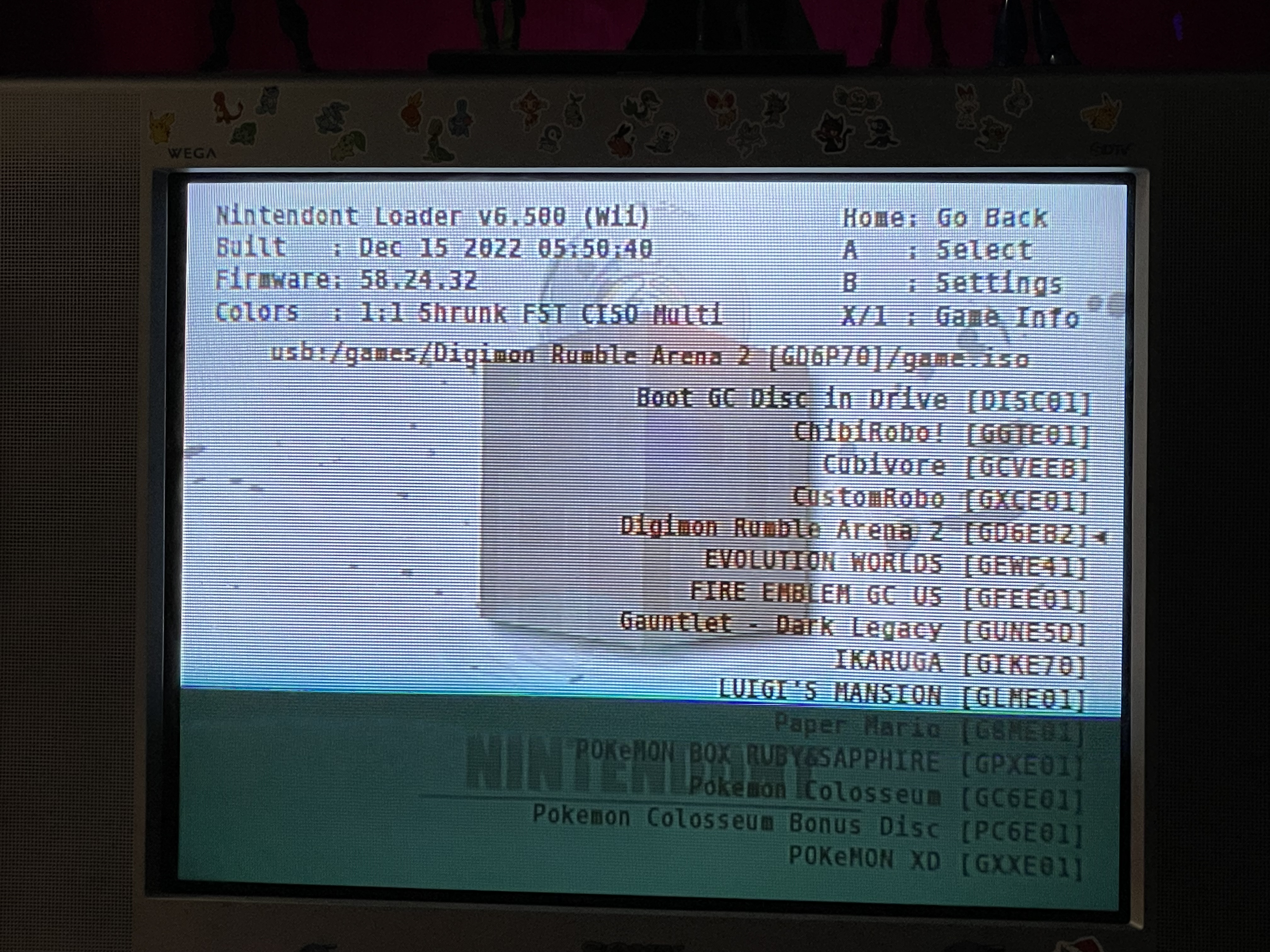

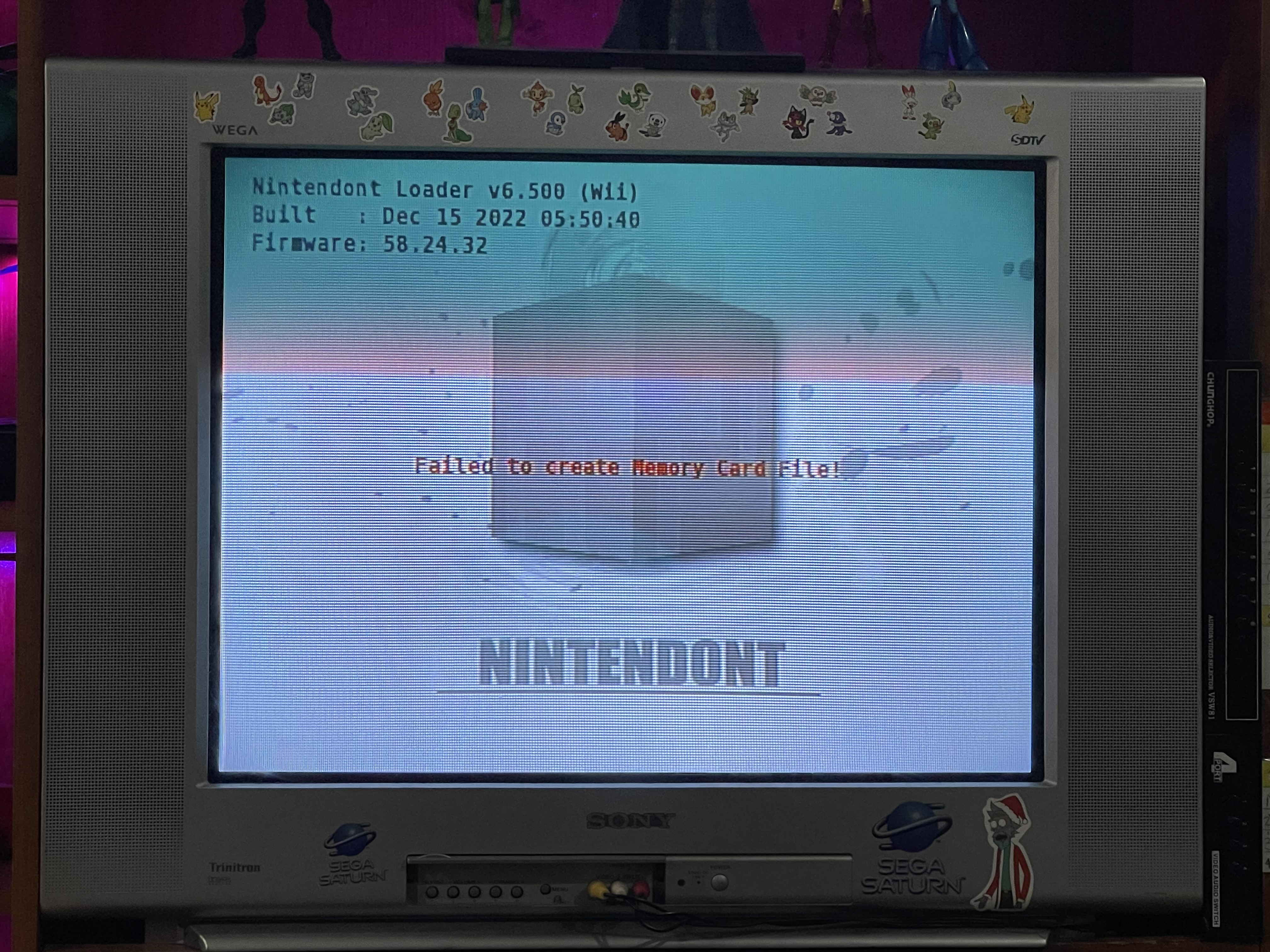

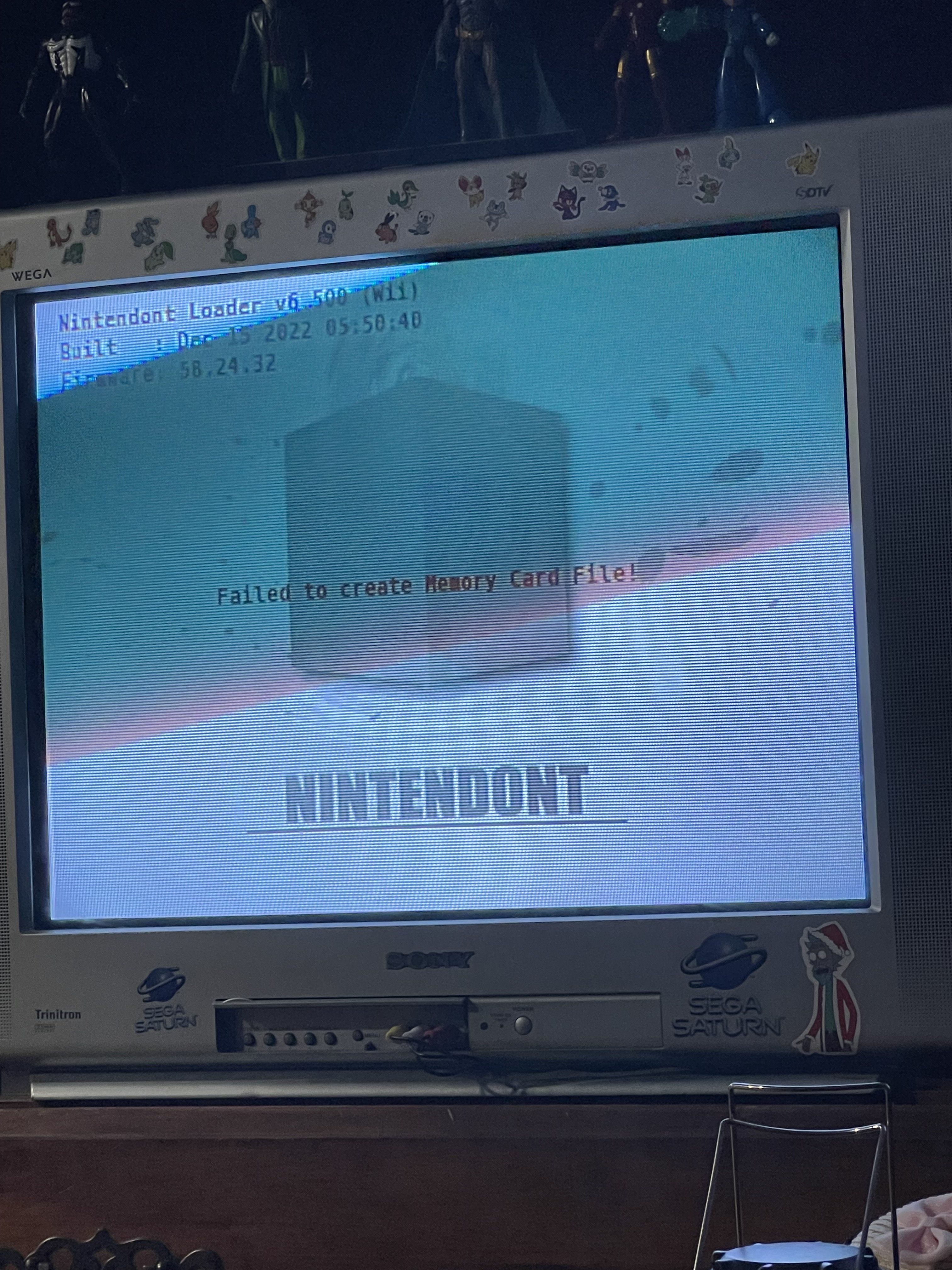

Yea I was pretty tedious in naming them all correctly attached is a photo of an error that showed on one attempt, but the emulating memory card is off in nintendont and I had two memory cards tested inserted
That's weird, as mc emulation shouldn't be an issue.. Also i don't get why it shows that when mc emulation's off.
I'd tag @pedro702 he'd know more.:)
Reactions: jeannotte
failled to creat memory card can be either the sd card is write protected, the lock on the side blocking it or there isnt enough space on the device.
In that case i'd suggest trying with a different sd card adapter (if he's using one), these things break easily, the lock slider gets twitchy or behaves as if it's locked even if it's in the unlocked position..

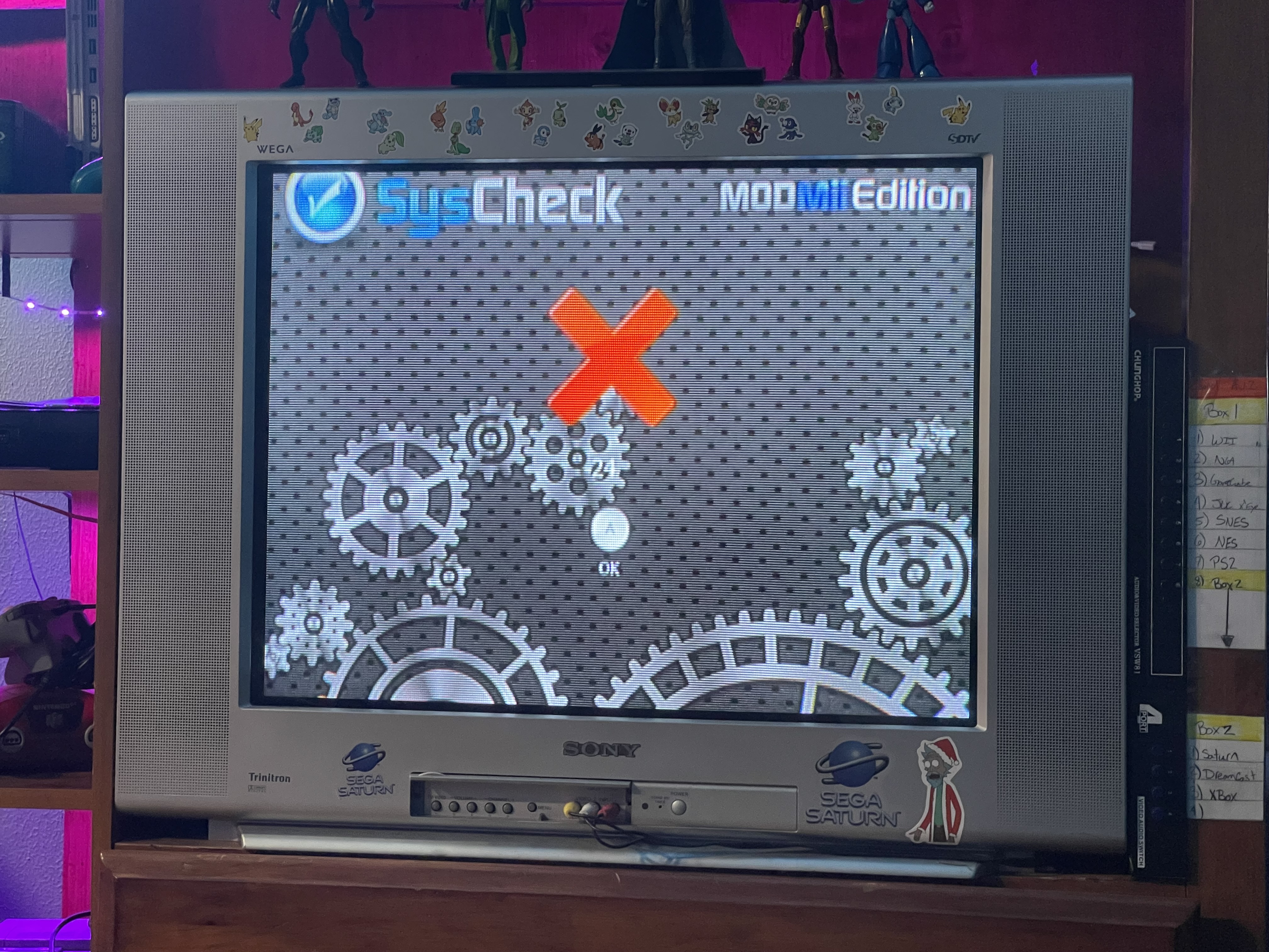

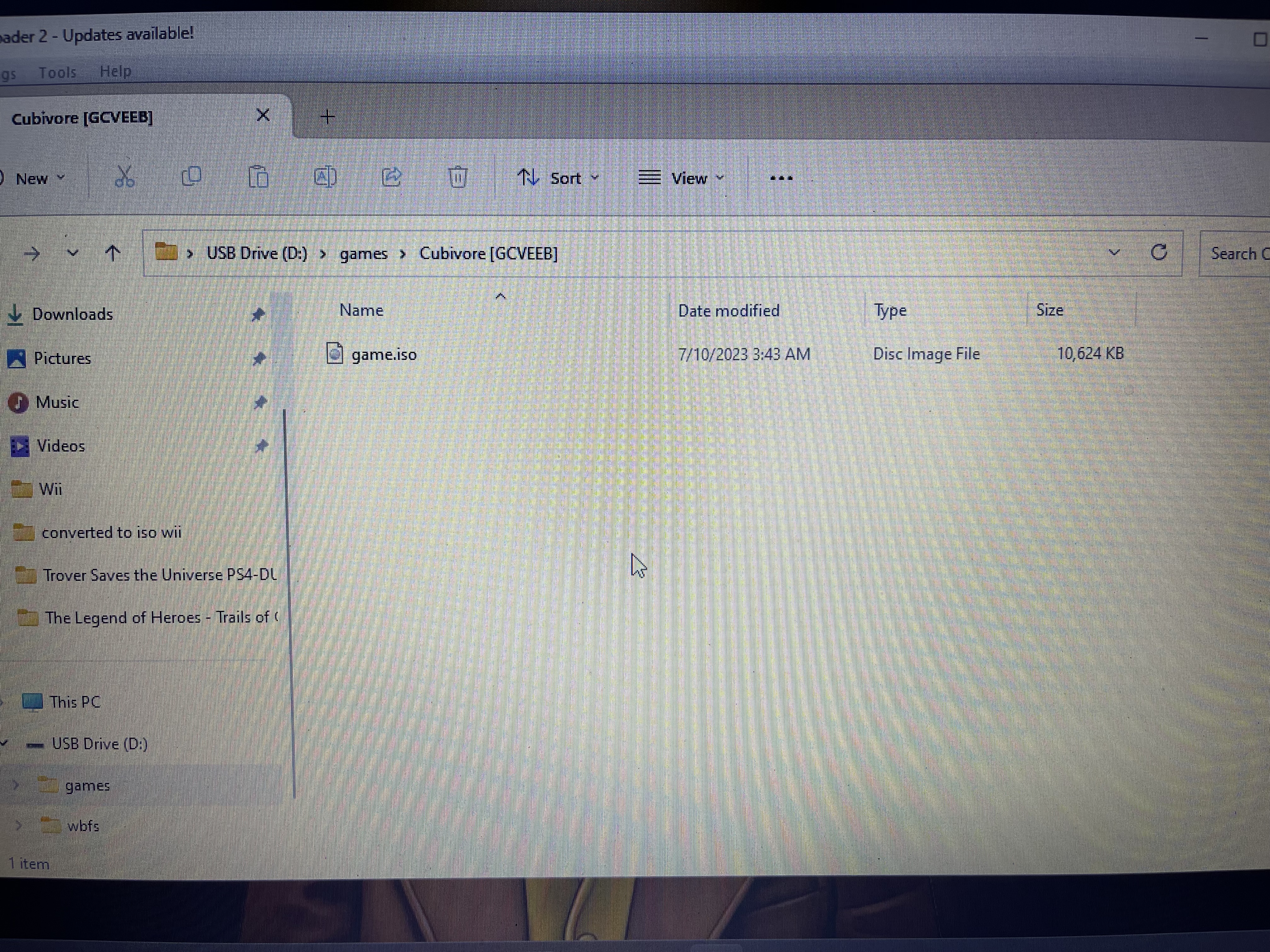

Here’s photos of an example of what I’m experiencing. Dumb question but my iso read as disc image file is it the same or do I need to convert to iso? See photo for what I’m referring to
you didnt followed any directions to a tee, to get best results in nintendont you shoudl always use full isos /1.35 gb) with the md5 matching redump your iso clearly isnt, but im guessing this is more of an usb issue, if the iso works from sd card that means nintendont doesnt like your usb device.

So I’m struggling. I tried redoing the hack. None of the gc games boot. 8 furthest they go is the open screen and freeze on spot. Select wii games booted like Mario Olympics, but others only give a black screen like dk country or house of the dead. I ran a syscheck but I’m struggling to figure out what to do with the info now that I ran one any advise.
Note my Wii was hacked by me back in 2018-2019 and I never touched it or put games on it then I dusted it off this week after successfully tricking out my ps3, and ps4 ….. stumped again though. I don’t wanna be heated by a wii that can’t even connect to modern Wi-Fi I should be superior 😅
