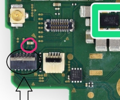

I bought broken switch from ebay some time ago and it was missing one capacitor near the microSD card socket connector. Would somebody be so kind to measure the capacitor (pink circle) from their own switch if possible.
Thank you really much!

0.68uF 0402 6.3 MLCC cap.
Smoothing capacitor. Value not too critical. Don`t go any lower than 0.68uF :)

Thank you very much ! You are a real hero! :)
