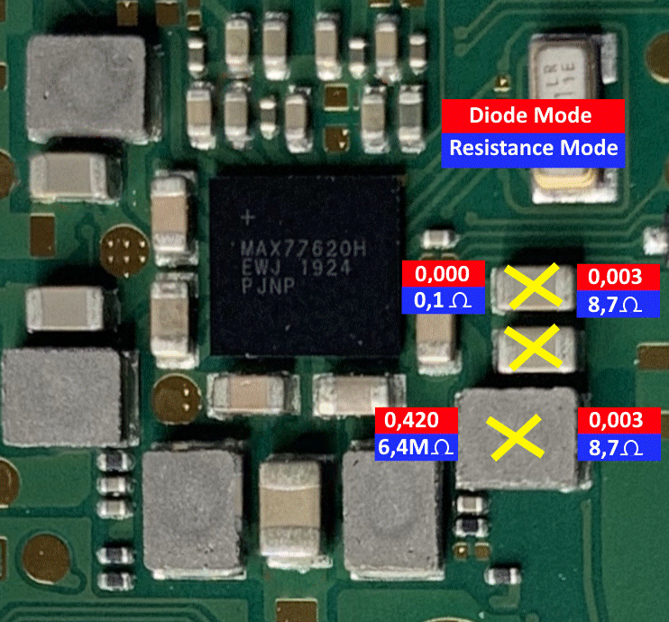

on my Switch the 1.1V from MAX77620 is missing.
I desoldered and tested the corresponding inductor and capacitors but they are ok.
Now measuring on the blank pads gives me these values:
Before i try to trace the whole voltage rail to find faulty parts:
which components getting the 1.1V?
Just the CPU or others too?
Thanks for your help!
