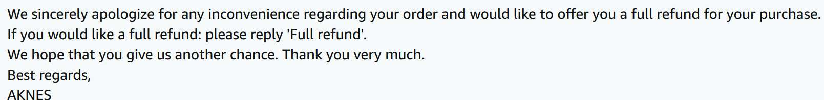

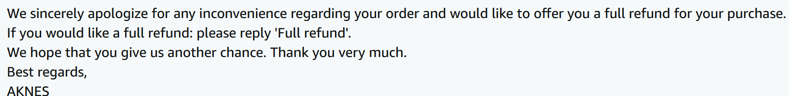

AKNES responded to my review offering a full refund:
AKNES responded to my review offering a full refund:View attachment 348735
Is cheaper for them give to you a full refund instead of assume the shipping costs.
Well, the truth is that works for booth of you: you get the defective items and if you like you can try to repair them; even if they get broken you have the money to buy a new pair.
