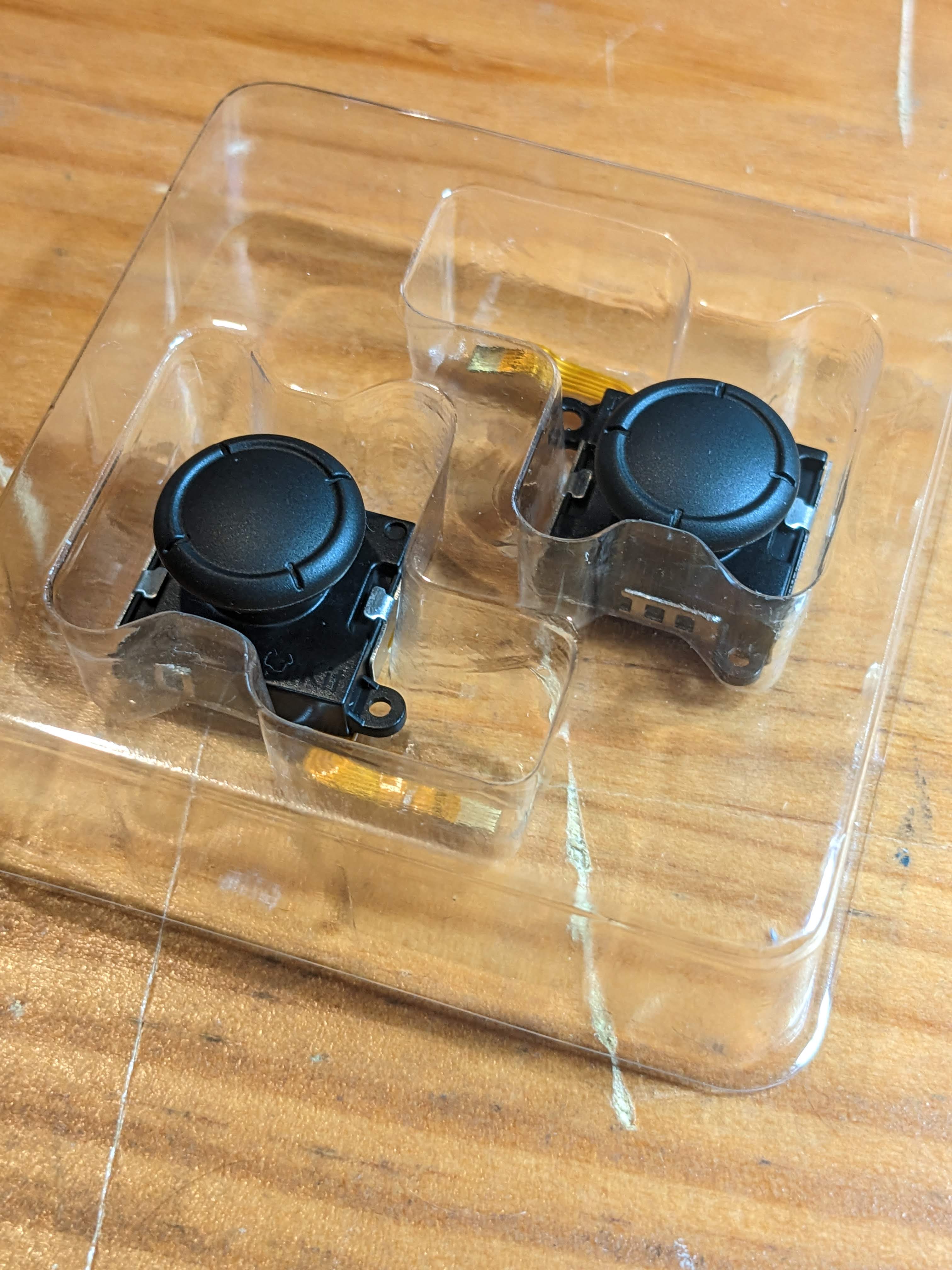

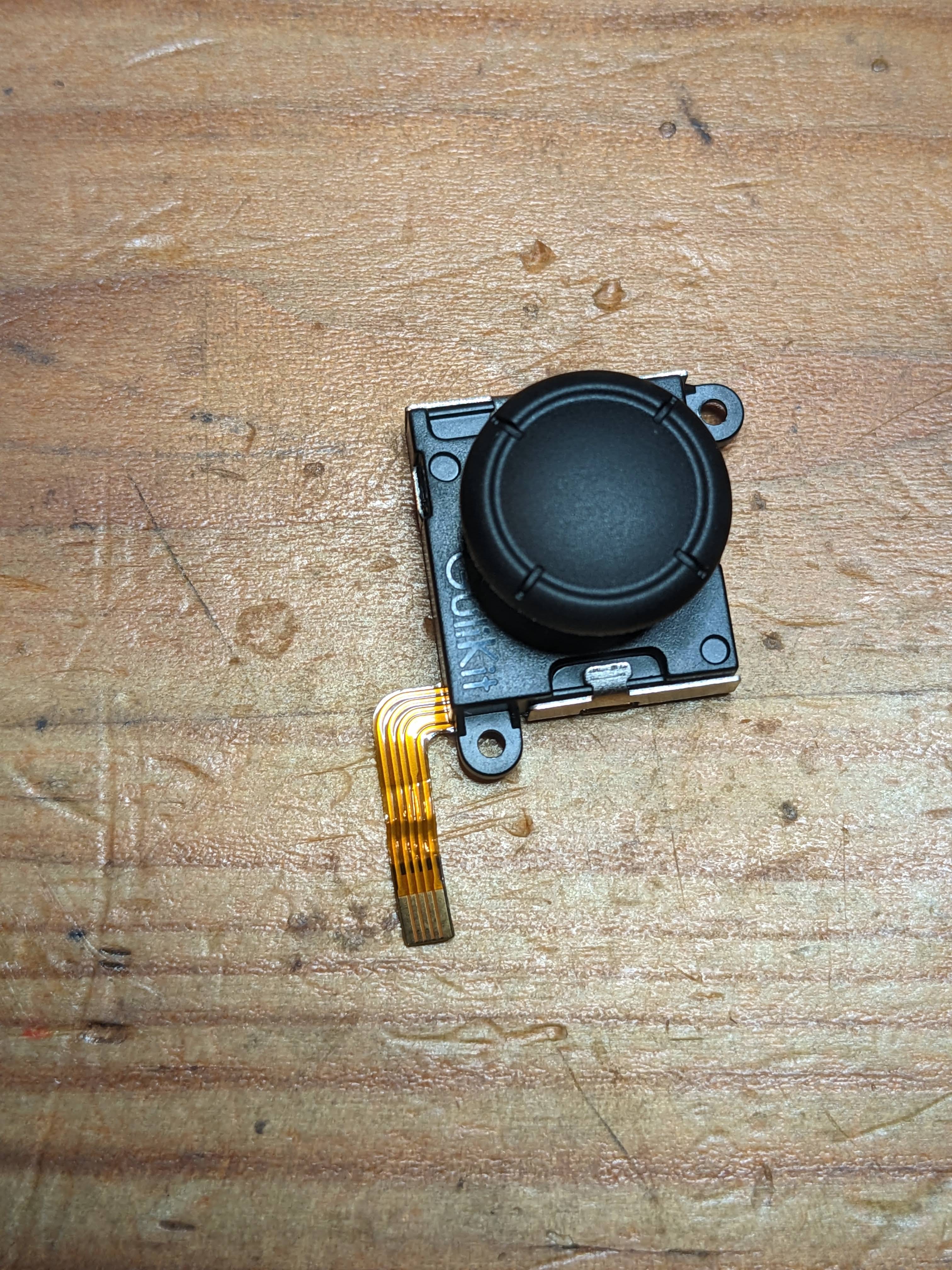

Here are the joysticks I received:

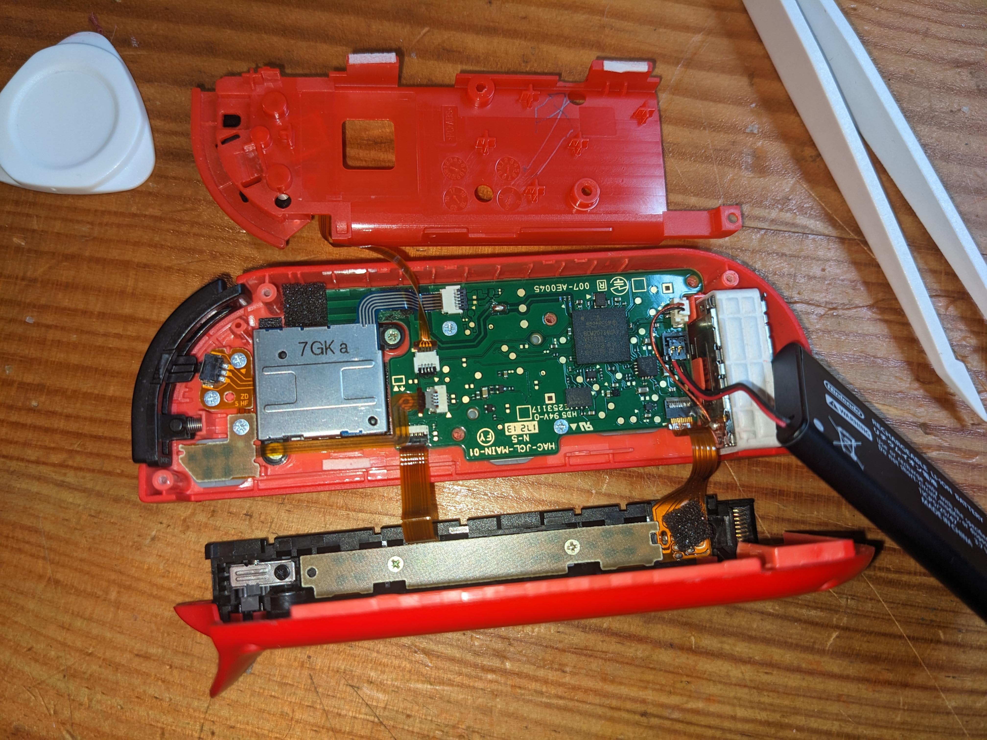

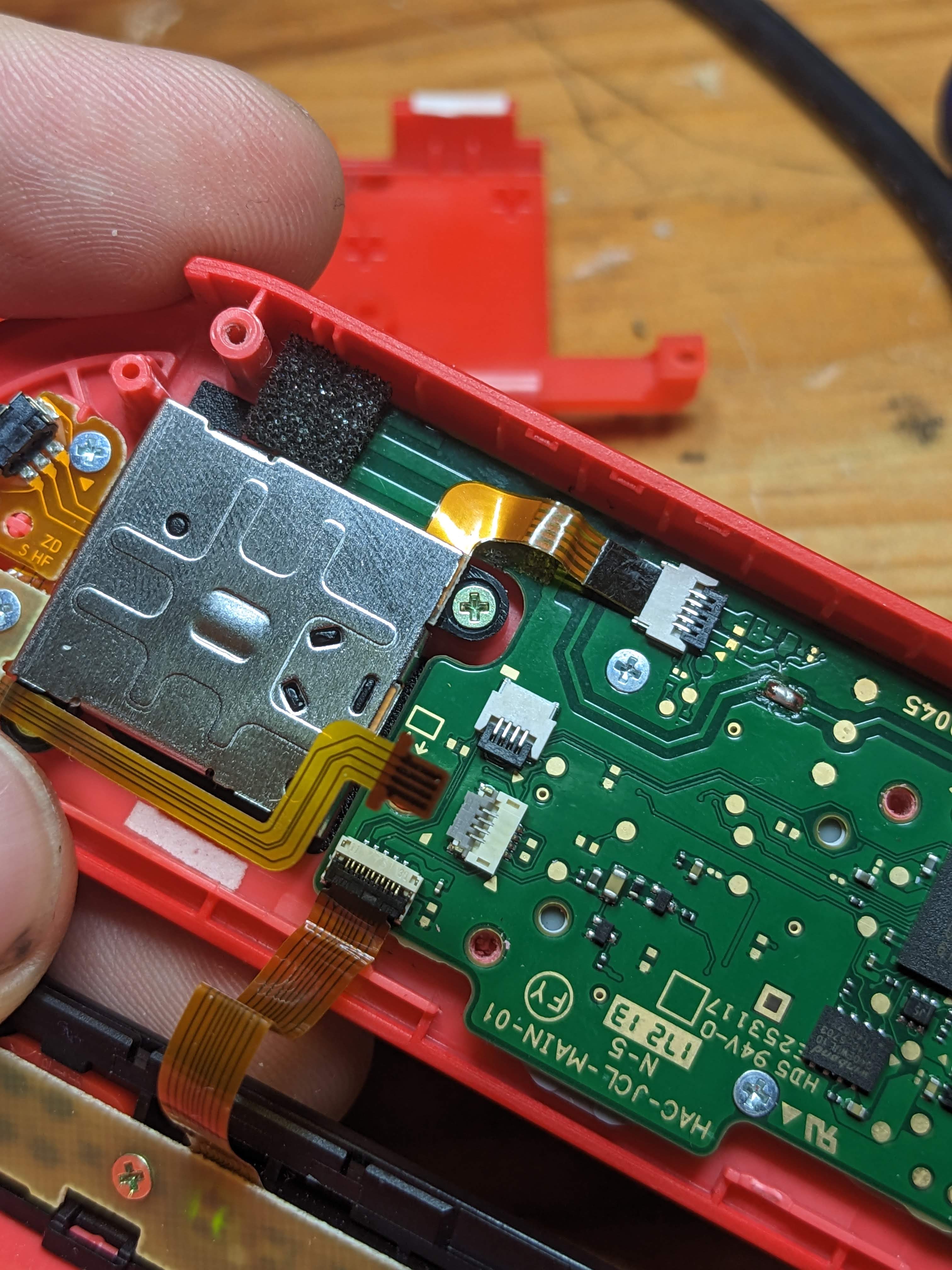

Here's the left joy-con dissembled:

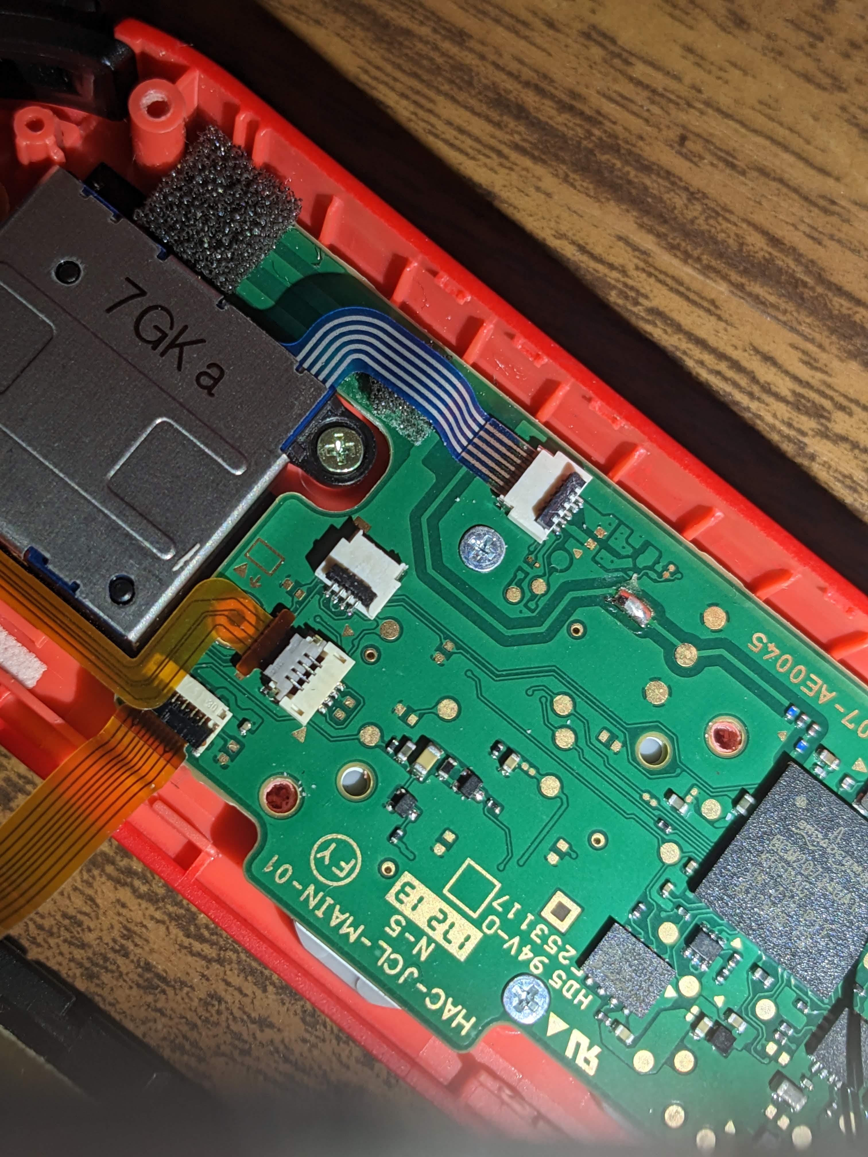

The Gulikit joystick in place, however it looks like the ribbon is a lot longer(?) than the original one:

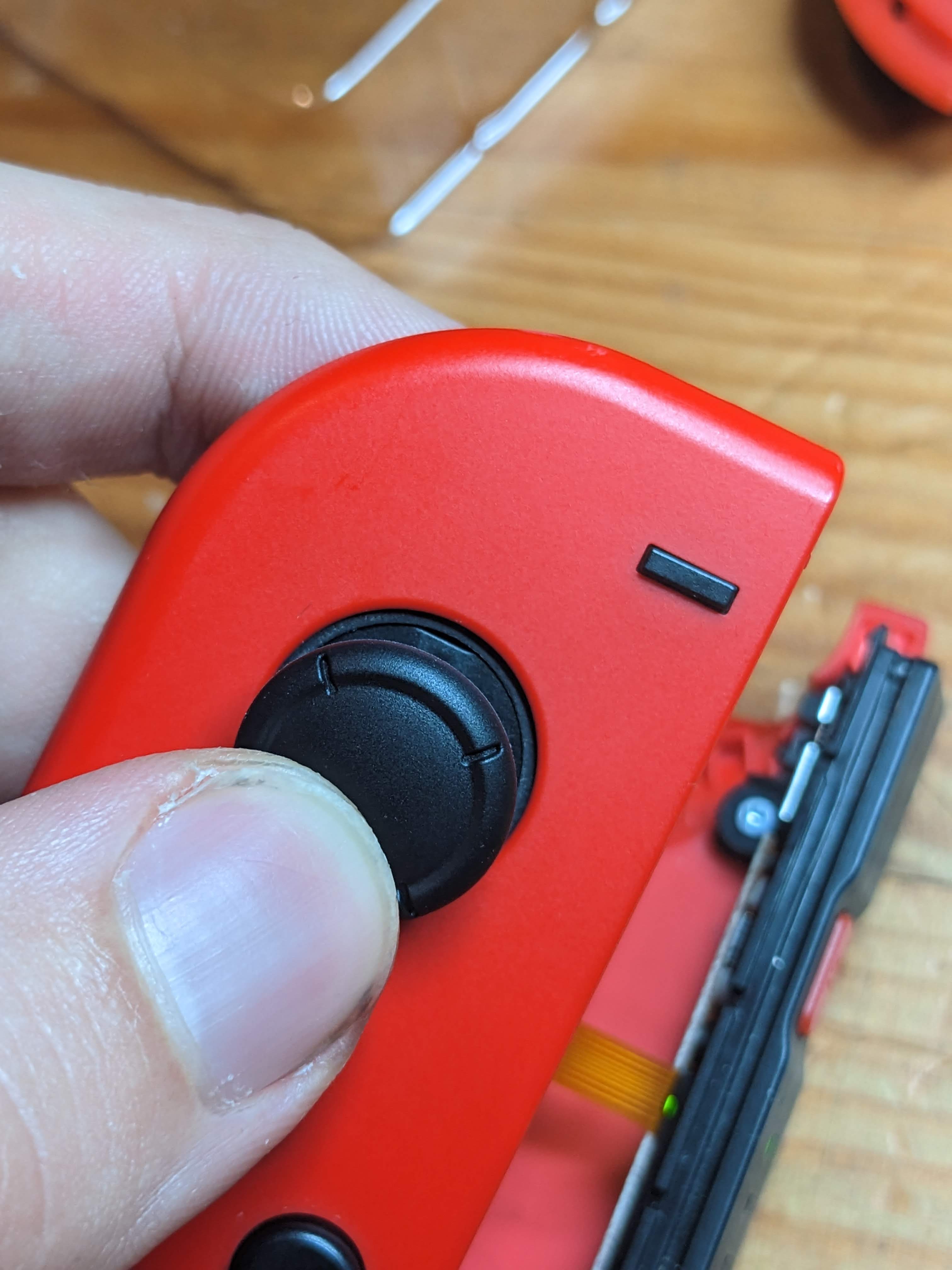

And when in installed there's a small gap on the other side:
Here's a video trying to exemplify what's happening, I only get this behaviour in the original joycon, if the connector "lock" isn't locked:
In the video there is a screw missing on the joycon because now I couldn't even use it stably with both screws.

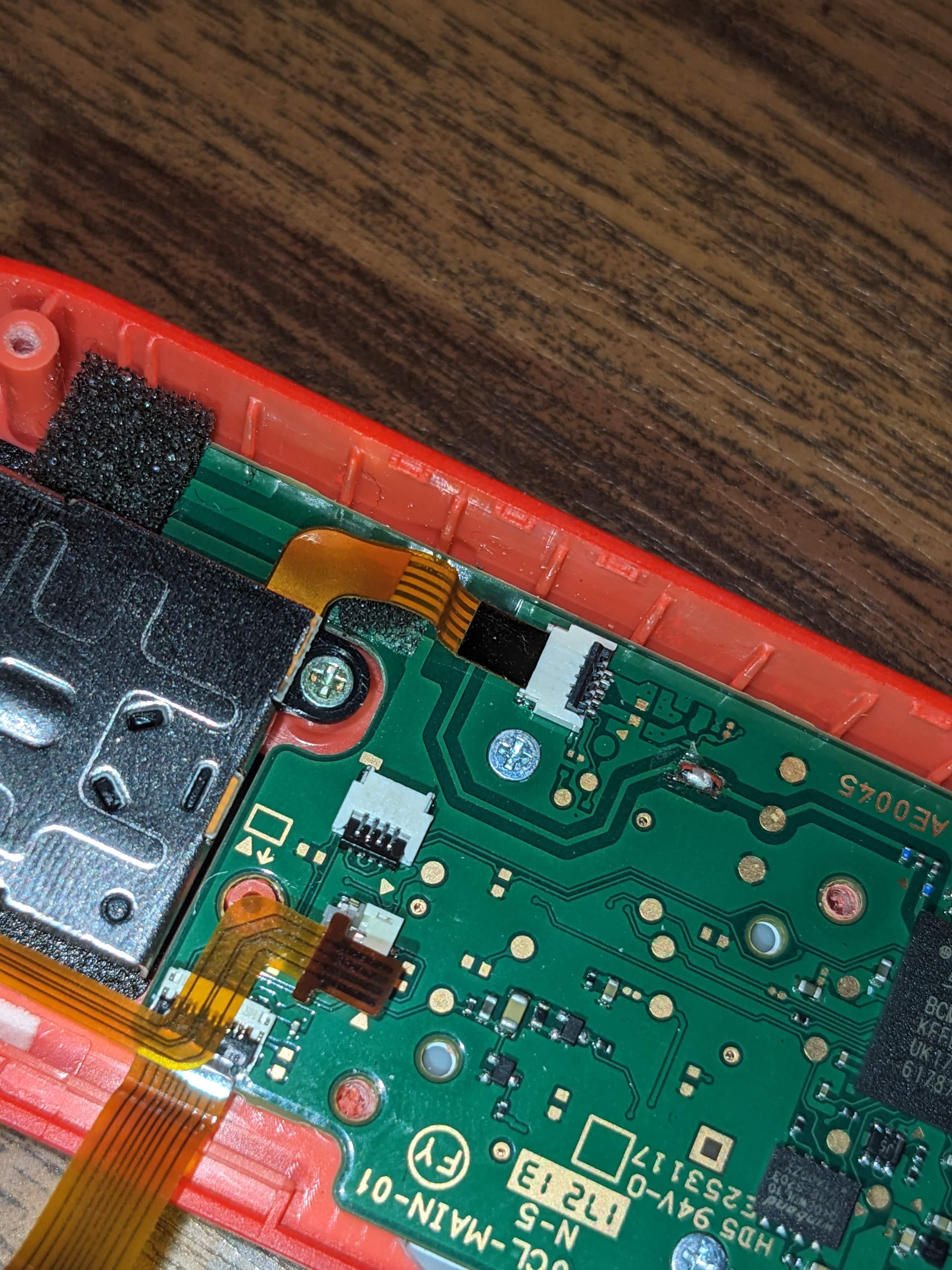

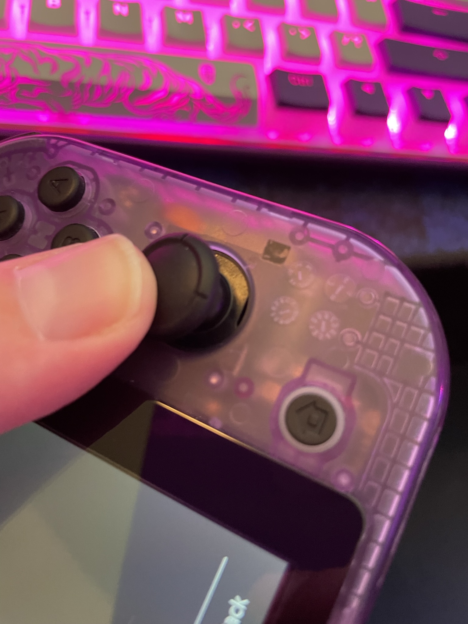

I have the gaps as well on a Switch Lite. The joystick doesn’t extend all the way to the gaskets.

It's no problem of space seems your connector have a bent pin and stops the ribbon to fully enter, try the original sticks and compare how much enters.
I was thinking something similar, it doesn't look fully inserted. Can you show a picture with the lock tab flipped up and the ribbon fully inserted?
Am I the only unlucky person that may have gotten a defective unit? Ordered mine on amazon es from Aknes-EU. Replaced both joysticks and the ribbon cable doesn't appear to fully connect with the joystick board on both sides. If I go to the test page while the controller is "dissambled" if I touch the ribbon, the joystick starts "drifting" to the top-left, same behaviour as if it were disconnected.
Has anyone else experienced this?

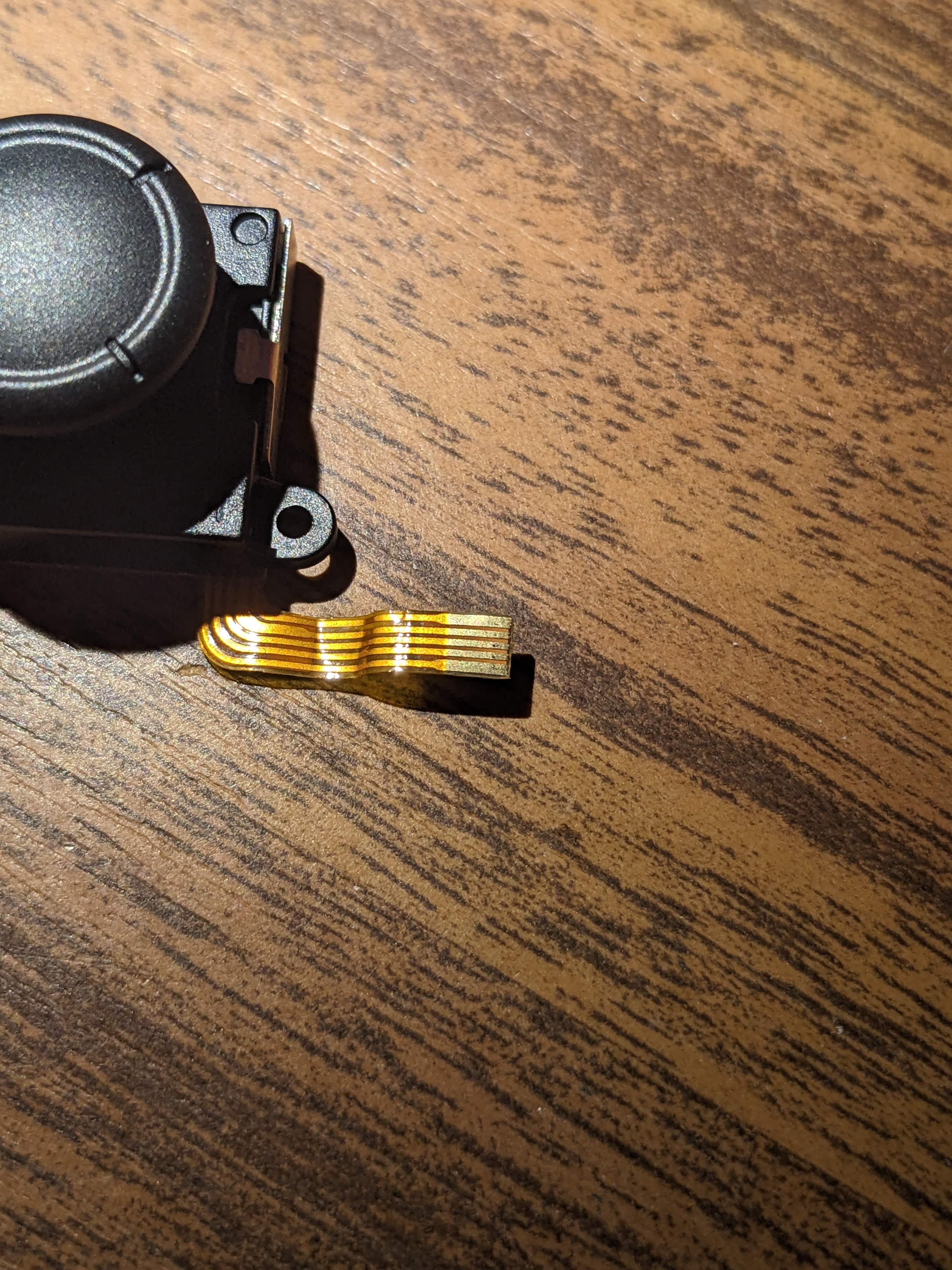

They enter the connector about the same amount, the protective layer(black/transparent thingy) on the gulikit measures ~4.66mm while the original one is ~4.35mm, but if I check the contacts you can see the marks of the pins making contact.
Original:
Gulikit:
Original:
Gulikit:

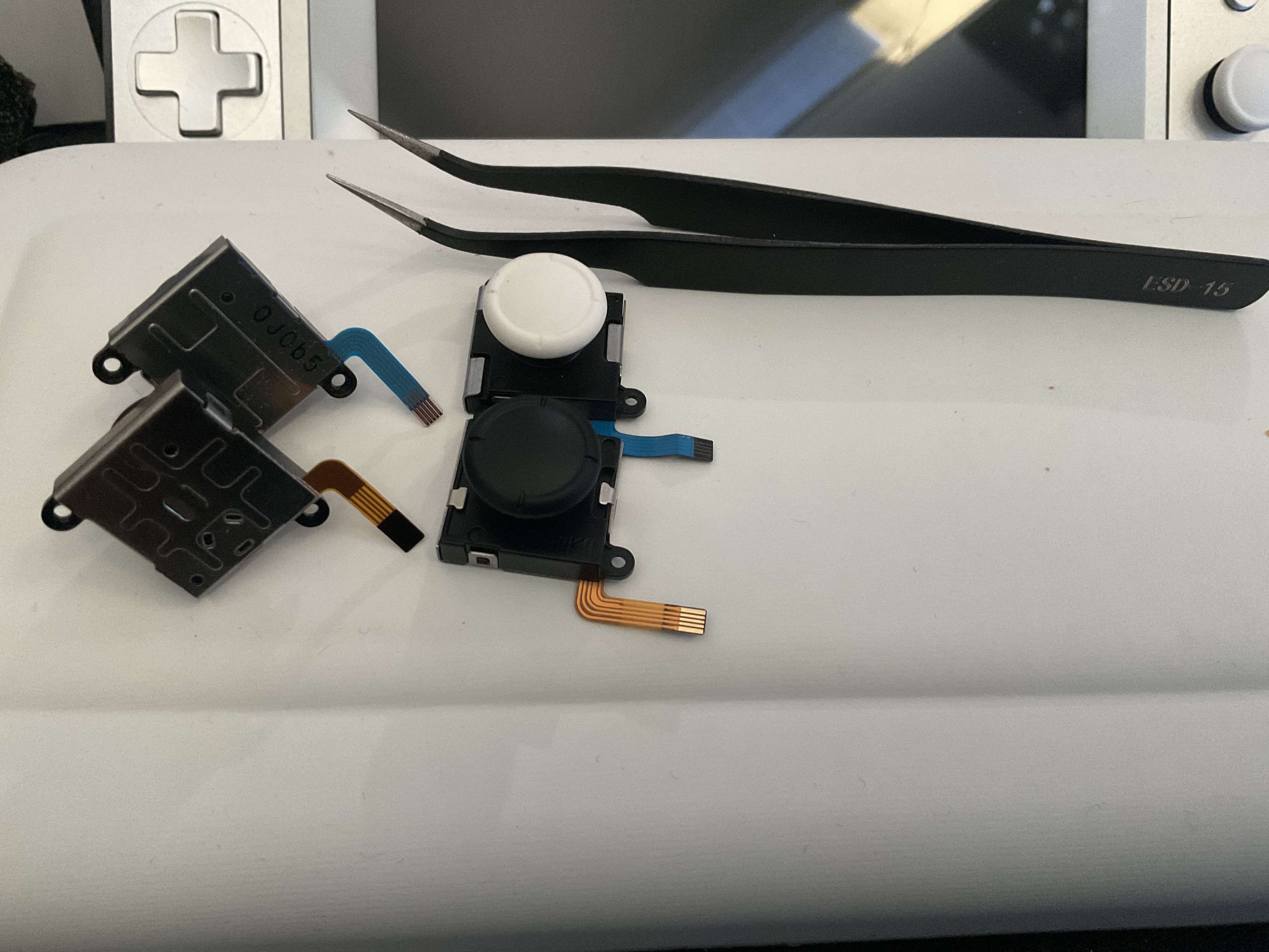

I gotta say, those look identical to mine.
Here are mine, stock in the back, gulikit in the front.
I would get a pair of bent tweezers and see if you can get them to seat better.

So I have had mine installed for a couple of days now. Yes there is a slight gap on each joycon though barley visable. Also, they do click but is only noticeable when trying to listen for it and not noticeable at all when playing a game.
Functionally, I am very happy with them and like the stiffer spring joystick response but for the cost they are too expensive. For the cost you would expect better build tolerances.
