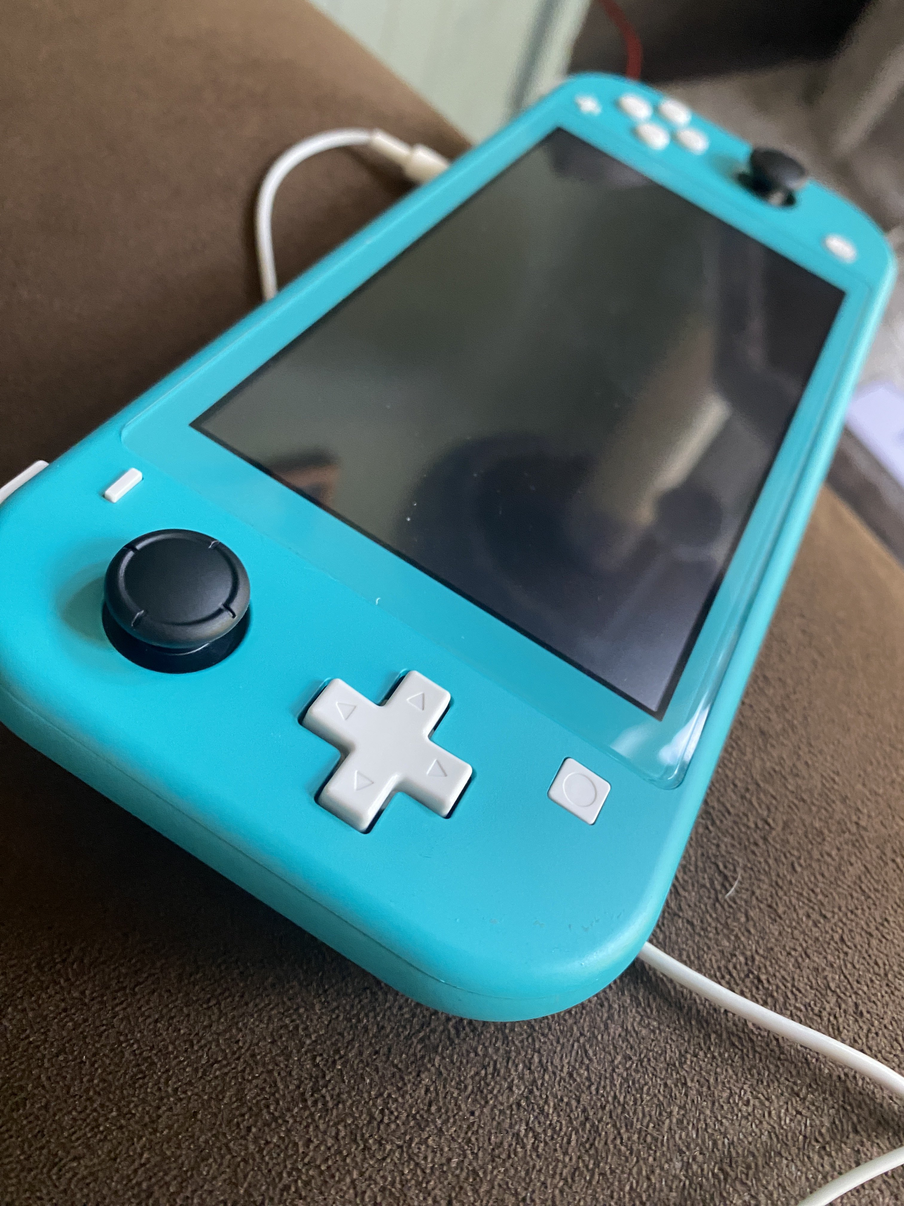

Got them in our switch lite. I stripped and reapplied thermal paste to the heat sink since I was in the neighborhood.
Had to calibrate the sticks. That was easy. No issues to report.
