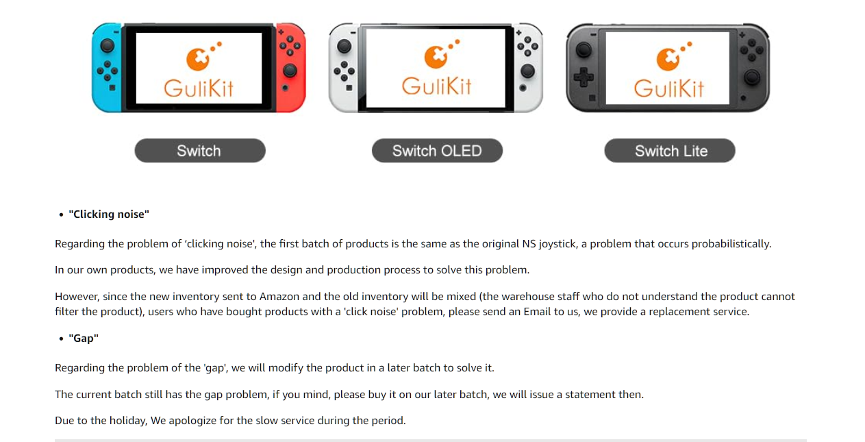

The problem is no "Clicking" the stick, clicking the stick works fine, the problem is what when you are moving the stick on a direction the slider "jumps" making a clicking sound and sending bad data to console
from Amazon official store:
That's even worse. But according to your screenshot the issue is addressed and I would be able to get a replacement later on. Thanks for you help. You too, @Lamcza :)
Reactions: Lamcza
Might be addressed, might not. No one has confirmed getting the revision yet, and buying them is a roulette - you're either getting the original ones that do this or the new revision that might not do this, there's no way to find out until you get them.
Might be addressed, might not. No one has confirmed getting the revision yet, and buying them is a roulette - you're either getting the original ones that do this or the new revision that might not do this.
even the manufacturer tells: if the problems are a dealbreaker for you, please wait until the original and new batch are gone, or if you receive a defective unit call us
Reactions: binkinator
by the way this is the URL on Amazon:

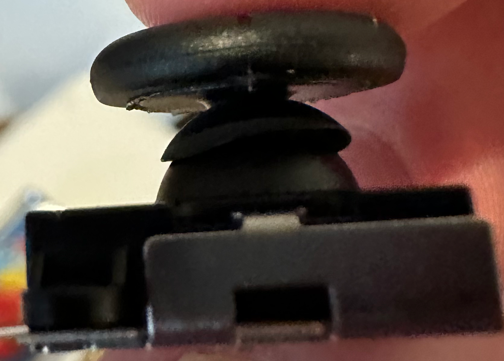

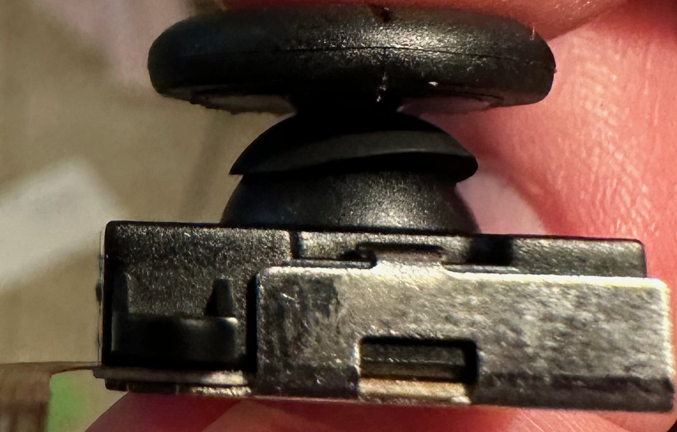

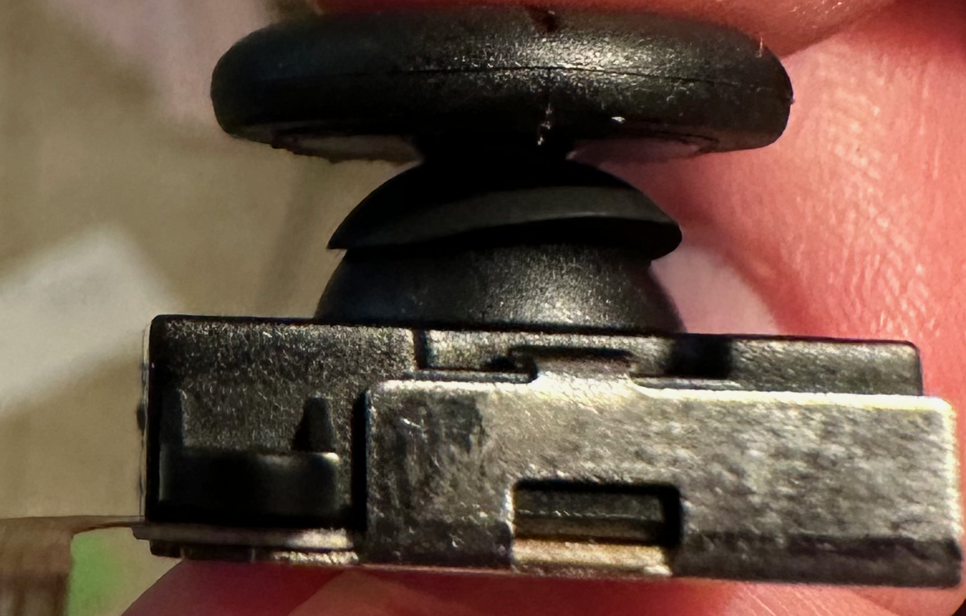

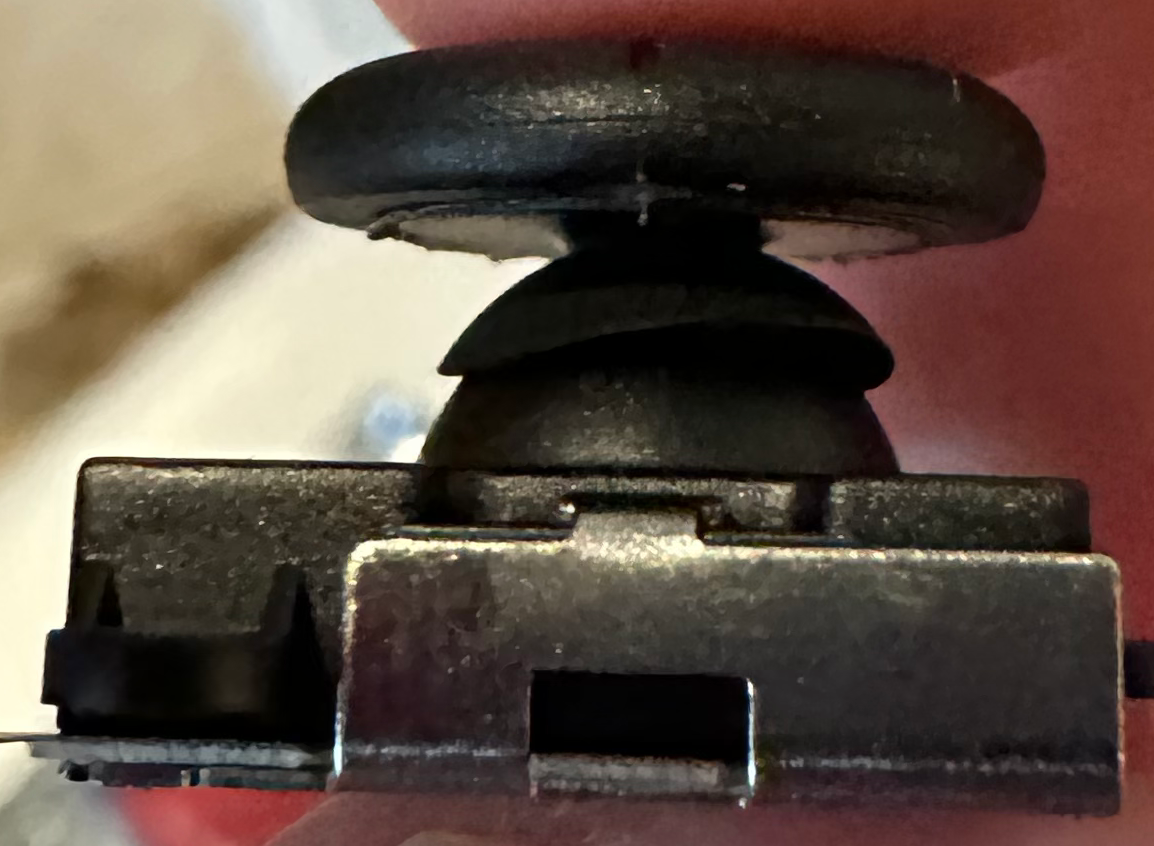

Ok, I got them in today. They sent me a single set of 4 with all the "accessories".
There does not appear to be a clear way to distinguish them from the originals, there's no difference in the packaging anywhere.
They do still have a light clicking sound in one direction, albeit quieter, and feel pretty similar to the original ones with a less pronounced or more difficult to detect "bump" in that same direction and are still quite stiff.
The little domes that sit on top of the main mechanism also seem warped / bent.
I most likely will not have time to install them today, I am moving snakes. 4 isn't quite enough I feel comfortable disassembling one, either.
View attachment 353109View attachment 353110View attachment 353111View attachment 353112View attachment 353113View attachment 353114
I thought the little domes were supposed to be flipped up so the big part of the open circle touches the bottom of the cap and then the cup extends down and meshes with the bottom part...making everything clean underneath. Will take a picture when I get a chance.

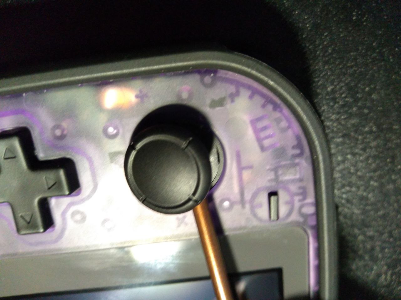

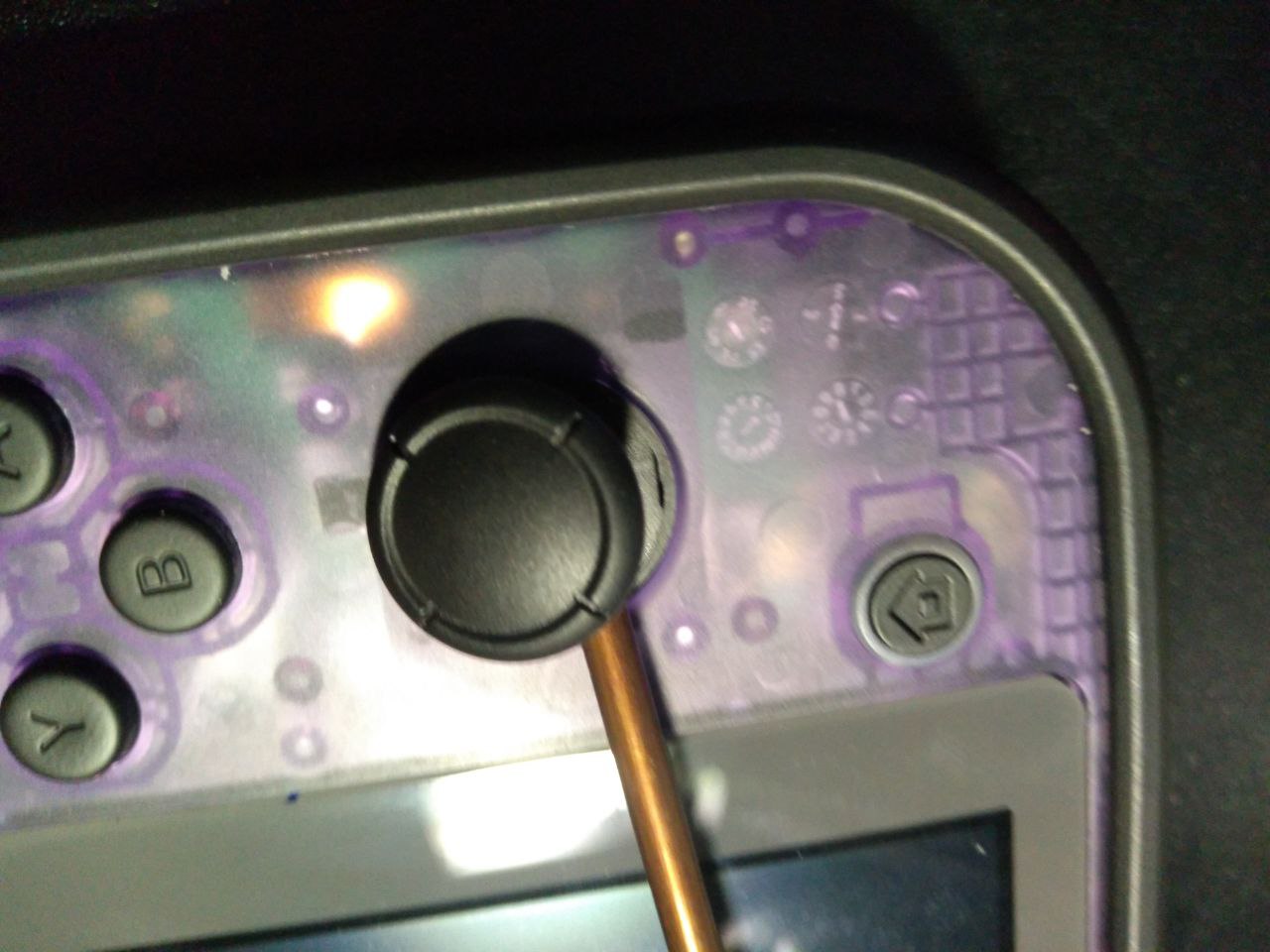

No problem. Just to add, almost forgot about it, there's still visible gaps between the shell and the joystick.
View attachment 353230View attachment 353231
Yeah they stated explicitly they weren't fixing this in the current version, but may later.
There should not be. There is a thin black plastic piece on the JoyCon shell itself surrounding the stick that is supposed to cover the internals and protect them from dust. Maybe you didn't move this piece over when you did the shell swap? ;)
I did, and also placed it carefully using the small marks on the shell.
