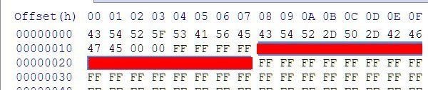

Sigh, that didn't work either. I must be doing something wrong, but I don't see what. I do have the .bin file for my private header.
When you open up a new save from the rom you just injected the private header to, should the private header show up in the .sav? If so, where?

Yes. It should look like this:
The red line is your private header

I got it to work! Thanks so much kb, it was a bit of trial and error. Must of been something I did wrong at first, but last night I was absolutely exhausted from a long day, my brain was working wrong haha.
