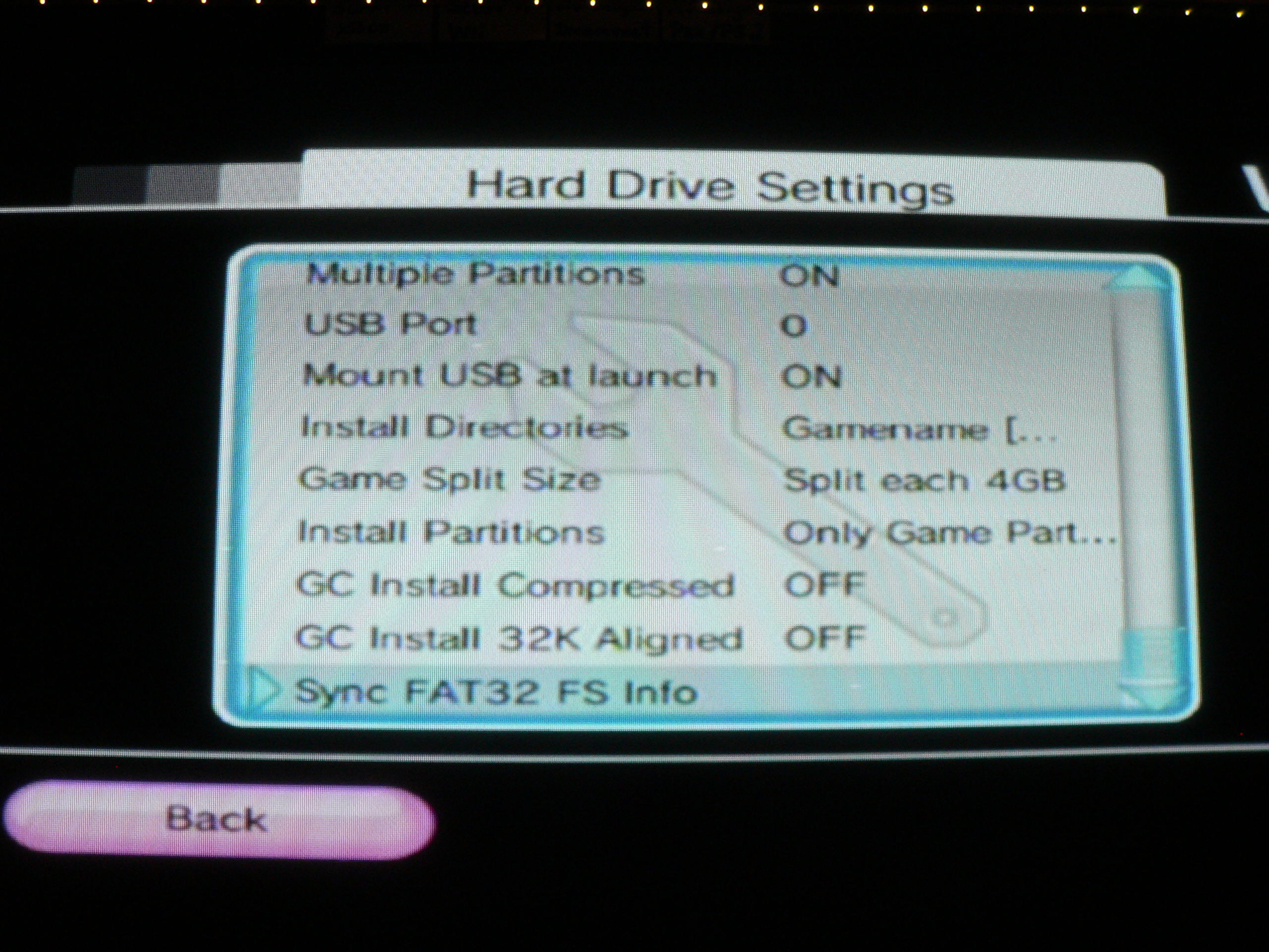

Hello.:)

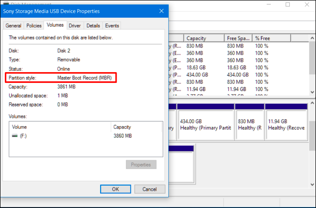

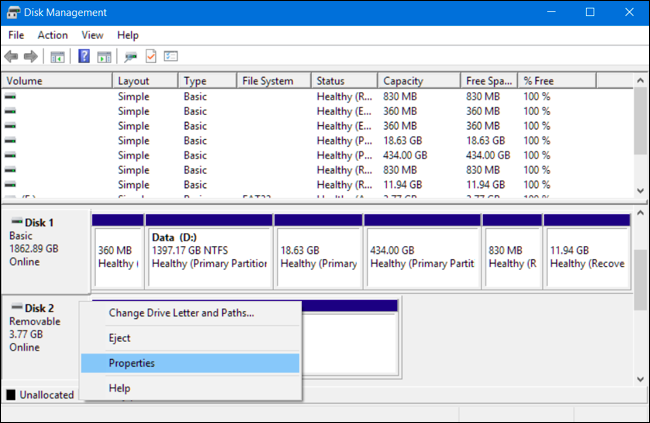

Please be sure your SSD is initialized as MBR Drive:
img_56e628d28bd5b.png.pagespeed.ce.QTfQCBsn-5.png img_56e6297886fee.png.pagespeed.ce.OAzLplkJBg.png
Did your SSD Case have an Power Supply ?
Maybe it needs more Time to Initalize.:(

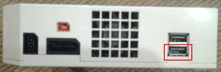

If if has no Power Supply,you can try to Power on the Wii with the attached SSD.
Boot into the Homebrew Channel or Wii Menu please.
Wait 20-30 Seconds and then try USBLoader GX.

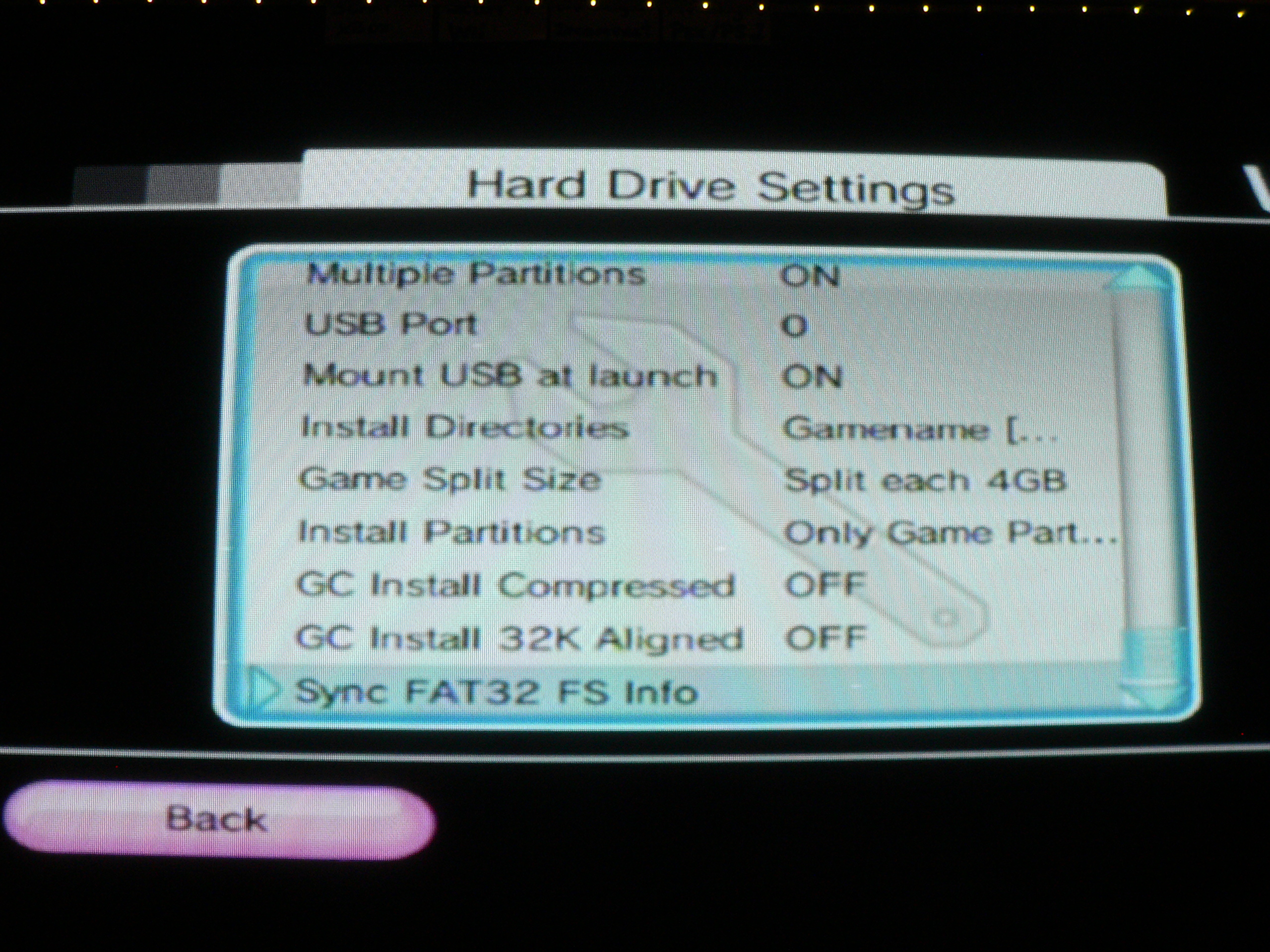

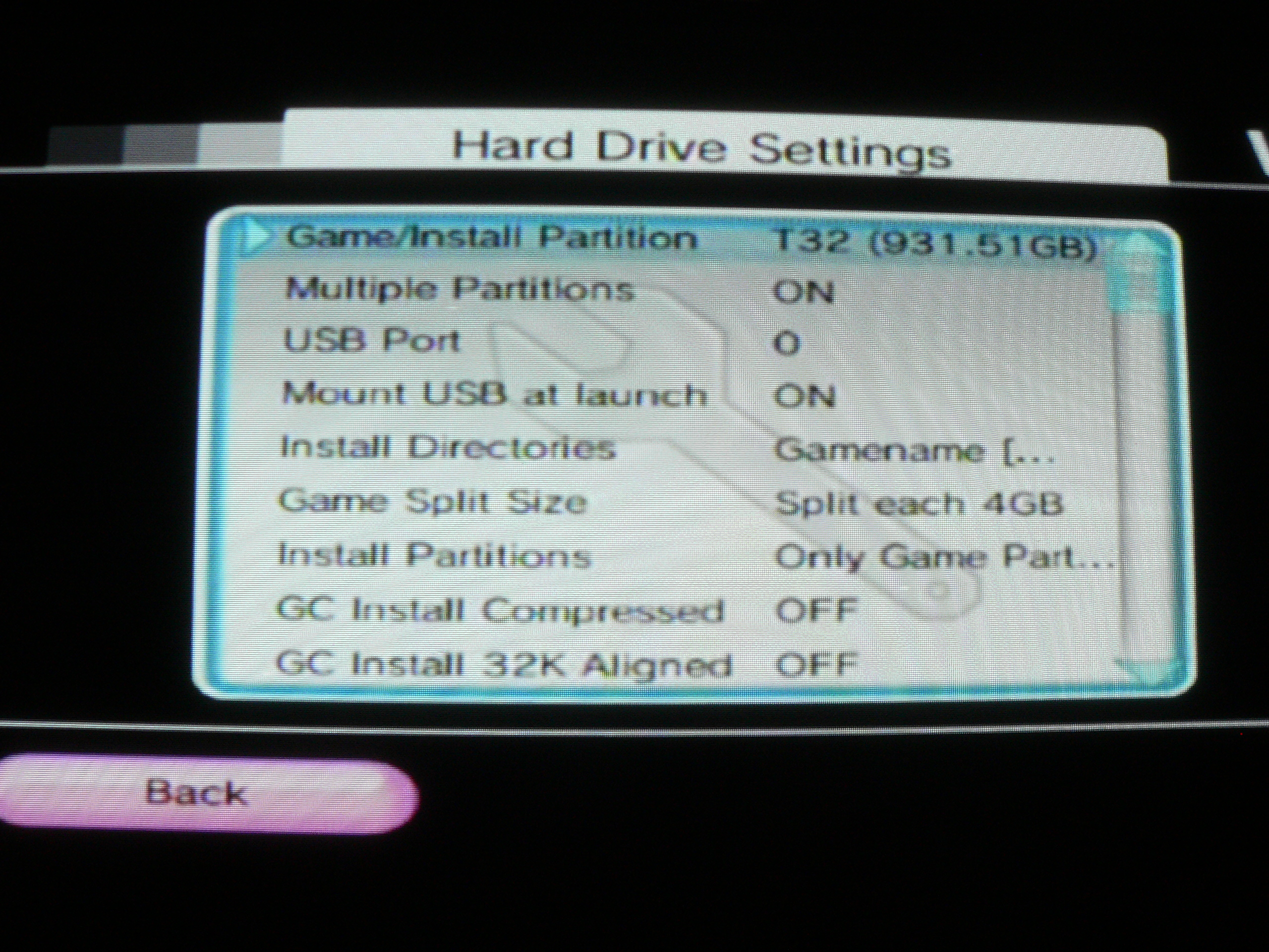

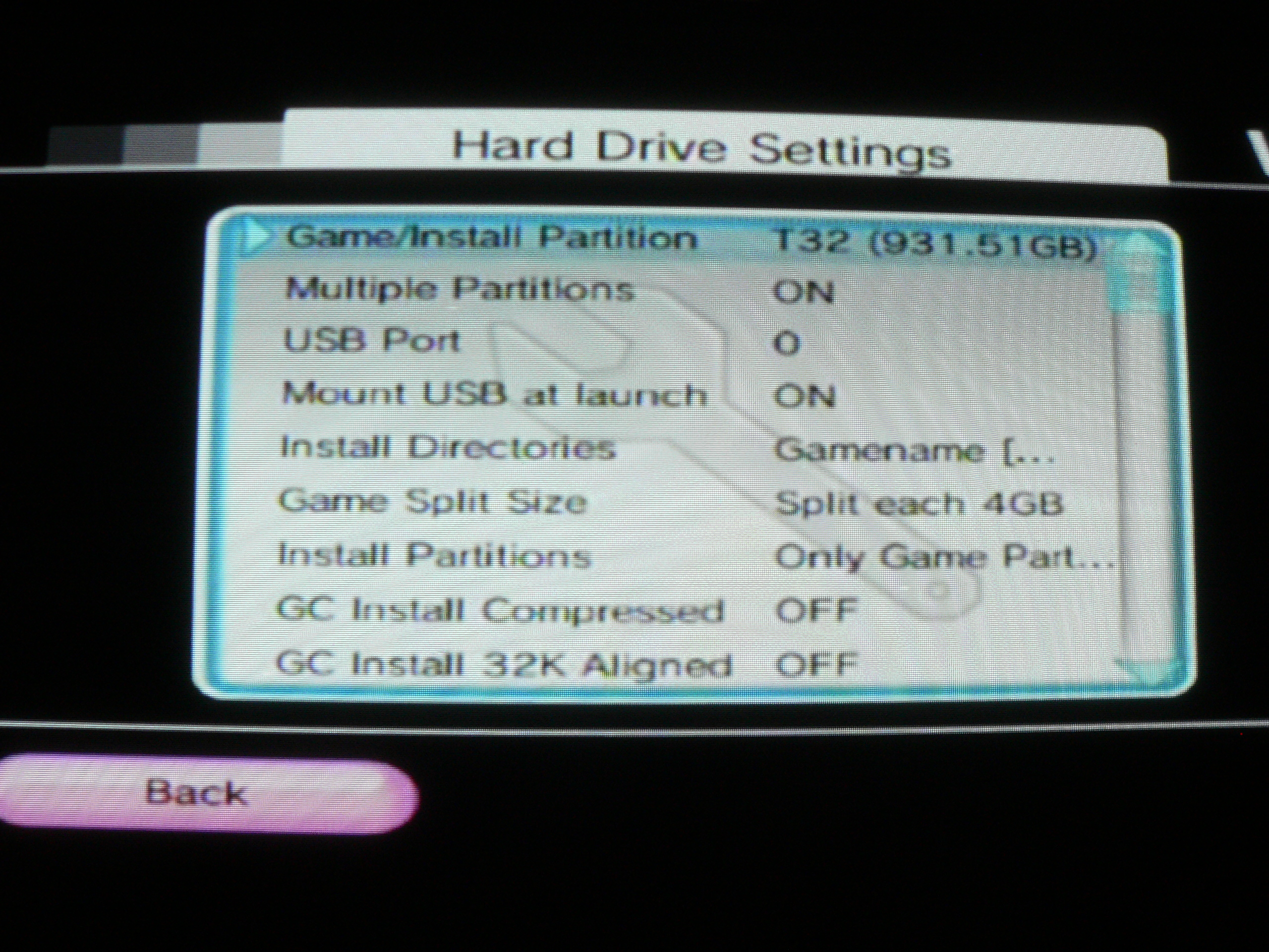

Please look in the USBLoader GX Settings if your SSD is initialized:
Settings - Hard Drive Settings -> Game/Install Partition
You can also try the "Sync FAT32 FS Info" Option too.
If your USB Stick is not recognized,that is nothing unusal.You can try to format it with WBFS (please Note - this is NO Solution,only a Workaround please).
and please always use the WiiBackup Manager for the Game Transfer.
Good Luck

Hello.:)
View attachment 198488 View attachment 198489
View attachment 198490 View attachment 198491
Good Luck
Thank you.:)

After you have all Points checked,it is unfortunately "near" nothing left.....:(
It was not asked but to get sure:
Did you use the Port 0 for the USB Device ?
Your USBLoader GX Loader´s IOS is set to 58 or 249 ?
Settings/Global Settings - Loader Settings -> Loader´s IOS please try 58 if it is set to 249 and vice versa please.
Base 57 has better Game Compatibility,Base 56 is the "Backup" if 57 failes to load.
Base 58 is not usual as "standard" Base for the Games.:(
So 249[57] and 250 [56] should work in 99 Percent of the Cases.Many Users report the 249[56] and 250 [57] works better on the USBLoader GX,so it will be.:)
Please try this 2 Sets in Combination with Loader´s IOS 58 or 249 please.
You can also try the Configurable USBLoader to boot your Games,it shows the used IOS on Startup so you can configure the Games in USBLoader Gx per Hand if needed.
Please Note that not all Games work with 249.
I am confident,one of the Combinations will work for you.
Please use the d2x cIOS installer to complete your cIOS installtion on 247 and 248 too,some "Shovelware" Games maybe need one of this.
I really hope you get a Solution for you now.
Thank you and
Good Luck.:)

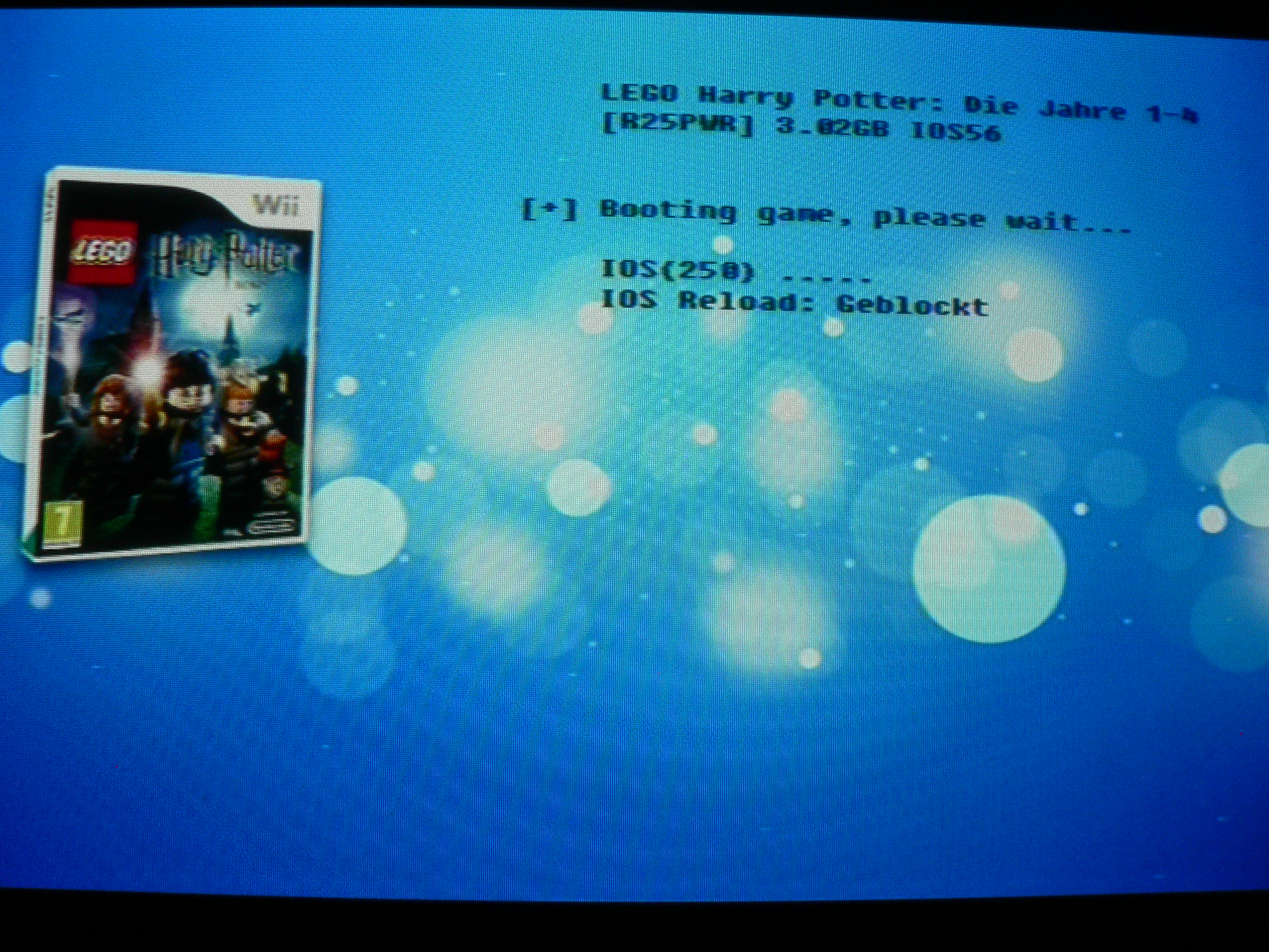

Thanks! I tried the cIOS 249 and 250 combo and when I launch any game it kicks me back to the homebrew channel instead of just freezing. This also happens with cIOS 247 and 248. I can confirm my drive is in the right port and it’s formatted as MBR and NOT GPT. CFG won’t load my SSD no matter what IOS I use. I can’t get USB Loader GX to find my drive when I use IOS 249 as the loader, only IOS 58 works.
