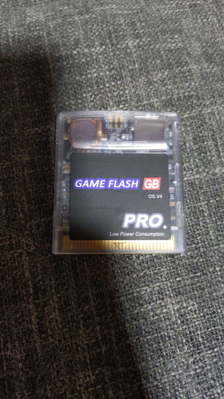

i just bought one Game Flash GB OS.V4 Pro+ and of course it came with OS 1 installed on it.
I already opened a Dispute on Aliexpress because it's false Advertisement.
If it would have been OS4 that's on the Card I wouldn't care about it but because it's on OS 1 which sucks I'm not okay keeping it.

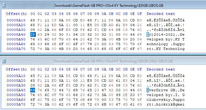

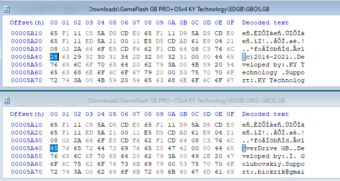

Since I like taking risks so you don't have to, I tried this version of the OS which I think is exactly the same file melteolate shared. Only the Author part of the code was altered while everything else is the same... Amazingly, it worked. Looks like this is a clone of the Everdrive GB Classic and OSv4 IS its final version.

Comparison:
Checksums:
  • CRC-32: E7B74777
  • SHA-1: 28ED3A797DA3C48C309A4EF792147F3C56CFEC40
  • SHA-256: 32EBB1ABCC1C601CEB9C4E3C4FABA0CAA5B85BB98C4F1E6612C40FAA528A91C9
  • MD-5: 84C40473414CAF2ED4A7B1283E48BBF4
I attached two versions I found. One where GBOS v4 was patched by marv12345 to work on any clone made by KY Tech (patched GBOS found from elotrolado, but obviously UPDATE AT YOUR OWN RISK) and another that's guaranteed to work on the clone I have (Game Flash GB OS. V4 PRO+ Low Power Consumption).
Take note that you can't flash the firmware. You can only sideload it.
OS v1 permanently burned inside of cart, but cart will load OS from sd to ram, just like on n8 or edmd-v3, in case if OS file loaded to EDGB folder.

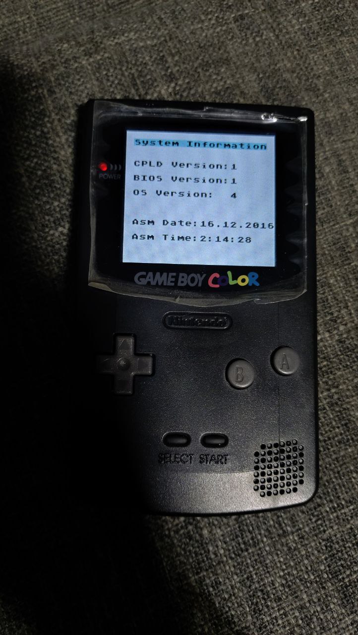

I got good news, the Firmware that Fabax01 provided works and did not Brick my flashcard.
Finally there is an Option to swap A and B in the EDGB Menu.
I know I'm late with my response but i finally managed to test it.
All you need to do is to put the GBOS.GB into the EDGB folder on your SD Card.
If you get an error just remove the SD card, turn the GB on without the sd card and try again, that's how it worked for me.
You don't have to execute the GBOS.GB, just check the Firmware Option by pressing Select in the Main Menu and then About, there it should display OS Version 4.

Hi,
First of all thanks for this post, this is awesome.
2nd. Just want to make 100% sure. Is it this firmware (see screenshot) you updated your card with?
Thanks in advance,
Safi

The one from @Fabax01 is the one that works like in the Screenshot i attached.
Just extract and copy the EDGB folder to you microSD card.
It might not boot at the first turn on, if this is the case turn off your gameboy and turn it on again, then it should be on OS 4.
Don't execute it manually, all you need is to copy it to your microSD card and the Version will be OS4.
