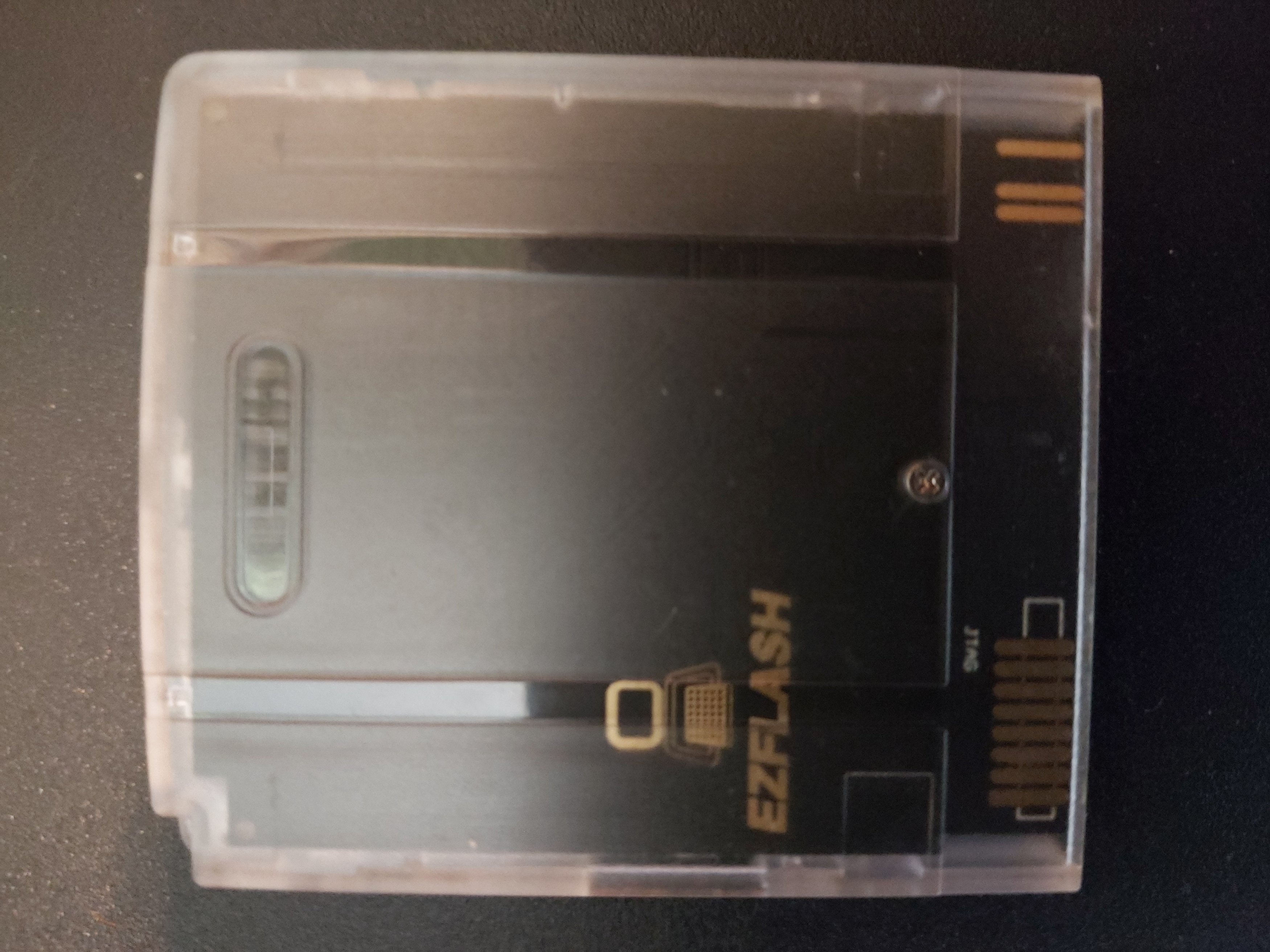

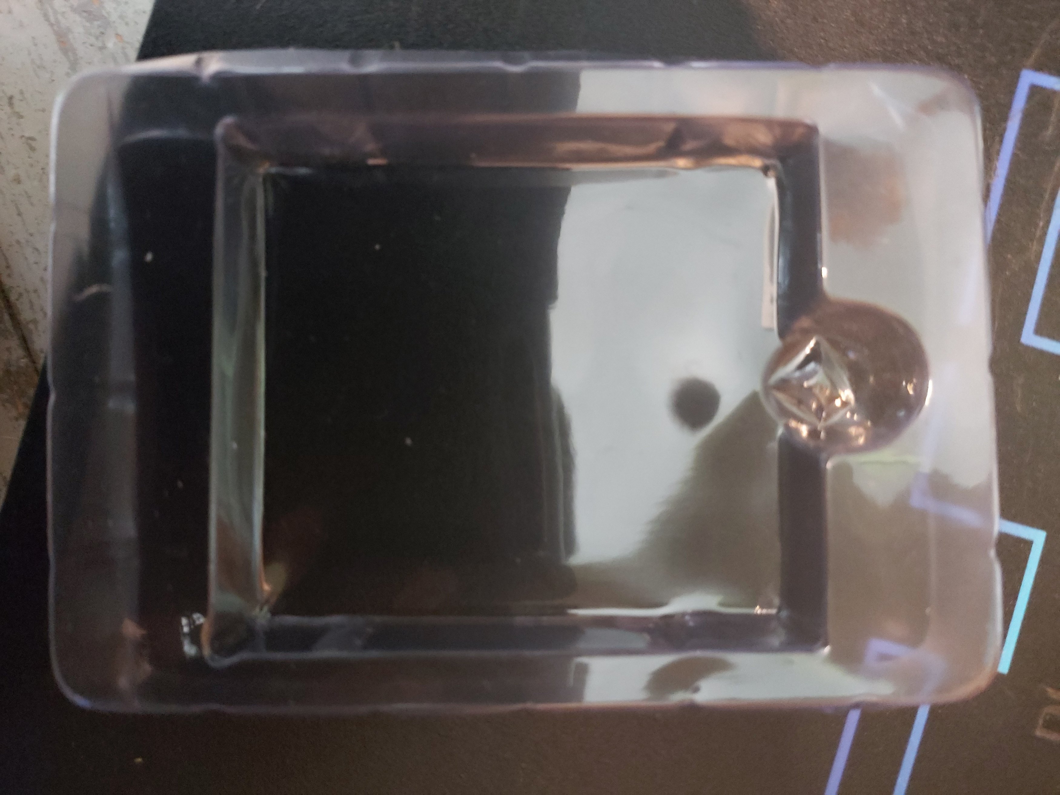

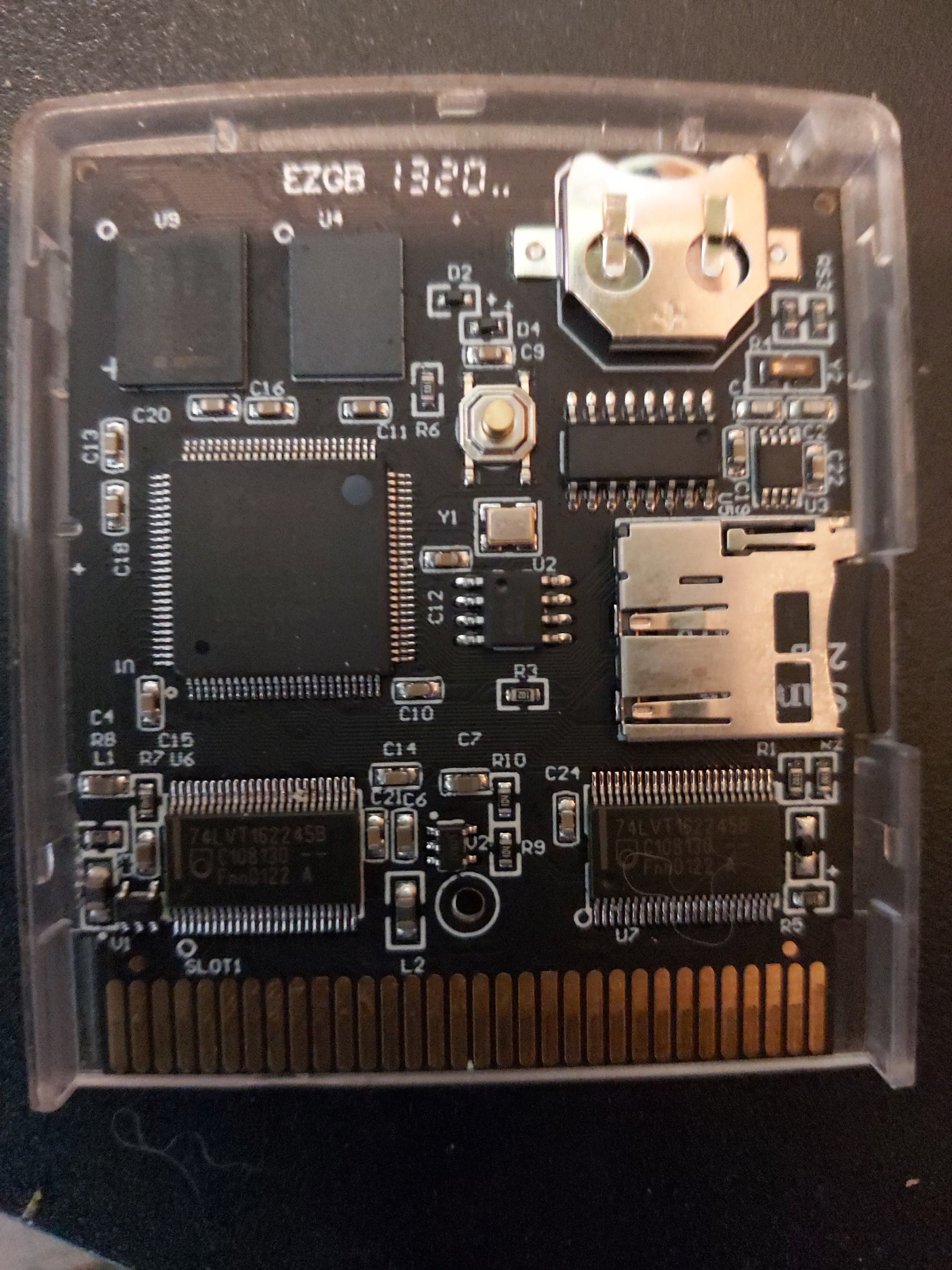

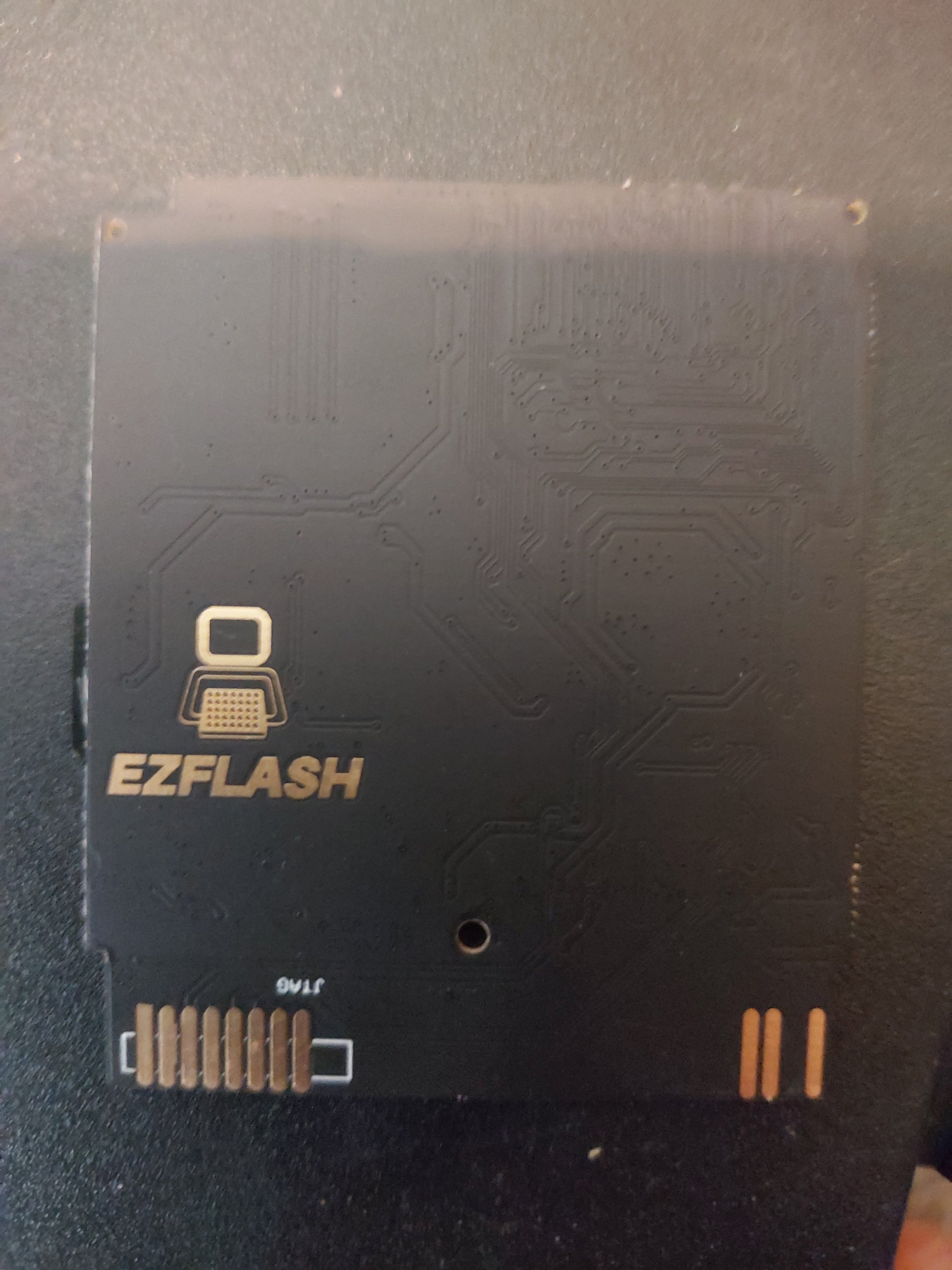

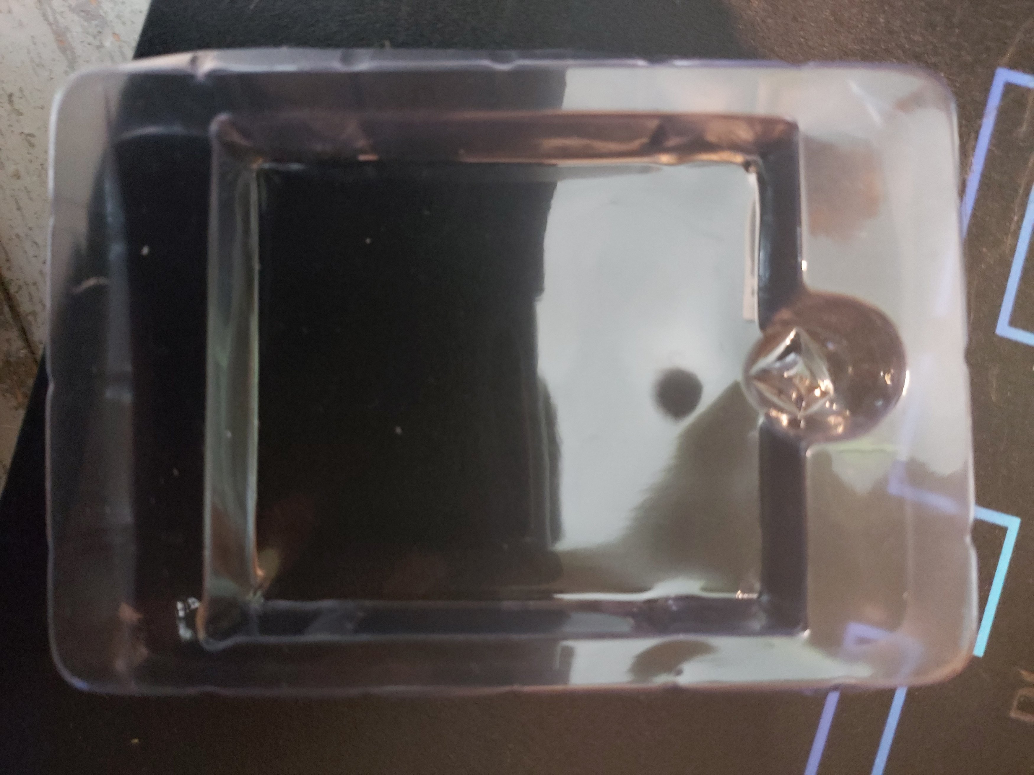

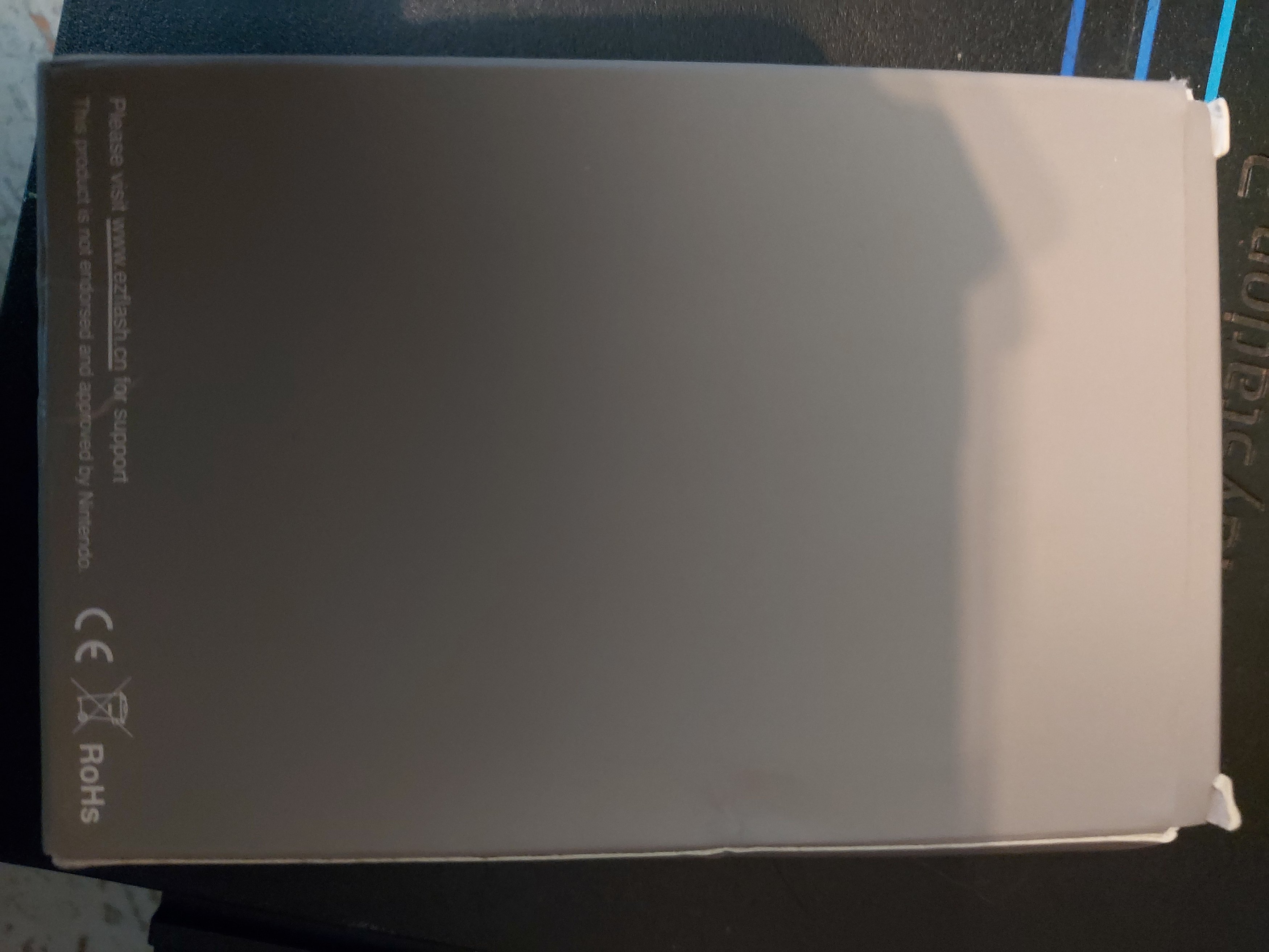

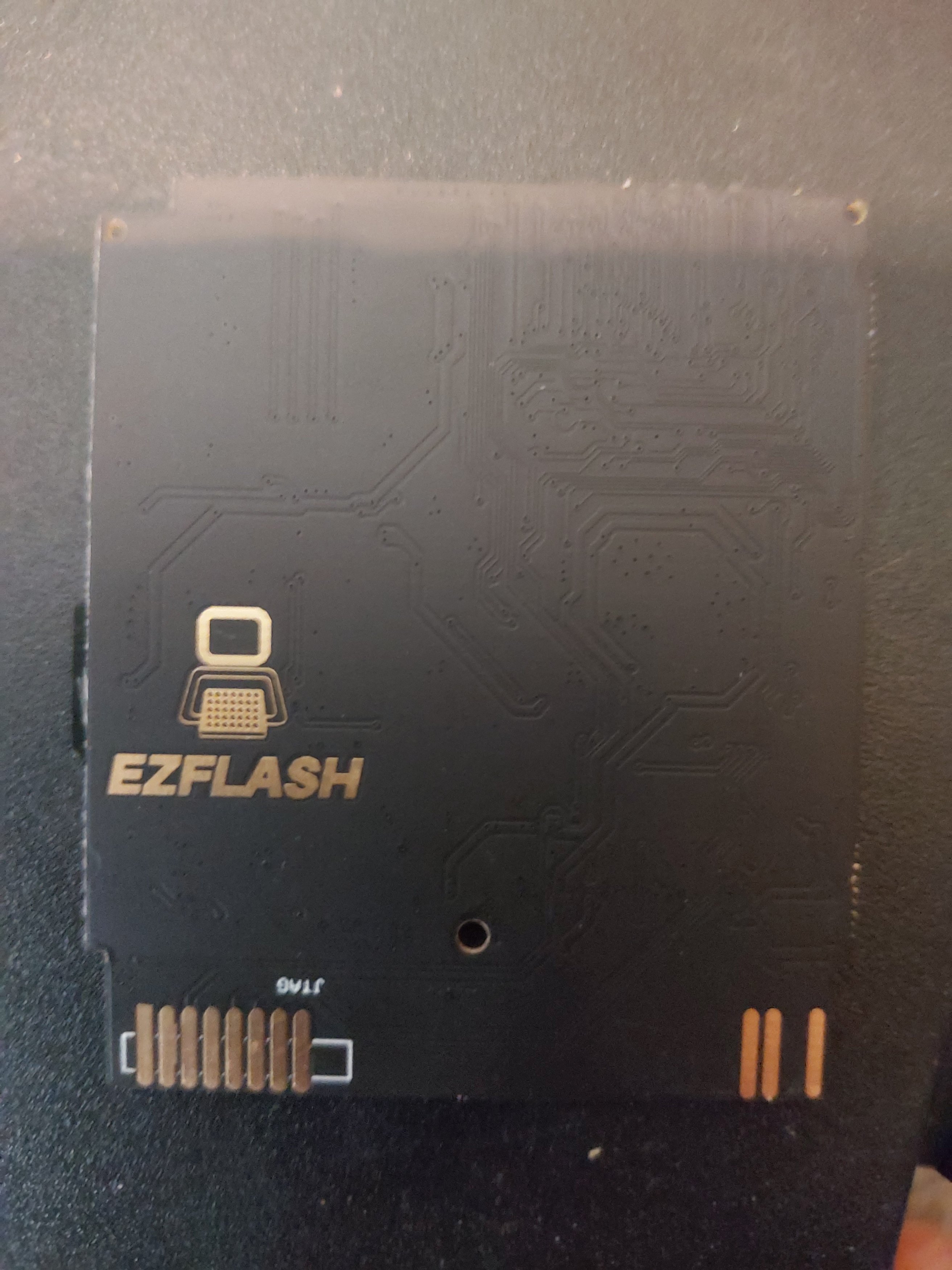

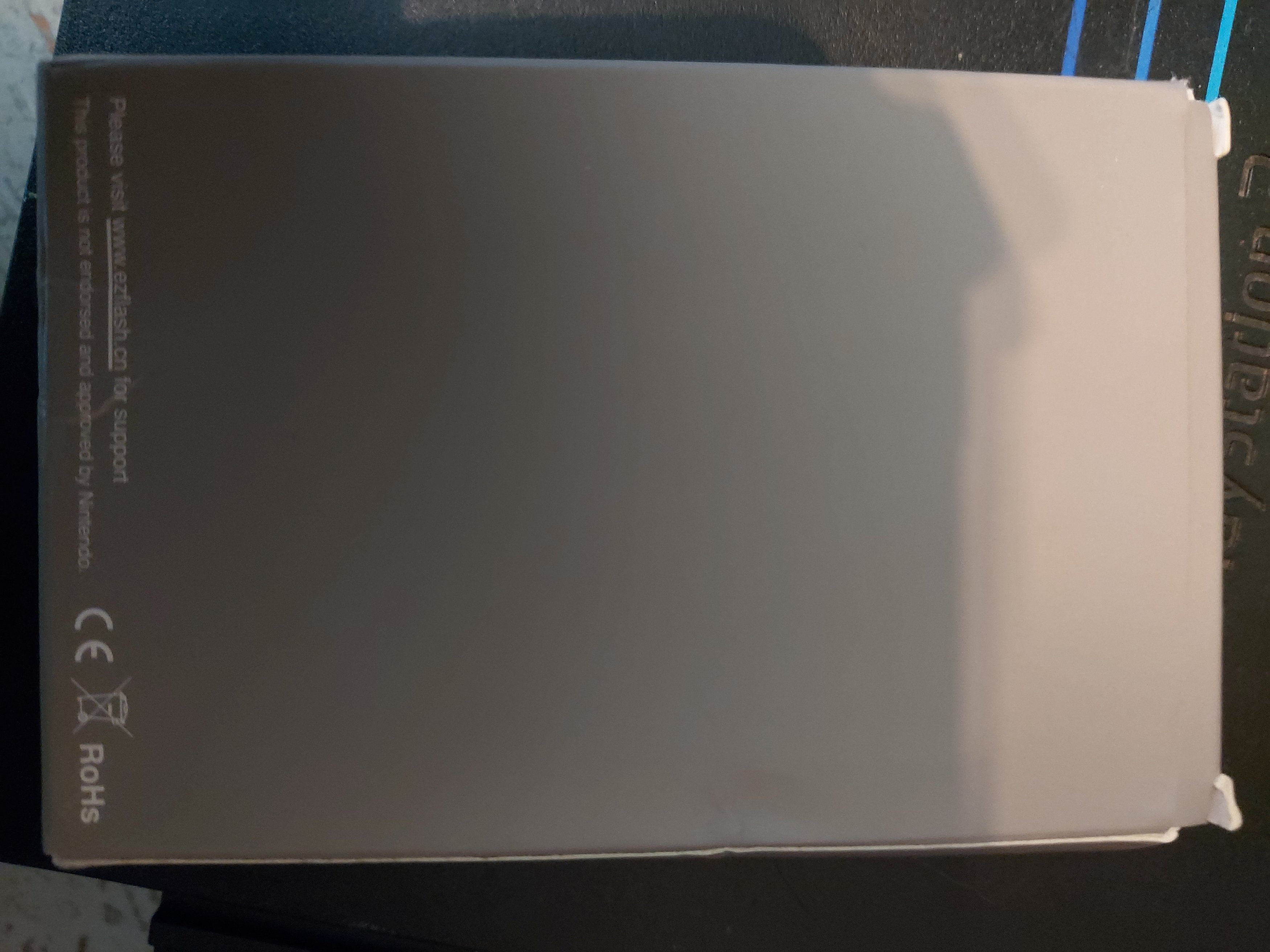

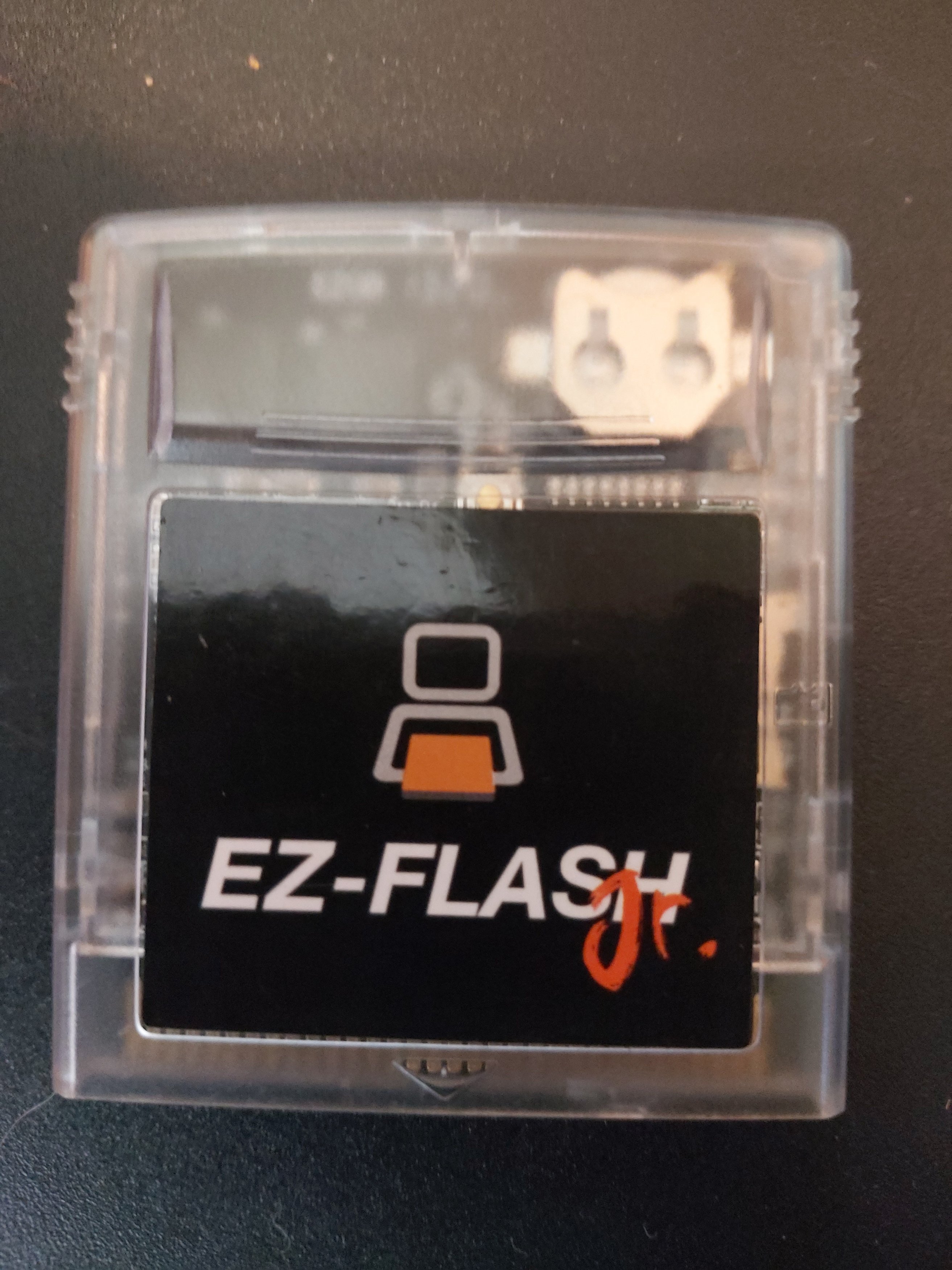

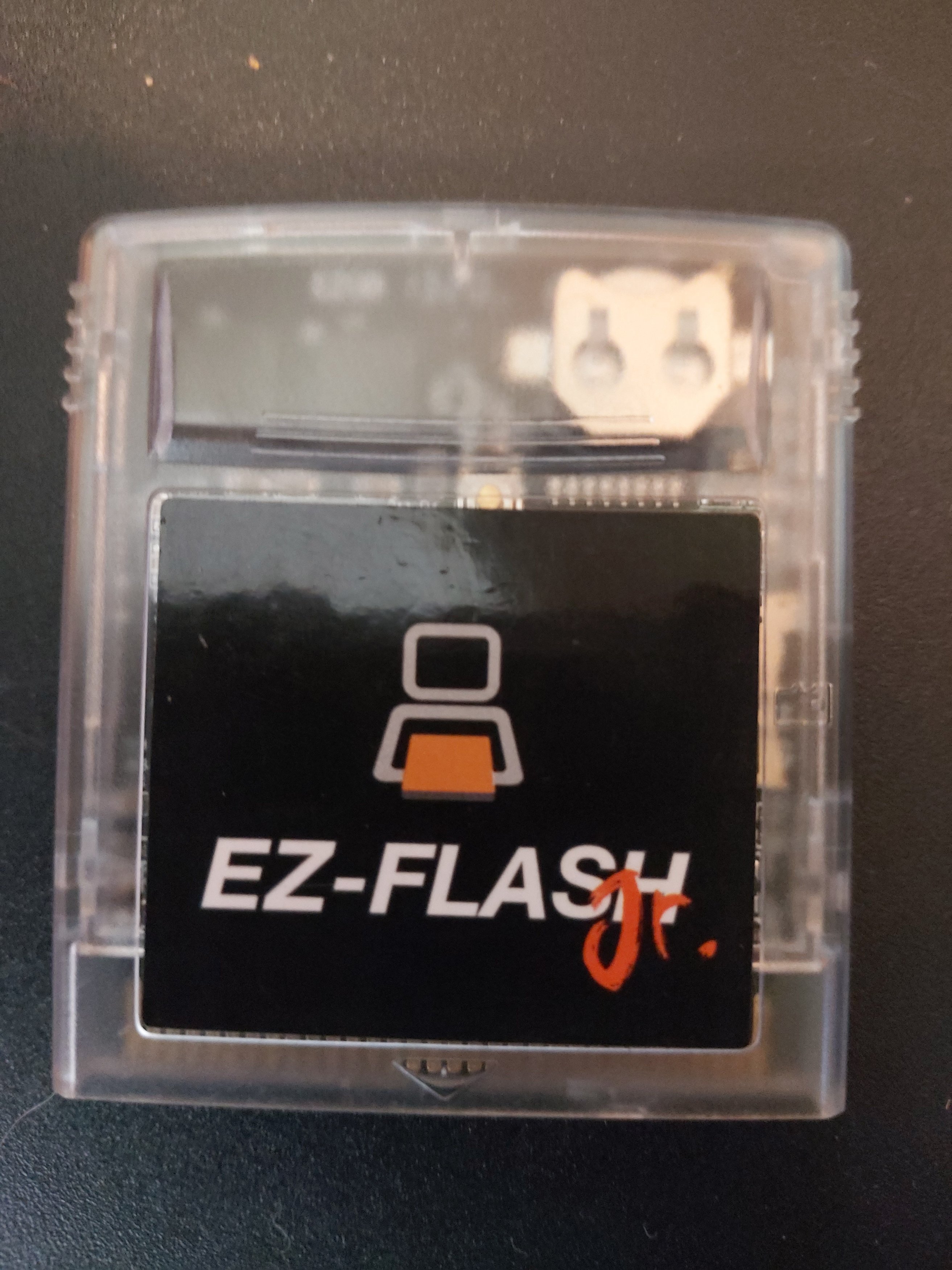

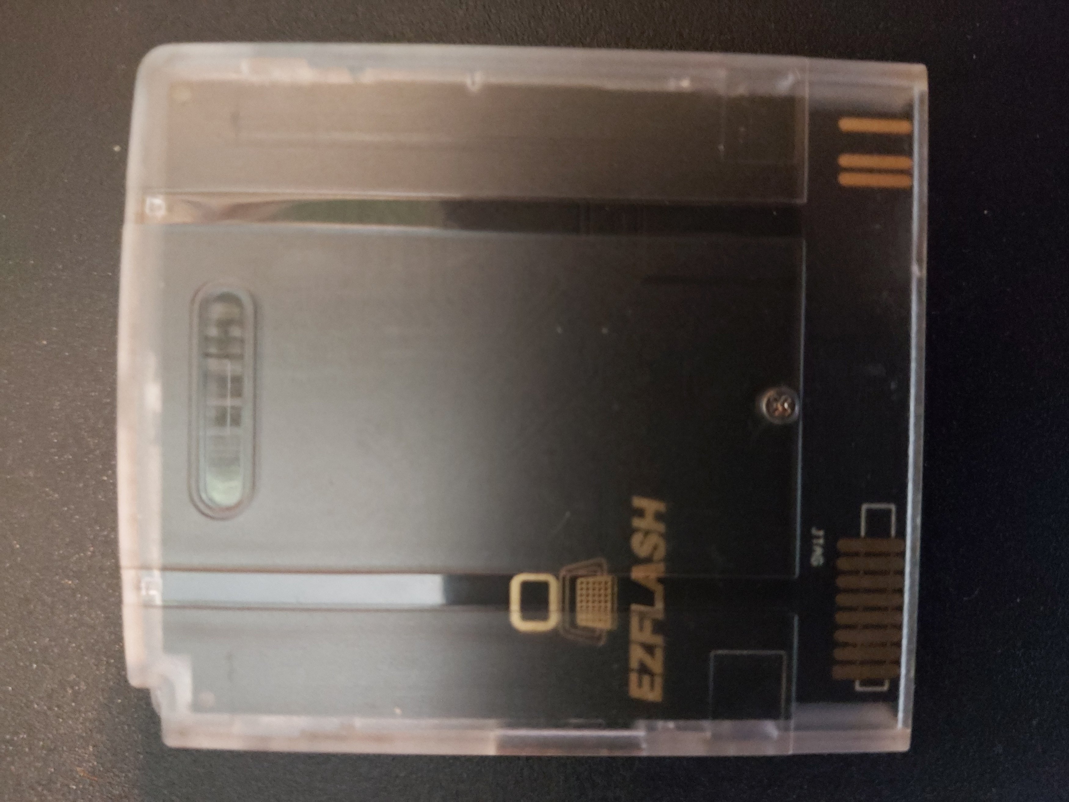

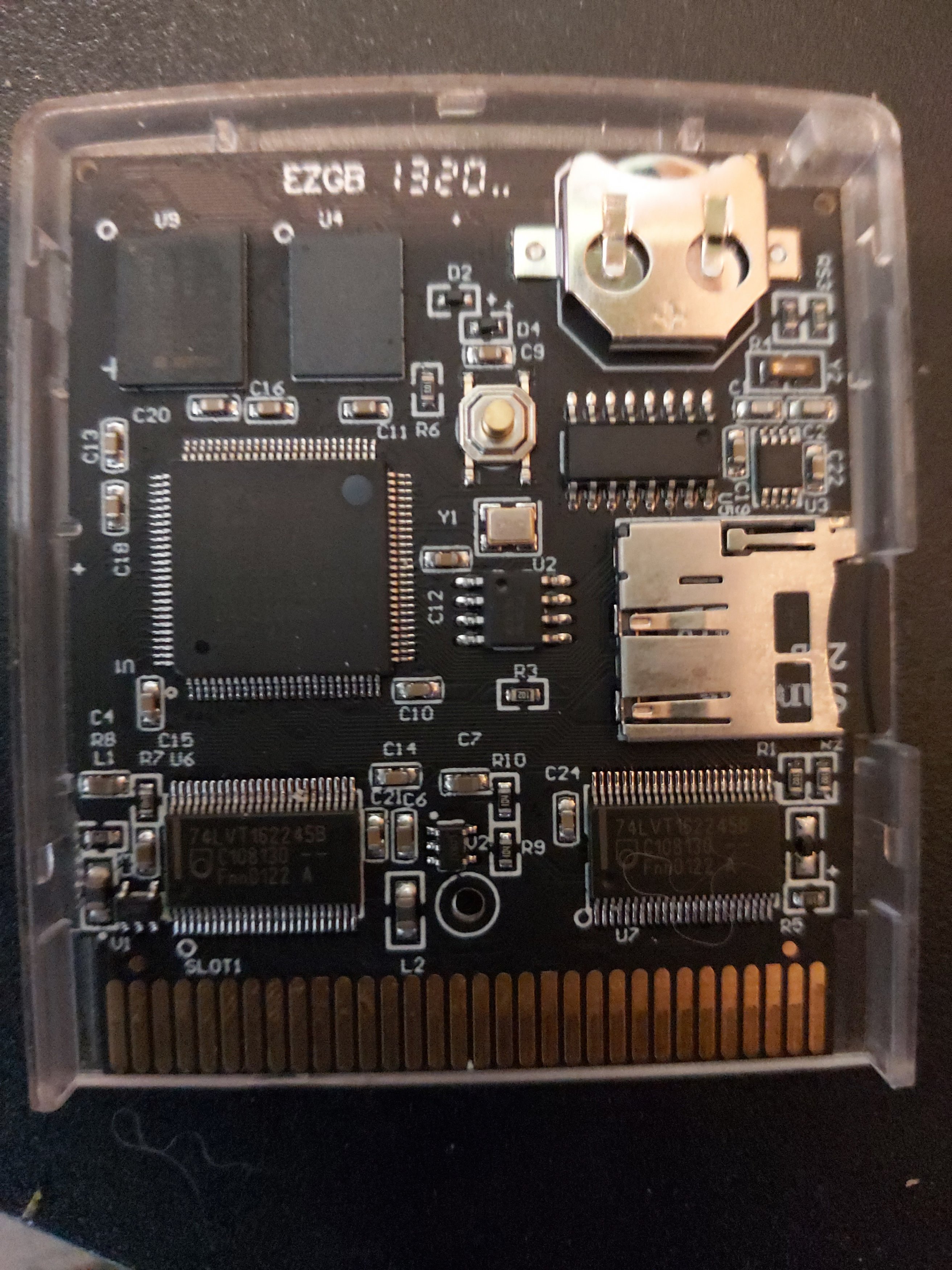

I have been thinking are these ebay listings of ez-flash junior, fake. I ordered from this seller.
https://www.ebay.com/itm/EZ-FLASH-J...0cc71:g:yM4AAOSwIbVeDusy&shqty=1&isGTR=1#shId
So is it fake?
20200802_155019.jpg 20200802_155113.jpg 20200802_155139.jpg 20200802_155241.jpg 20200802_155254.jpg 20200802_155300.jpg 20200802_155315.jpg
Ah fuck off man. You always come into these threads saying its faulty or its their fault.
lol thats what he does
it's real
