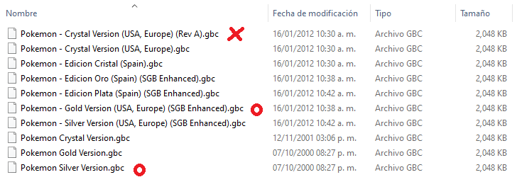

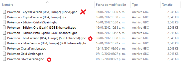

@RetroKarl please give me the full name of pokemon games which you mentioned in last post, such as gold, crystal.
This ones are almost all the version that I use, the ones of my last post-test are the ones with the "O", the Crystal with the "X" is the only one that I have not tested yet. And the other ones, I tested all of them in my past tests.
(It's IMPORTANT to clarify that all the issues listed above happened after several saves, if someone wants to reproduce these issues, you will have to create a new game save, probably pickup you initial pkmn, save in game, turn off/on-reset, save backup file in EZflash jr, reload game and repeat this process at least 12 times to be sure, verifying the correct time-date in loading and ingame (pokegear), if there's no issue at all, then I think I have a defective unit :s , right now I just have the confirmation of another person of the issue of the time-date changing randomly at loading screen and then getting back to the correct time-date one day later)
I'm using two Gameboy Colors for the test, one Grape and one Atomic Purple with no modifications at all.
