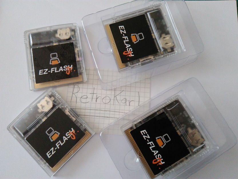

Hi, I already have Four EZ-Flash Jr, and I can tell you, the issues with the RTC are not related to the SD Cards at all, I have 2 cards working fine in FW4-FW5, 1.04-1.05, another that gets sometimes crazy (RTC in game Pkmn official games, NO-INTRO) with FW5 1.05, but works fine with FW4 1.04e (I have one mate in another forum with the same issues) and a final one that gets super crazy with FW5 1.05, and FW4 1.04e jumps the hr each 30 secs with Pkmn official games. And the developer said that it was a known issue, so I guess that we are dealing with many defective cards or different quality in components.

I have some similar issues with 2 out of 4 EZFlash Jr cards, the developer said that It was a "known issue" and tried to solve it in FW5 Kernel 1.05, but things gets only worst in my two cards with the problem. I hope he can give us an answer. Because I have another mate with similar issues, so I want to know if we are dealing with many defective units.

Hi, do you have any idea of the reason of the different behaviors of all the cards? Because in the 4 EZFlash Jr cards that I have, I get a lot of different behaviors like if all of them are different hardware. Do you think the one with the time switch each 30 secs on the FW4 1.04e will have a solution? Or I better request a refund?... Thanks in advance for your time and for the hard work. Cheers
