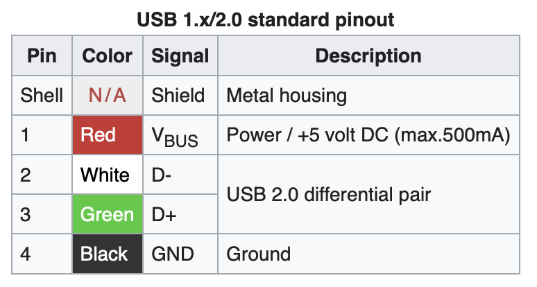

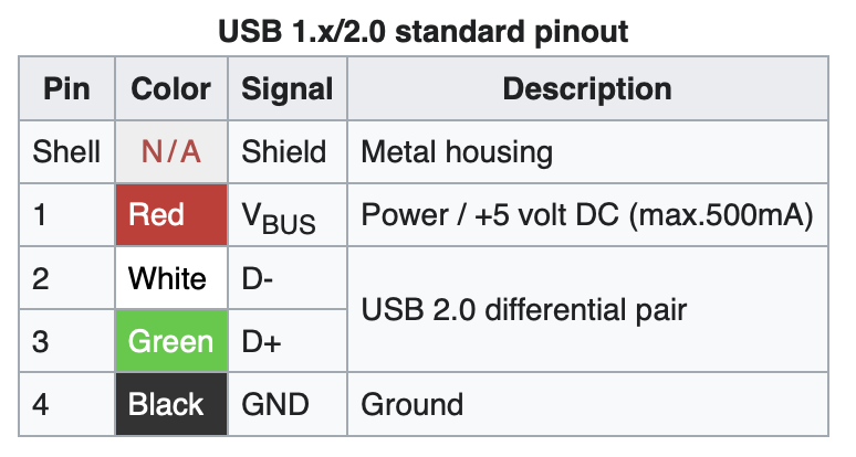

I've heard the PS3 also uses 2.0 USB ports and also, gives 500ma. Why have I never heard of people using Y-Cables for their PS3 external drives? What is it about the Wii?
:) https://www.psdevwiki.com/ps3/USB

That's actually a confirmation of my and your words - PS3 USB port is limited to 0.5A :). However, I suppose, the power supply circuit on the main board may be separate. And this may give a little boost up to 0.65-0.7A or so.
