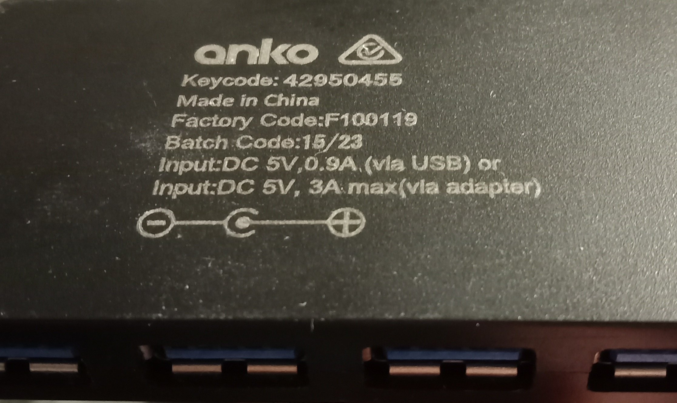

Yes here is a picture of mine:
Again, I can't depend on a second socket. I could power the drive with this:
And do this:
But as you've just informed me, USB Hubs distribute evenly between ports so, (500ma + 500ma) ÷ 4 = 250ma of power in the HDD Y-Cable power end, and it's getting another 250ma from the Y-Cable data end, meaning 500ma total so no advantage over a single USB cable in one port. But I doubt that strange set up would have been possible anyway.

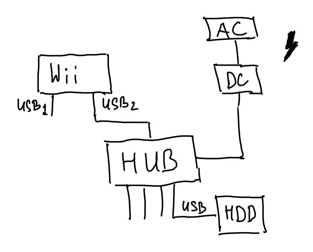

I wouldn't consider powering the hub from the second USB port. My point is - power the hub from a separate (not USB) power supply. Then, connect the hub to the Wii's first USB port. Based on the documentation of your hub, it appears that it has a separate power cable (which is, for some reason, expected to be connected to another USB port :)). As far as I understand, the power cable is a bit short.... So, consider, at least, buying something like:
https://www.digikey.com.au/en/produ...BWiy21D8HAAbIG6Yi46-ixEAO64vAAE2ACuLCyYAJ6hQA
I.e.:
PSU, 5V 20W (4A). The only thing - the output plug should match the one you're using. I.e., internal diameter (probably around 2.5mm), external 3.5mm, positive - center (based on https://manuals.plus/m/63128fb27a8fdd18e5f65db32b6226924e7e9f95dff82822bc2c024dba7b3859_optim.pdf, if I'm not mistaken). Those PSUs mentioned above are likely 2.1mm, so you'll likely need a barrel addapter (from 2.1mm to 2.5mm), like this:
https://www.digikey.com.au/en/products/detail/mean-well-usa-inc/DC-PLUG-P1J-P1L/12142219

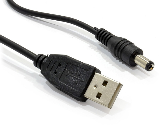

My hub didn't come with a cable :)

As mentioned a few times, I can't depend on a second socket.
Yes, that's why I was telling, in order not to use your second USB port, the power supply should be totally separate (like wall adapter or something, which is not connected to Wii). Or I'm missing something? If so, I'm sorry for misunderstanding...
UPD: this is what I was talking about:
UPD2: btw, this way you could connect your second drive to the hub... leaving one USB port empty...
Yeah just looking for something that doesn't depend on a second socket.
My Wii is very tricky to access, and I depend on powering it on using the Wiimote's wireless power button. Unless there is a way to ensure the second socket only draws power at the moment the Wii is powered on, and turns off, I can't depend on a second socket.
