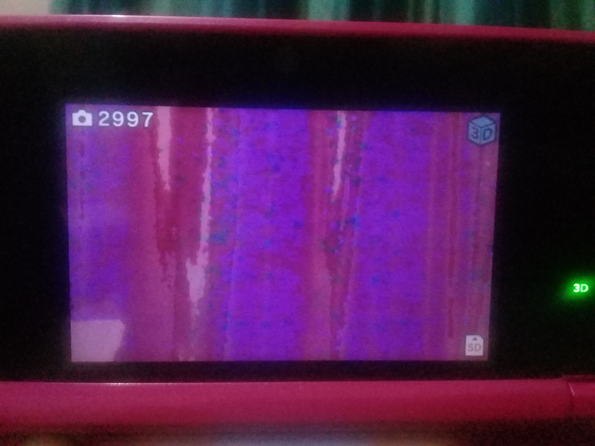

It is strange that neither CTRTransfer in GodMode9 and Decrypt9WIP coupled with updating in Recovery Mode or Setting Systems is fixing your system applets.
This leads me to believe there may be something wrong with your o3DS hardware. The 3DS/2DS systems are known to not have fail safe if parts are broken.
Can you verify if both your outer and inner cameras work?

Inner camera looks fine, but outer camera... I think ones broken beacuse the picture comes out in pink and purple. Nintendo 3DS Camera works. When using the camera in 3D it feels like its only going through one eye.
3D works if its not in camera. Mic works, and all buttons. The touch screen doesnt work around the sides. It was like that when I bought it so I already knew the touch screen problem. But it never affected my gameplay so I didnt mind much.
That camera view where one eye sees the 3D image and other does not means one of the dual rear lens is totally busted. The 3DS can't make a 3D image, so the parallax in the upper LCD shows one eye black (nothing) while the other sees the pink mess. If that one side sees pink, this indicates this side too may have a cracked lens, liquid damage, misalignment, etc.
For the touchscreen, the digitizer has lost the ability to register input for those sides. You might be able to fix this by:
  • Removing any screen protector film it has on. Plastic film can dampen sensitivity or trap dust.
  • Clean the side edges of dust and dirt specs with light strokes using a toothbrush and fine tip toothpick.
  • Re-calibrate: System Settings → Other Settings → Touch Screen
While a slightly broken digitizer isn't likely to cause the 3DS to completely stop working, a dead rear camera assembly can make it refuse to boot to HOME Menu with an infamous Black Screens of Death symptom.
I think yours an edge case where that rear camera isn't dead but certain system modules freeze up when they don't get the input response they're expecting from the bad lens side. This would be kinda like if you're driving down a road where the light turns from green to yellow. Drivers are fairly certain whether they can drive past it or have to slow down before the light turns red. Now, the problem is this specific street light stays yellow and doesn't turn red at all. How are you suppose to react to that?
What does this all means?
To fix those system applet hang ups would require replacing the rear camera assembly. Because the parts located in the upper half of the 3DS have delicate flex cables that goes through one of the hinges, disassembly to get to that camera can end up breaking them.
