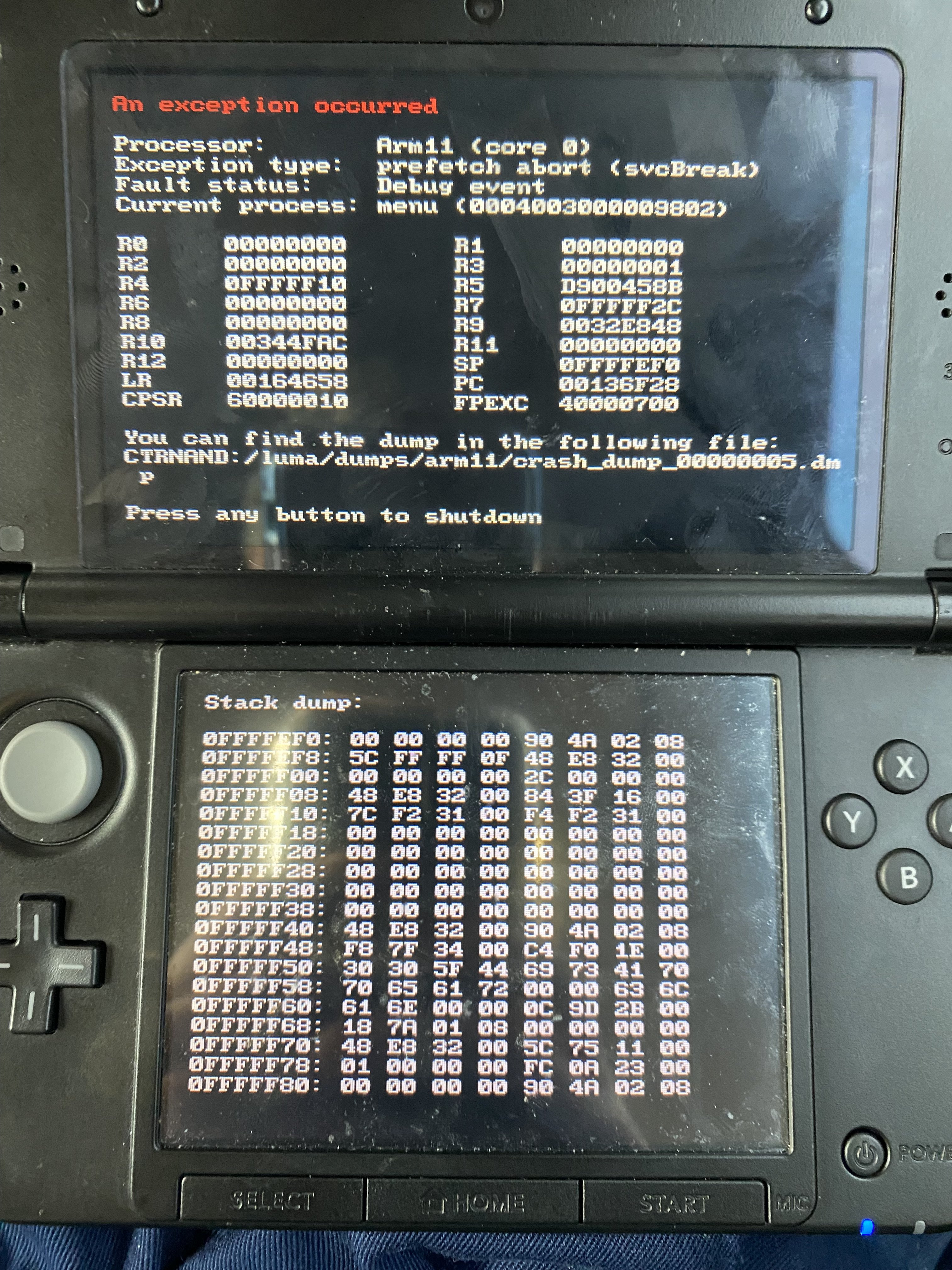

The title says it all. I’m struggling to turn on my 3DS as it crashes with and without the SD card. And it keeps saying it’s an issue with the menu app so when I changed the settings in Luma’s menu to automatically go to the homebrew browser and it was able to launch but when I tried to go the the menu it crashes again!
I have linked an image of the error screen I receive. It worked a couple hours ago and but for some reason when I closed the screen for a few seconds and reopened it a little later it was frozen in a black screen so I had to force shut it down. I haven’t added anything to it recently so I don’t know what has happened and why the menu seems to be corrupted!
Currently I have no access to opening up the SD card on a computer but it won’t even open with it removed!

Can you access Luma3DS menu or GodMode9 at all? With or without the sdcard?
This sounds like a hardware issue. You could try checking the sd for errors with h2testw, then doing a ctrtransfer if you can still access GodMode9, otherwise you might need to replace the sd card reader..

I am able to access both with and without the as card, but it refuses to launch even with it removed. It seems to me like the menu is broken because when I booted into the homebrew app after changing luma settings, it successfully booted, but I still can’t to the menu without crashing.

What homebrew app?

Did you test the sd card?
If you did, you can try booting into the recovery mode with the button combo, and update the firmware from there. If it crashes or freezes, then i suggest doing a ctrtransfer.

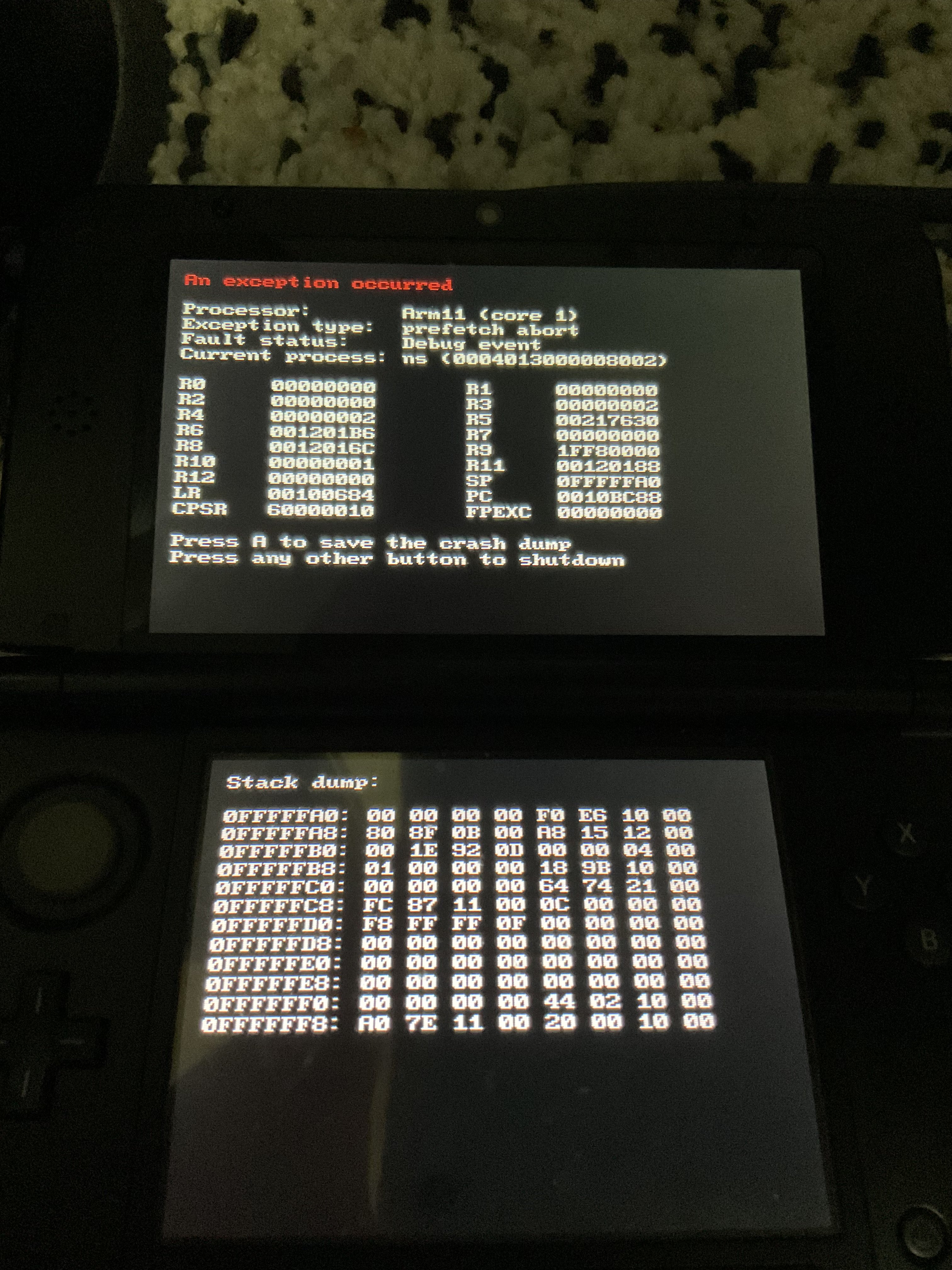

Hi, it’s been a while but I got a hold of something that has an sd card reader and I tried to do a ctrtransfer but it has failed once again. Is there anything I can do? And no, the sd card does not appear to be the issue as it still crashes without its sd card, and even an sd card from another 3ds that functions.
what can I do? I really think it’s hardware related
at the bottom of the crttransfer guide it says something about deleting system save data. But I really want to avoid that as I have things in the system I really want to preserve
Oh no it isn’t an error like before, before it just failed to load the menu and I was stuck on the homebrew launcher. Now I can’t even get to the homebrew launcher at all!
Ever since that ctrtransfer a larger issue of not even being able to boot what so ever has occured. I did get the right ctrtransfer thing as I have a EU model and I downloaded the EU version. I can still access godmode and luma settings but nothing else is accessible due to another thing breaking

I was talking about the 3ds's sd card reader, and not the kind of sd card adapter that you plug into your pc (to transfer files etc). Unless you bought a (3ds) sd card reader replacement?
It failed? What error did it give you? Did GodMode9 crash, freeze or glitched when "it failed" to complete the ctrtransfer?

Maybe it is hardware related, but you still need to make sure the sdcard is not to blame first, and if it is faulty it might explain why the ctrtransfer failed..
Yes, you can't use your old "Nintendo 3ds folder" (the one that contains your installed games & saves) after doing the ctrtransfer, so backup that folder along with some essential system files that are mentioned here in this thread (in order to decrypt your saves later, since Checkpoint is unaccessible for you now). As for your installed games you can dump them with GodMode9.
So the ctrtransfer process was completed successfully? And by "failed" you meant it won't allow you to boot into the home menu?

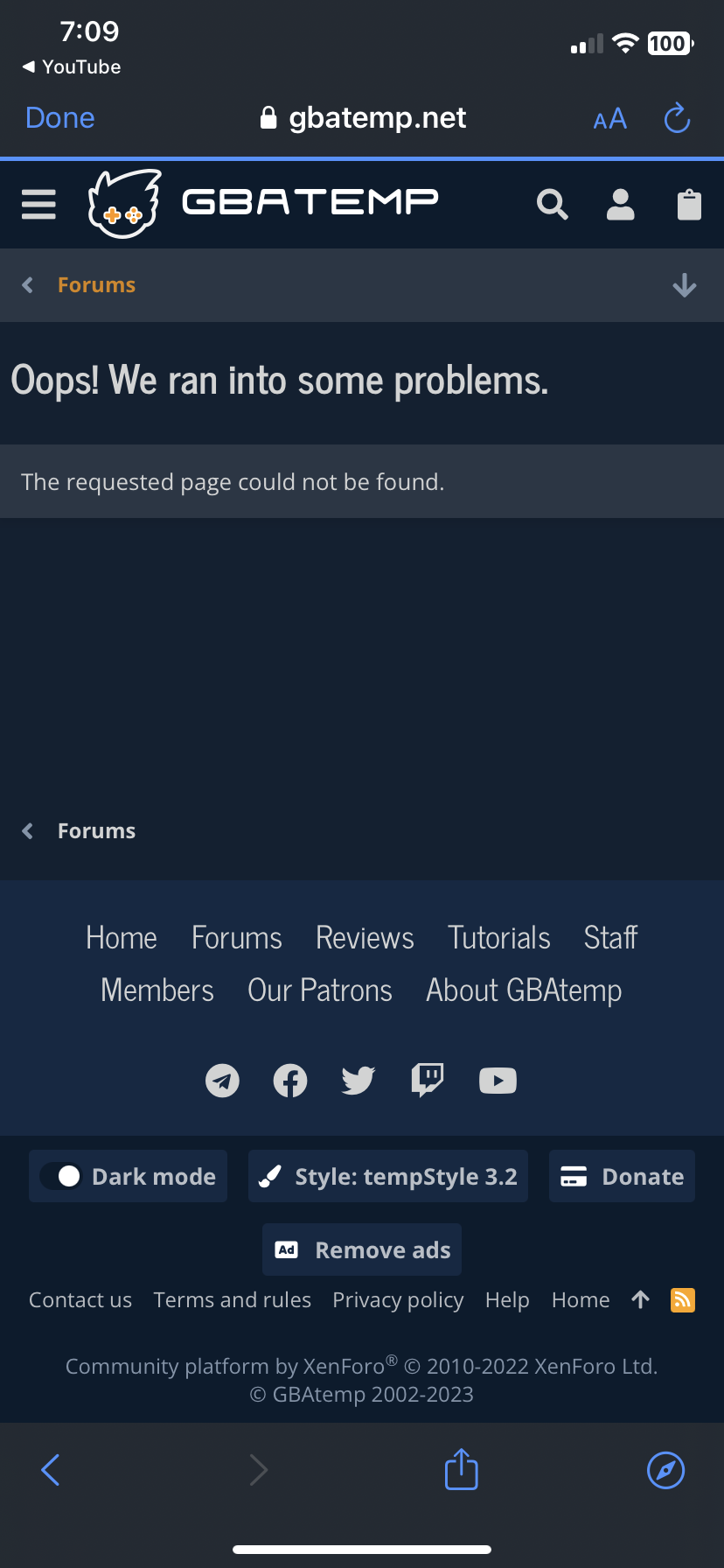

No I followed the guide and it didn’t mention anything about backing up the nand before a ctr transfer. But I got the nand backup so what should I do with it? Because I don’t mind if I just reset the ds if there is nothing I can do to repair it, but I want to be able to recover some of it.
I can’t access that. But how am I supposed to fix it with that? Do I need to replace the home menu app? Because I have no idea on how to do that.
ok turns out the link had extra parts added but what do I do with this titleid?
