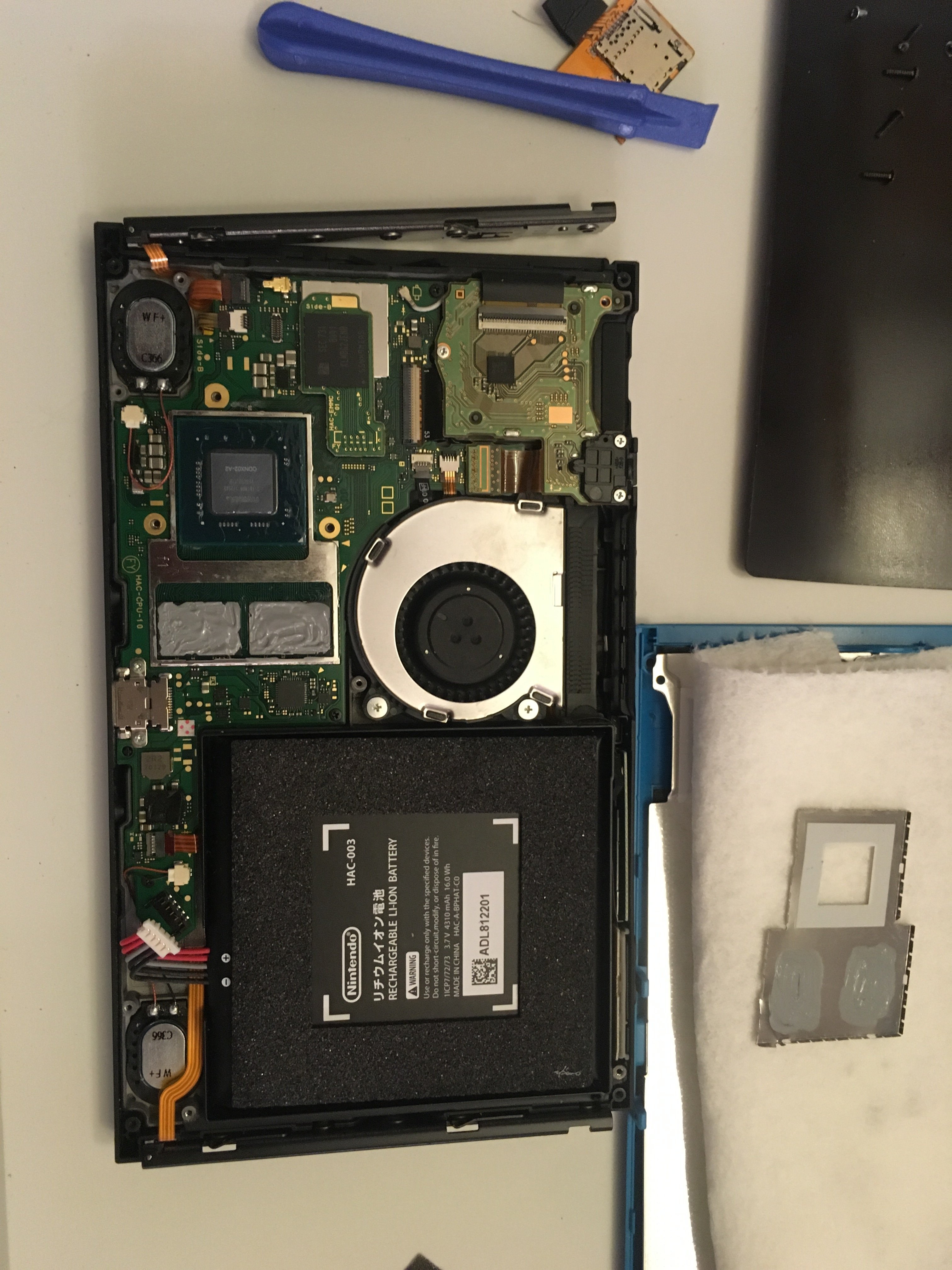

You mean the cap over the die, or the heat shroud covering the internals from the backplate?
I guess it's not as intensive as BotW. If I develop issues with heat when I play other games in the future, I'll be sure to re-apply. I'm questioning how well the thermal pad I placed between the heatsink and shroud will benefit or damage me.
Cap over the dye and memory chips

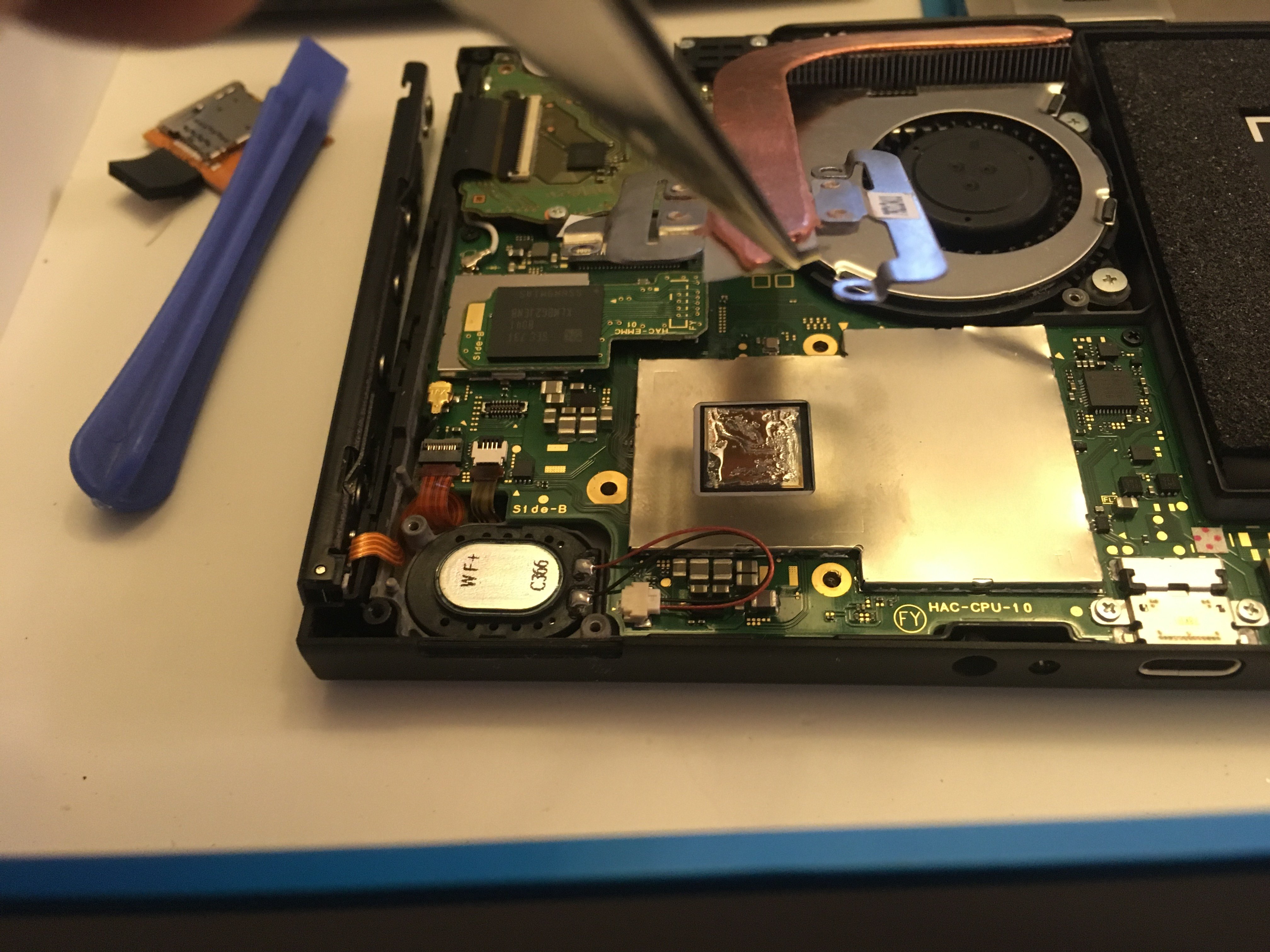

Hmph! I'll have to re-dive into this process then, did not know they were easily removed. Do they just take a little wiggle to pry off?
I just use tweezers. I started from where the memory chips are and pulled at an angel. Once you get part of it off it comes off really easy.

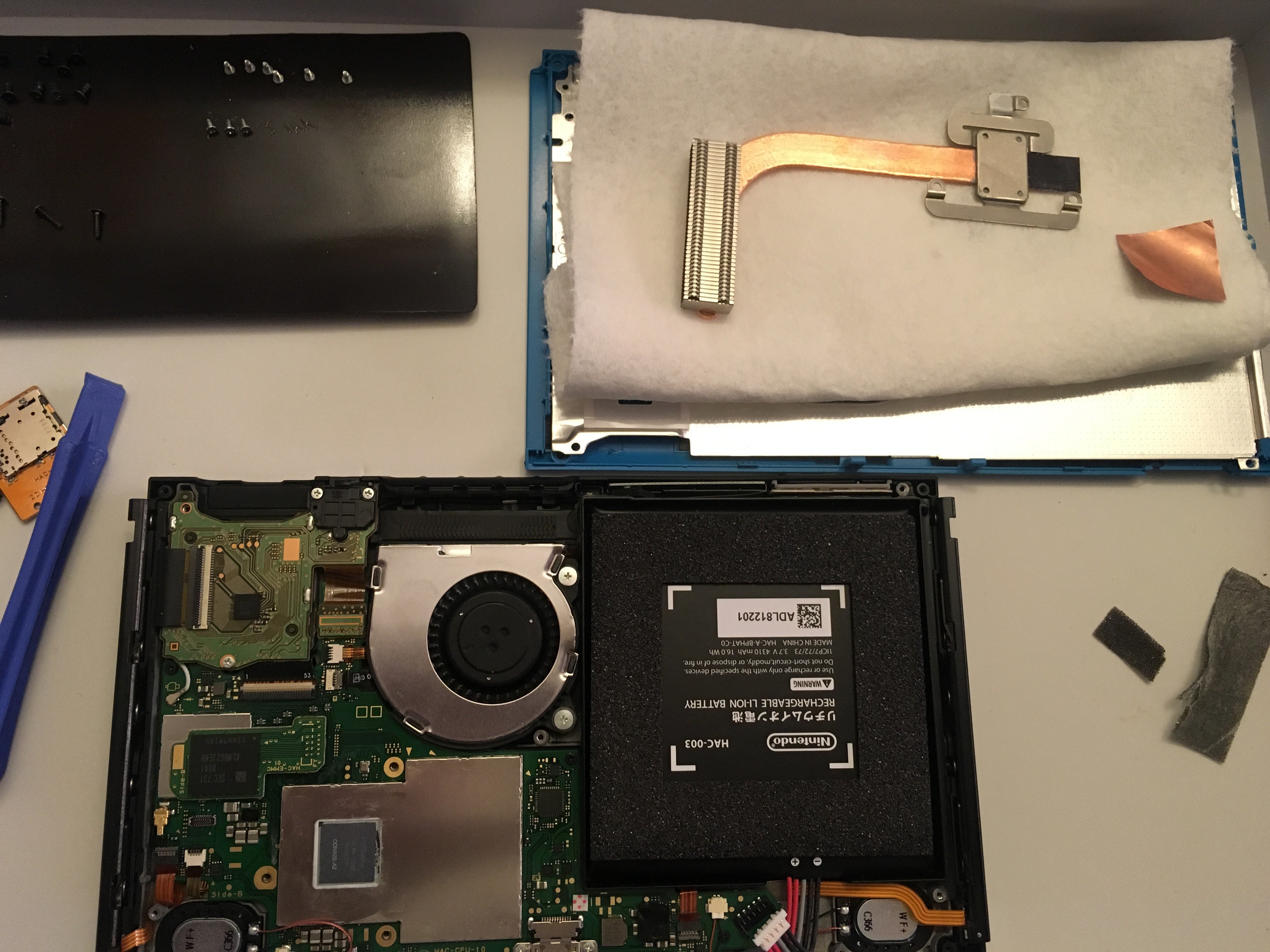

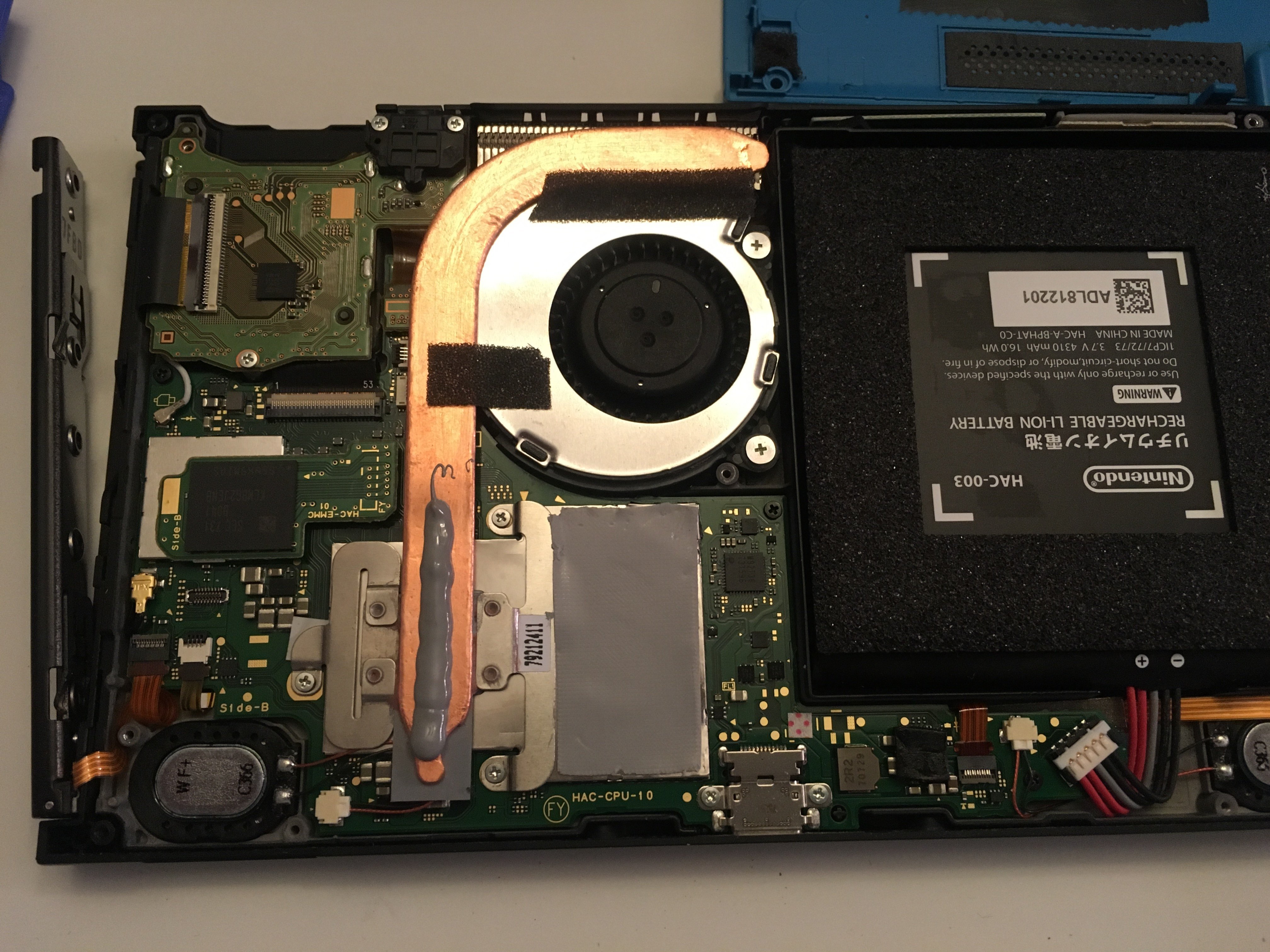

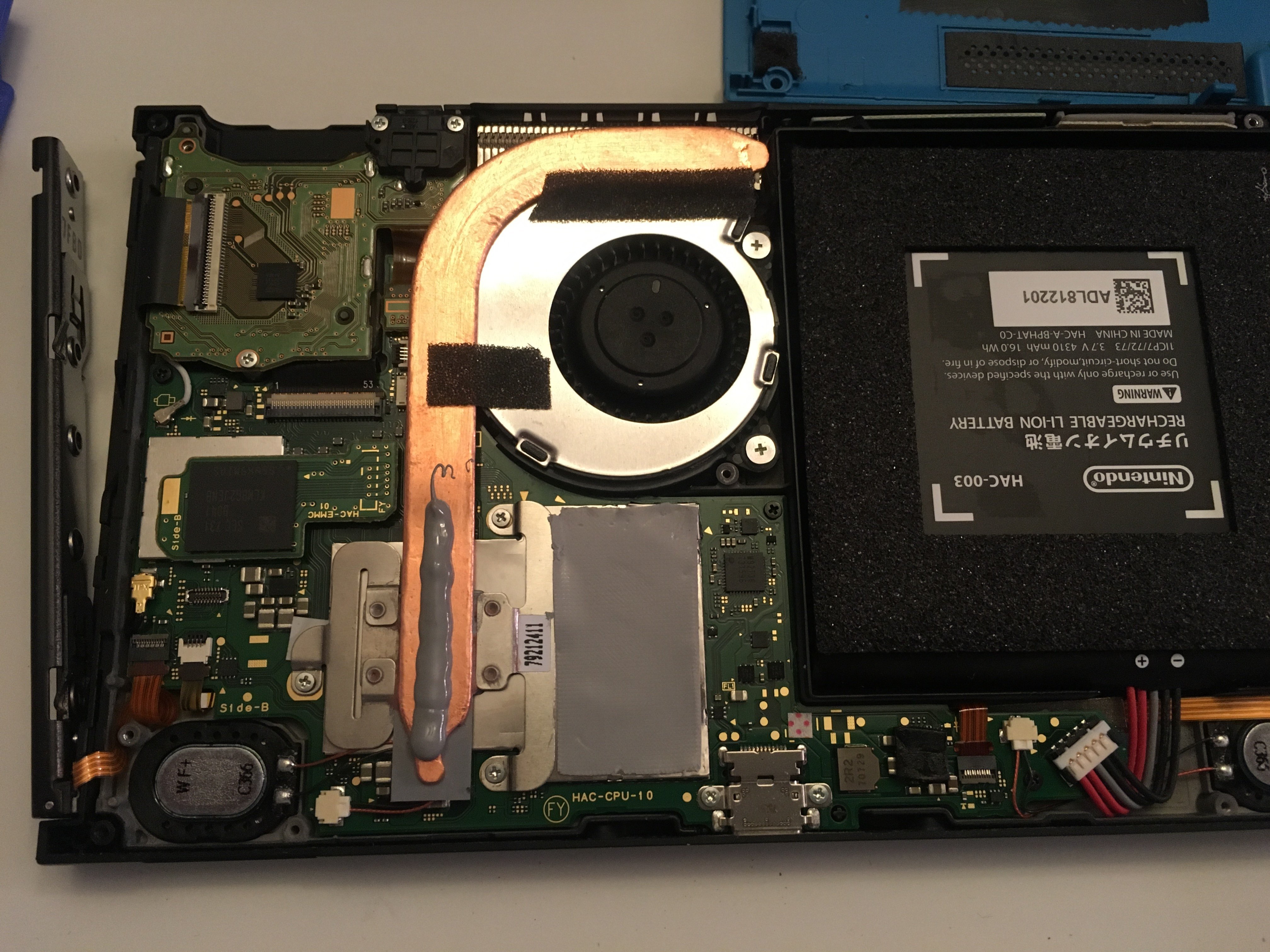

which part did you remove entirely?
kuGkQTMR6atCWRKt
also, going by the pictures, the paste on top of the heatpipe seems to be on pretty thick. did you replace it with an equal amount of paste? a pad?

Some notes on my project:
I put Acrylic Conformal Coating all around the board where I put the liquid metal.
I did not put the copper shim back so that the heat sink has direct contact with liquid metal between. I researched and could not find if the sink was/has aluminum. I have an extra torn up switch I can use as parts, and you can buy switch parts on line so I took the risk. I was nervous about how "open" the liquid metal was so I may have erred on the side of using too little liquid metal. I basically thinly painted the SoC and the sink.
I am currently running a very unscientific test to see if there is a noticeable difference between a modded and unmodded switch.
