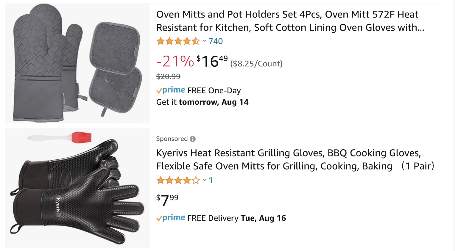

Back to the point of helping this guy out:

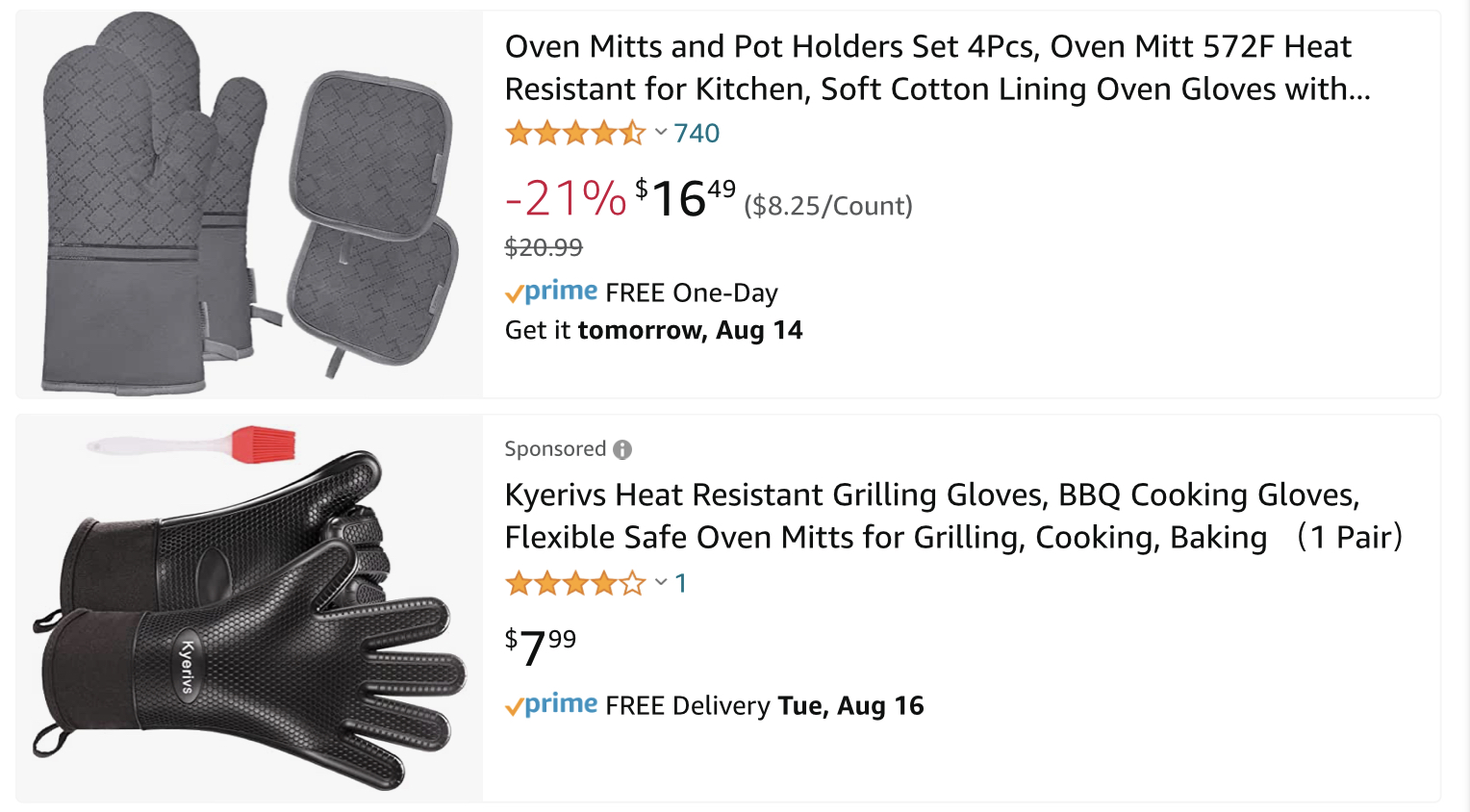

Do you believe the initial requestor should be alarmed about his Switch hitting 47C and roasting his hands?
e: I was initially going to recommend the mittens because I thought just having the mobility of opposable thumbs would be enough for most games but after further review I’m thinking a BBQ glove with individually mobile digits could be in order. At under 1/2 the price it seems a no brainer. I could be way off base here. What are your thoughts?

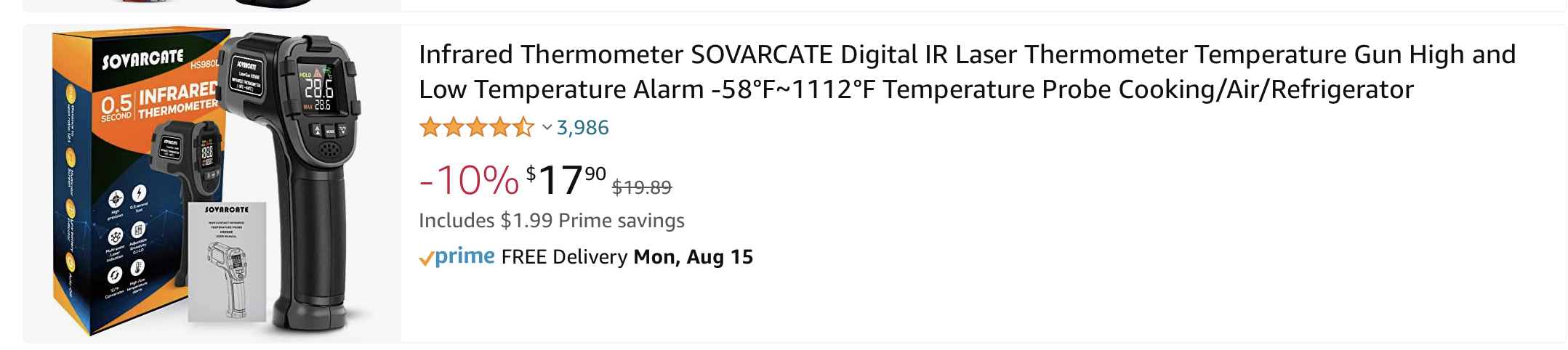

The shield temp and back shell cover are certainly not being measured, but you could easily do so.
I invested in a thermometer with a thermocouple some time ago for testing things like this.
You could also buy one of these (I have one for my hvac but I don’t think I ordered it from Amazon) but it looks something like this:
Next time you buy thermal paste, throw one of these in your cart. They‘re pretty inexpensive.
