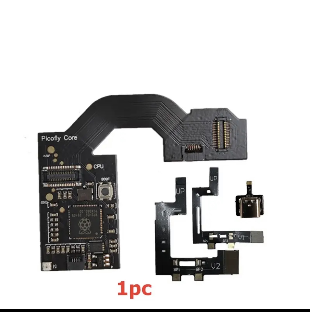

Hi all,
there's this Patched V1 I recently modded via one of those hybrid picofly/hwfly chinese chips you can find on aliexpress.
Definitely not the first I've done, but surely the first to give me such a headache,
EmuNAND has absolutely no issue at all. On the other SysNAND, both stock and with Atmosphere, gives me the error 2002 - 3540 after like 20 minutes of playing.
This, of course, led me to think that there's some kind of problem with the eMMC itself. But what could it be?
I can safely backup without errors and the infos in Hekate look just fine (picture at the bottom).
Am I missing something?
Is it possible that che chip just sucks and does something weird but ONLY in Sysnand? Or that I didn't insulate the eMMC properly and it's touching somewhere, causing this error?
Help, lol

How interesting, considering I also used one of those chips on aliexpress and failed to mention it. The official hyfly couldn't ship to my location :(. Kinda a weird error for a hardware issue tho
This is the same old resistor issue as always. The chinese clone boards were produced before we figured out that 100 ohm for dat0/cmd was more likely to work well than 47 ohm, so all chinese clone boards are made with 47 ohm. You need to either replace the resistors connected to your C and A points with 100 ohm ones, or add extra 47 ohm resistors between the C and A points on your chip and the respective points on the motherboard.
Edit: since this is a V1 where I assume you're using the emmc snap-in connector, you'll need to replace the dat0/cmd resistors on the chip

Yeah I thought that could be a possible issue, so I ordered a bunch of resistors and a good old RP2040-Zero. In about 10 days we'll see if an install with 94ohm on those two lines fixes the problem.

Anyway, I installed regular picofly on a rp2040 zero with 100ohm resistors on the D0 and CMD lines and I can confirm that now it is working flawlessly. No more error codes even after a quite long test

I'm glad that the issue was solved btw where did you get your resistors? I'd like to try this myself
Standard 805 SMD resistors from aliexpress. But I guess you could try your luck in a different shop, maybe even a local one.
Mind that I also changed the chip and I'm not using the picofly clone anymore.
If you still want to use that one, you'll need to get much smaller resistors and swap them with the 50 ohm ones that are installed on the board.
I honestly suggest to just get a rp2040, though

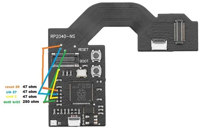

Could you tell me which resistors need replacing? This is my current setup. I already found the clk to have a 0 ohm resistor and replaced it with a 47 ohm one. Do I just replace the dat0 resistor with 100 ohm?
