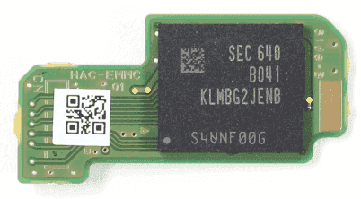

I've seen a failed eMMC module where one of the via corroded causing the 1.8v memory controller voltage to not reach the memory chip. Did you try checking the voltages on the chip to make sure it's getting power. There should be continuity between the yellow points and it should be 1.8v when powered on. If it's not, you could try running a jumper wire to see if you can get the data off it and then replace the module.
