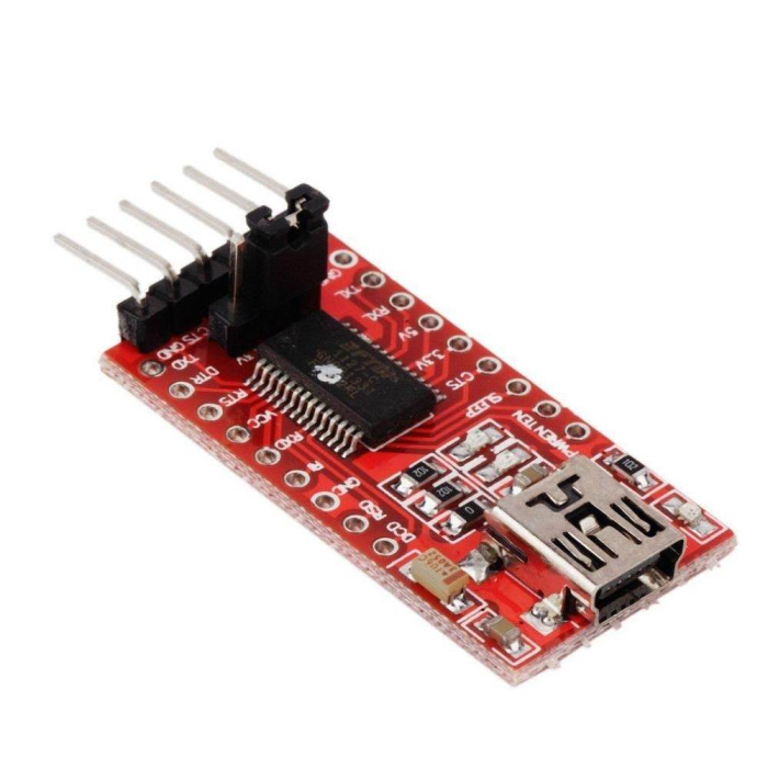

Or you can use a ft232h to write to boot0/1 backup to the emmc.
That would be the hard way, 3 times to unsoldering, 2 times raball. Most of the time these emmc cant even handle 1 reball. Also i think i will use V1 switch for flashing full disk image via hekate, but again, alot of hot air desoldering. So I guess thats the way. Why pico is unable to glitch in easy way is a mistery.
Again you can use a ft232h to write your image to your emmc. It's not necessary to desolder the emmc.
Connect dat0, cmd and clk to ft232h power on your switch and you should be able to write the backup to it.

3. Use ft232h programmer as it is stated post before. No need to desolder emmc as it can flash on board.

actually.. ft232h is very cheap right here too, ill try this one first
Edit to avoid spam:
ill need the emmc adapter? the big black box that was shown up on the arab video? or can i do this only whit a FT323h adapter? here in brazil we have this one FT323RI someone can tell me if can i do whit this little board instead the 323h?:

As evil_santa stated before:
"you can use a ft232h to write your image to your emmc. It's not necessary to desolder the emmc.
Connect dat0, cmd and clk to ft232h, power on your switch and you should be able to write the boot0/boot1 bin files".
That black box is used for friction contact, as it pushes down on emmc to create contact, so you dont need to solder emmc.
Just connect coresponding wires. If 323RI will work is up to you and your knowladge.

So if i got this right....
You just buy an ft232h. You simply add 3 10k resistors:
clk=ad0 10k to gnd
cmd=ad1 and dat0=ad2 both 10k to 3.3v
power on switch in order for the nand to have power and you can read write boot0/boot1 sectors,using that postal3 program, on "oled models" blank 64gb nands?

Hello man, my ft232h arrived a few time back, but it's only now that I've been able to try to solve the problem.
Thats what happened, conected clk dat0 and cmd but i dont soldered the 10k resistors, is it needed to the program works?
In theory it should. But if everything works as intended and working new emmc is soldered perfectly, just not yet written, in other words blank, picofly or hwfly can and will boot to hekate for easier flashing.
continuating the message, i removed the entire picofly and tried to open the emmc on the program but only showed an error, think thats caused by the missing 10k resistors, ill try tomorrow and come back here
att.
Even whit resistors i cant read the emmc
