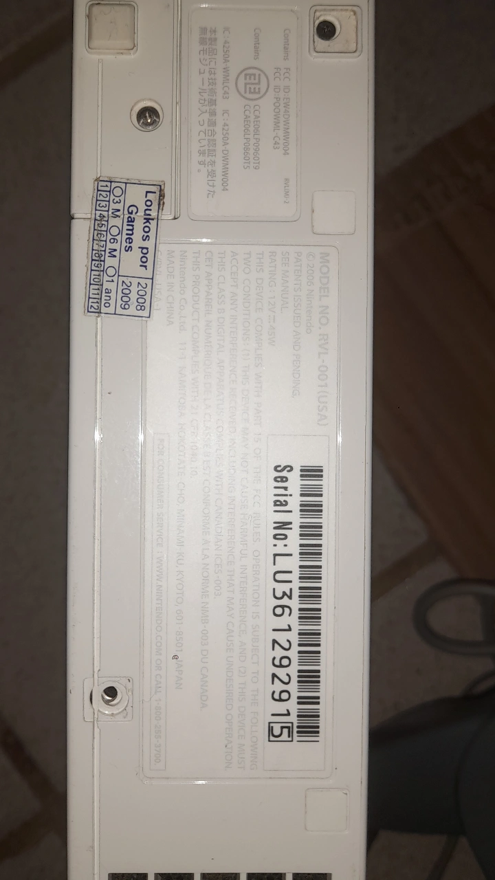

If not even an ohnescwanzenegger revirginize solves the problem, it is a hardware issue (most likely NAND failure)
Buy another Wii.
Reactions: LittleBrye
Buy another Wii.
Would you be willing to clarify how you came to this conclusion? ohnescwanzenegger would have resolved OP's issue if they were following a proper install guide afterwards. If they were following a misleading/outdated/bad guide though, encountering the same issues seems like a likely outcome.
If OP had said that they followed wii.hacks.guide step-by-step and used ModMii on their second pass, I'd be inclined to say that something other than misconfiguration could be at fault. Without that, I have a hard time jumping straight to hardware issues. If there's something obvious that I'm missing though, feel free to let me know.
Reactions: LittleBrye and Aep
The Wii also has been opened before, they have showed me pictured of the console. You can clearly see it is not only missing screw stickers, but the screws themselves.
I walked them through the process exactly how I do it on my Wiis. I even had them perform an official online system update which should download the files properly from Nintendo.
We have had this issue on multiple Wiis in the past, me and XFlak confirmed this is definitely a hardware issue.
