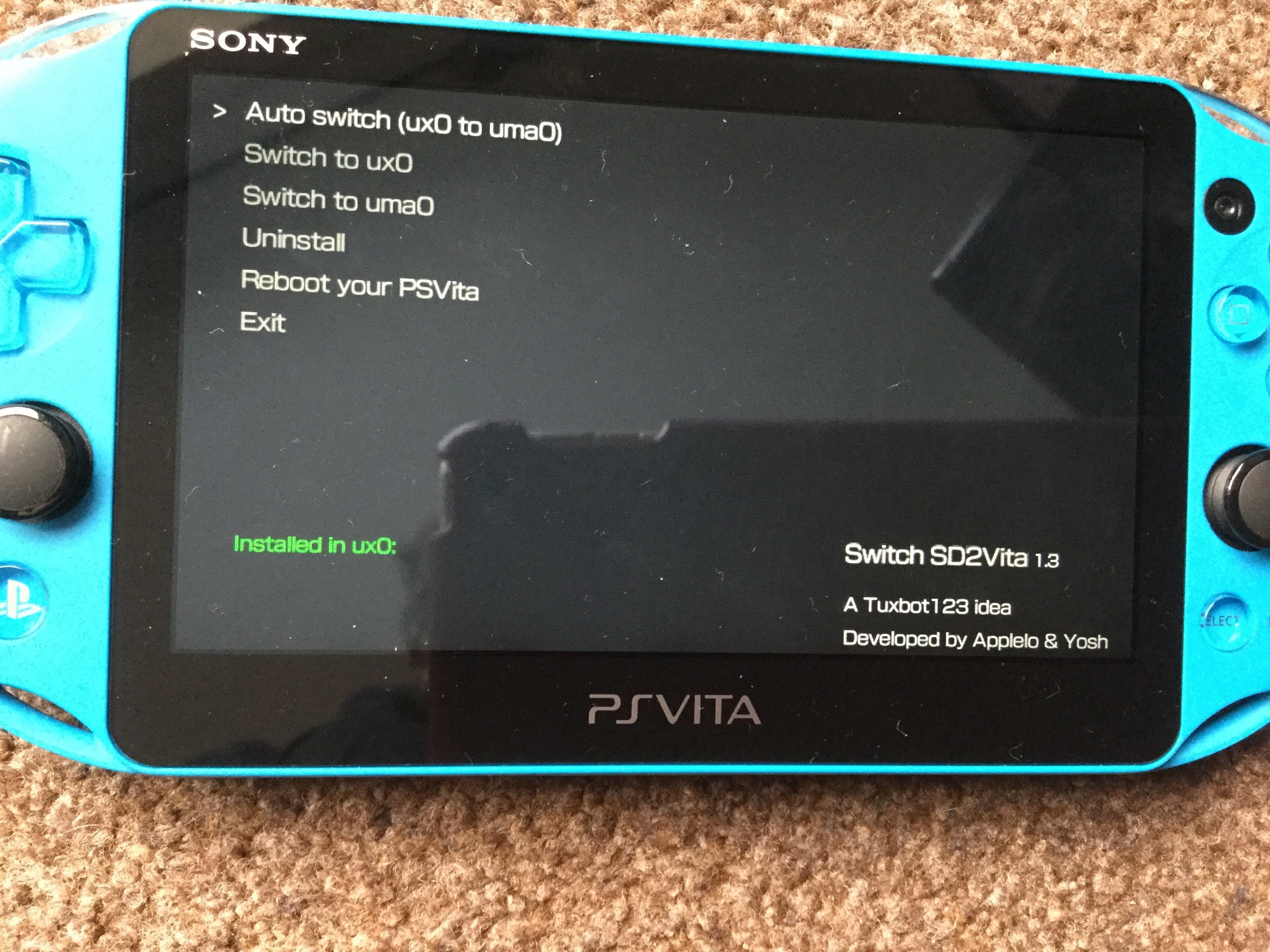

Unless it is something to do with the sd2vita 1.2 app I downloaded. when I go in there it looks like this
I installled Vitashell 1.9 and sd2vita switch 1.3. on the ux0 folder. I then ran switch sd2vita and selected switch to ux0 but it still booted with the enso sign and then tuned off again :(

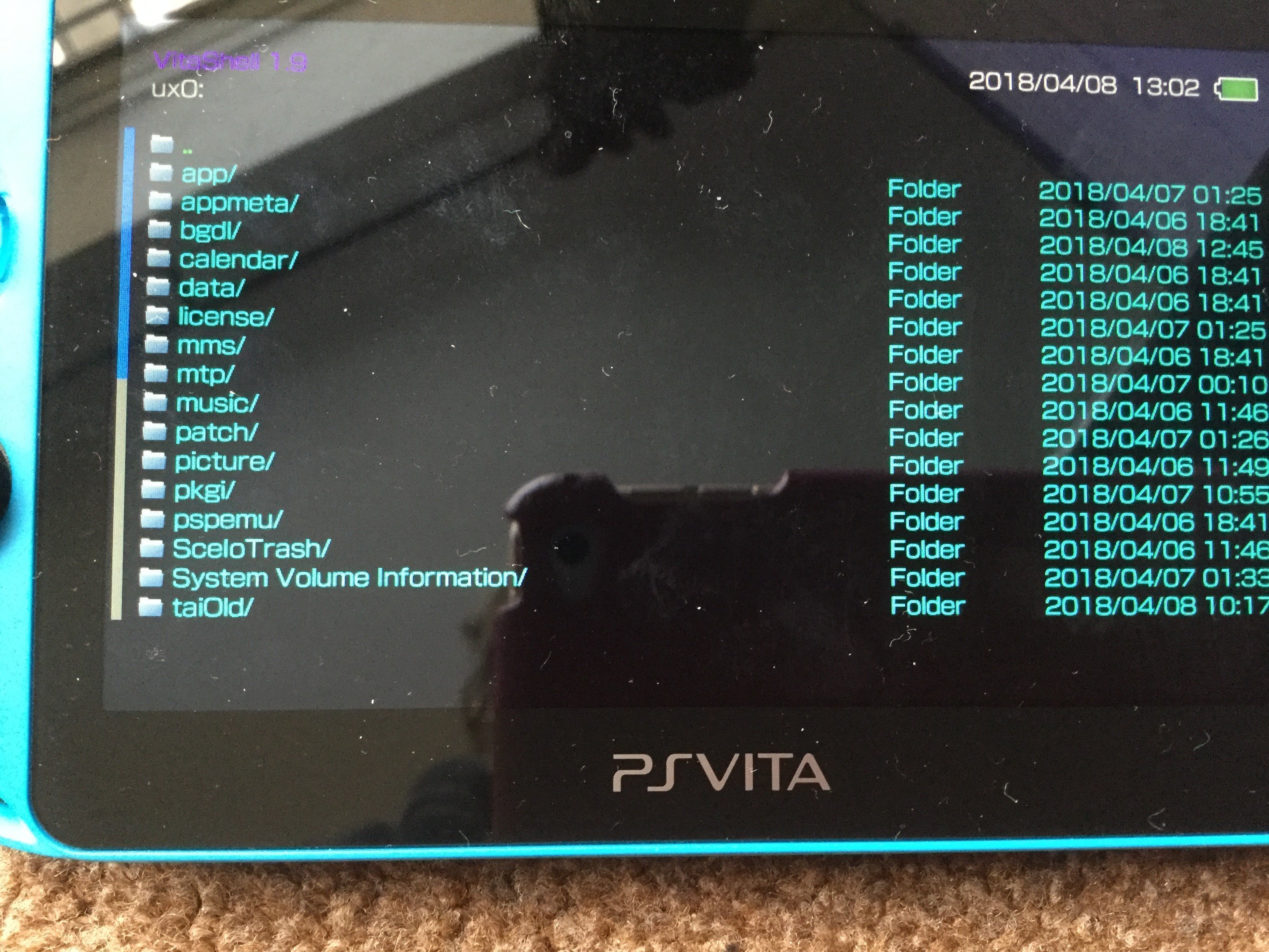

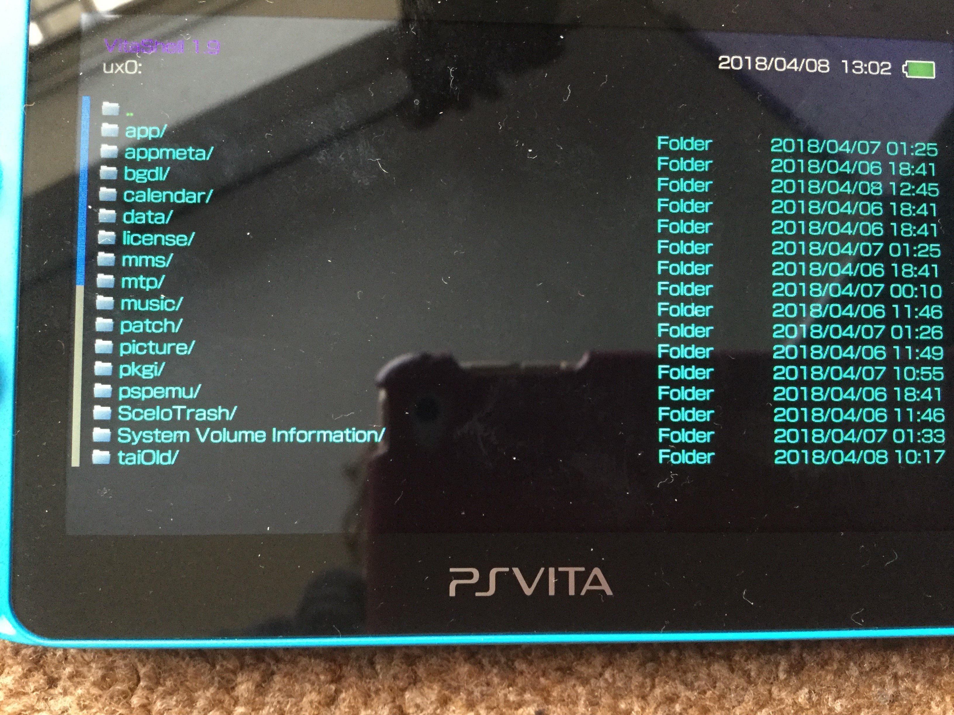

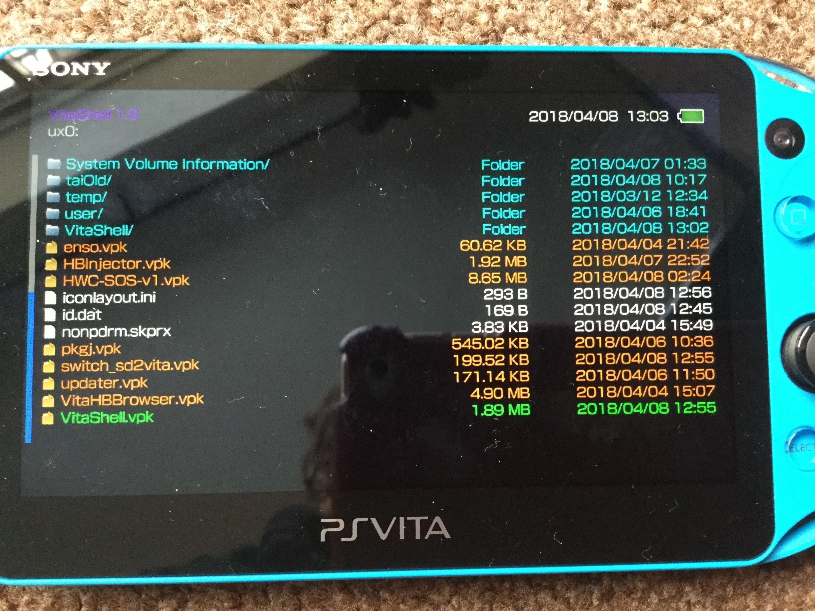

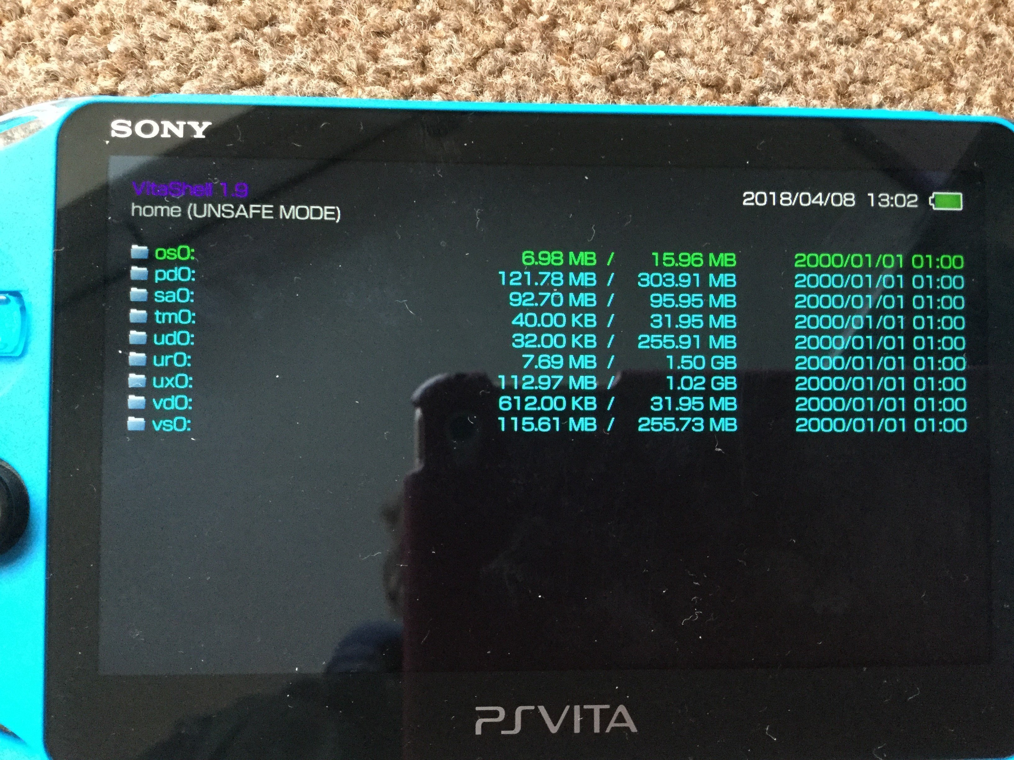

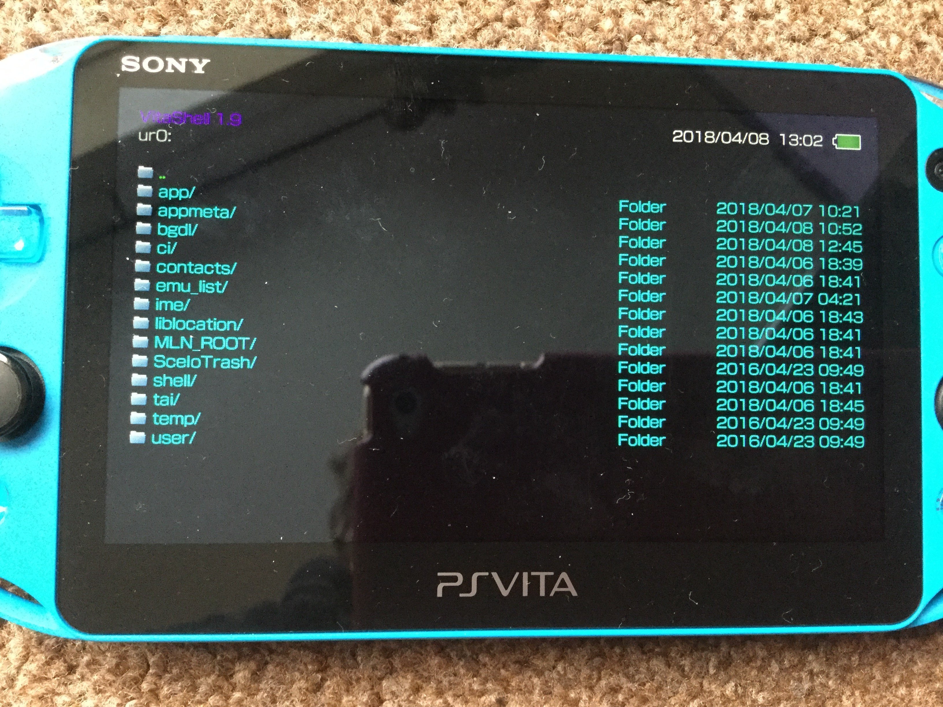

This is the current file situation....
okay boot your vita with holding L button then run vitashell, on ux0 folder you must see tai and taiOld folders, just delete tai folder and restart your vita, it will probably works fine, and if you only see tai folder, just rename it as taiOld and restart
Theres no tai folder in there, there is a taiOld though, did you see the thumbnail images in my last post? are they of any help?

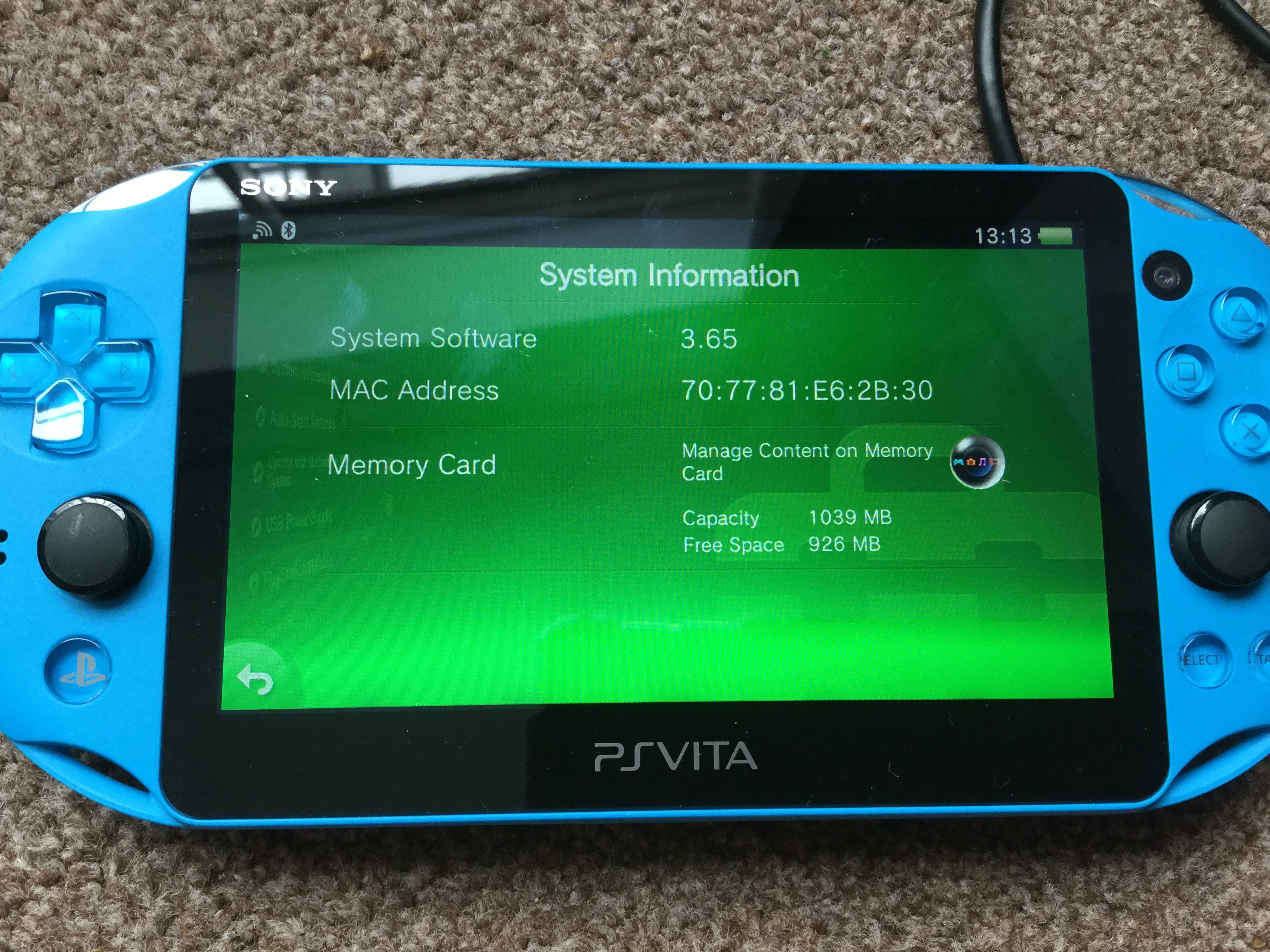

This is the latest system info too, just in case it helps.

looking normal, did you prepare your sd card properly for vita, for now put a # on beginning of ur0/tai.... Line, that will disable plugin and your vita will start normal, and you should check your sd card

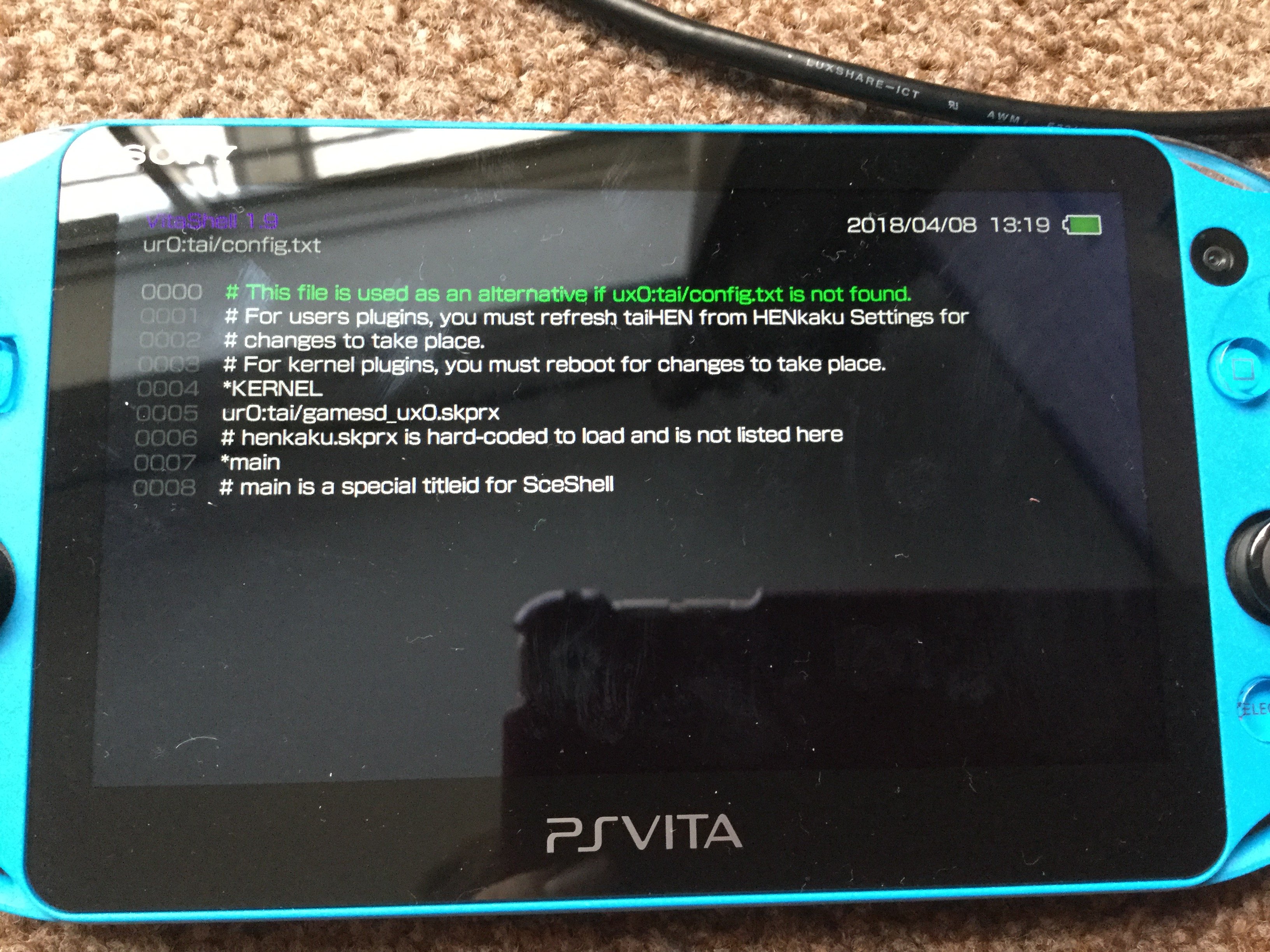

Your config text looks incomplete it is missing all the line under *main that it normally supposed to have.
Do you know which lines are missing mate? Much appreciated.

Here is screen shot of my config text, I am using storagemgr because I have a PSVSD.
Thanks, much appreciated.
Do you know how I would get the rest of that config? My head is spinning with this thing. I'm on the verge of selling and buying another one and starting again!

Assuming you are using SD2Vita only , and no PSVSD, this gamesd.skprx build was build by the Fl0w, the developer behind vita cfw. You can try this gamesd.skprx
https://github.com/xyzz/gamecard-microsd/releases
In term of config text, I think you should have the config text running off ux0, instead of ur0 or imc0. In my PS TV case I have mine running off ux0, I believe. I guess just put config text in all three area, correct location should be ux0, I guess, because if there isnt a config text in ux0 , then it will run it off ur0.

I have just replaced the config file with yours and it booted up without black screening on me, so that's good news. But there is no recognition of my sd2vita, i have a new one coming tomorrow. I'm hoping that's all it is. I noticed in your config file that it mentions storage manager, does it matter that I haven't used that?

Right, I think I have taken it as far as it will go. i have your config file in there and it is booting up but the 3.65 system firmware that shows is just the usual and not the henkaku version. I honestly have no clue what to do now so i think I will just restore the factory settings and sell it as 3.67. then purchase another slim and hope for the best. i'm gutted but I have tried everything and I'm just beat!!
