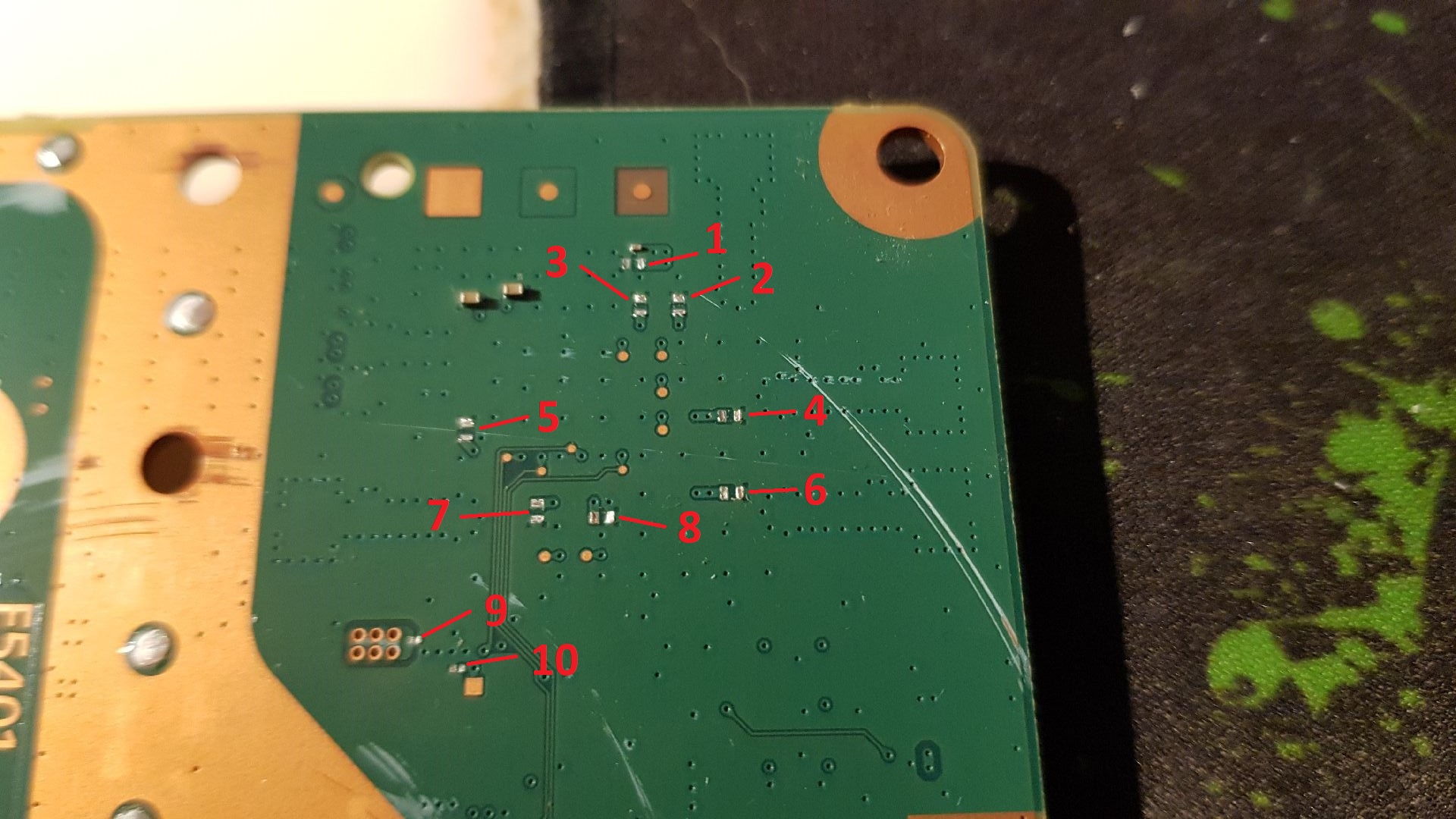

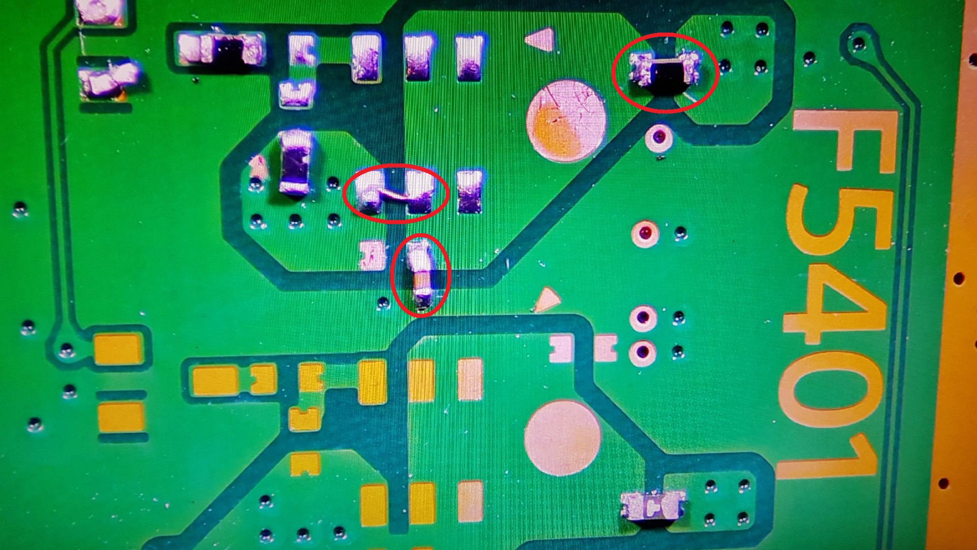

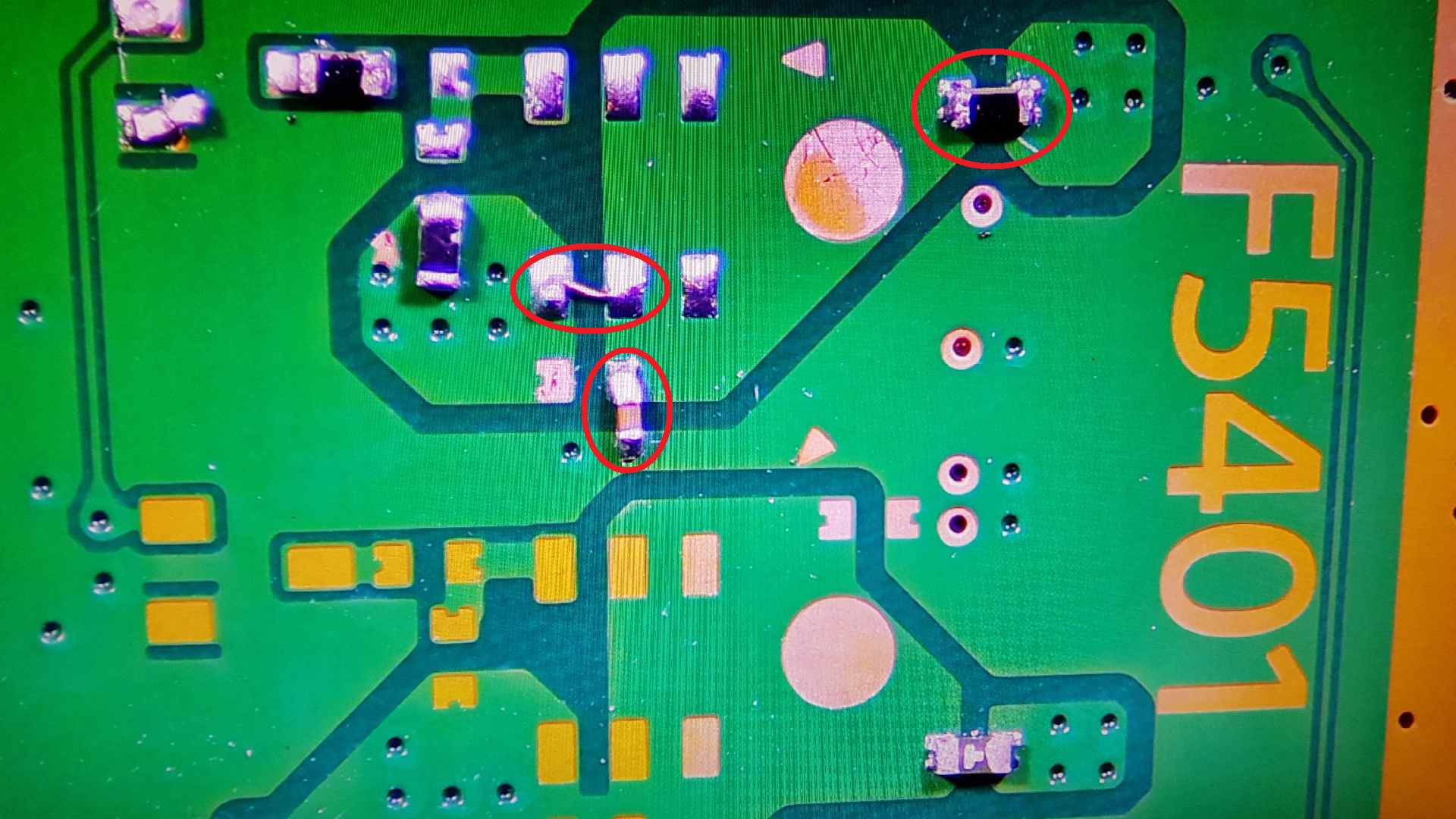

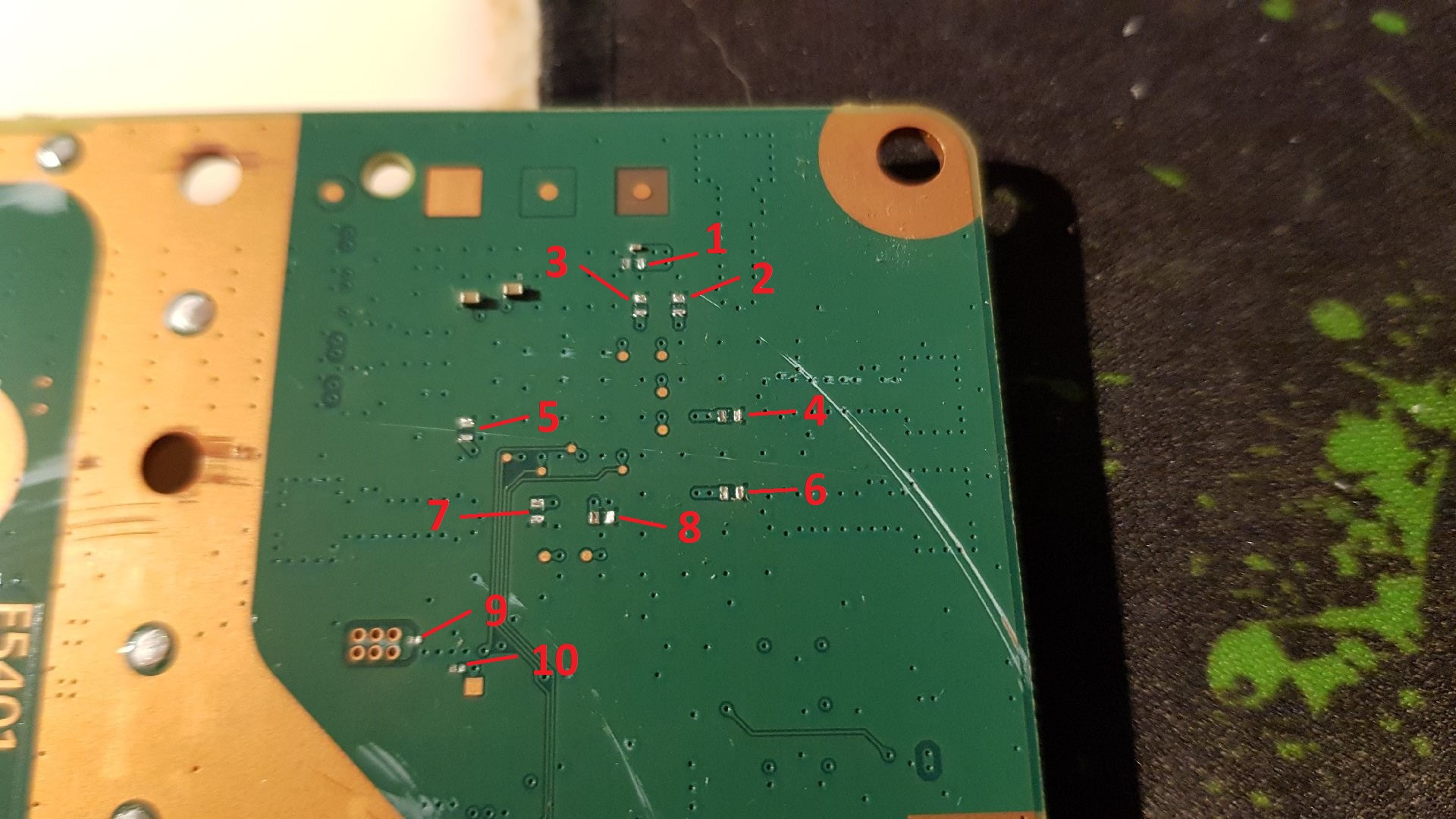

Hello, I bought a broken PS5 with many missing components, broken disc drive and update error (su-101312-8)
I fix the disc drive with a piece of wire, 0201 100nF cap, nintendo switch fuse, disc drive and update works
because I can't find the right components
PS5 works good but if the ps5 is off for a longer time I always get a blue light of death and it has to start in safe mode
Can anyone help me with the right components
Thanks
View attachment 418760View attachment 418761
Thanks
This should give you one of them I hope :-
https://gbatemp.net/threads/need-ca...r-digital-edition-edm-020-f5401-f5402.638865/

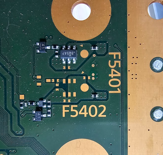

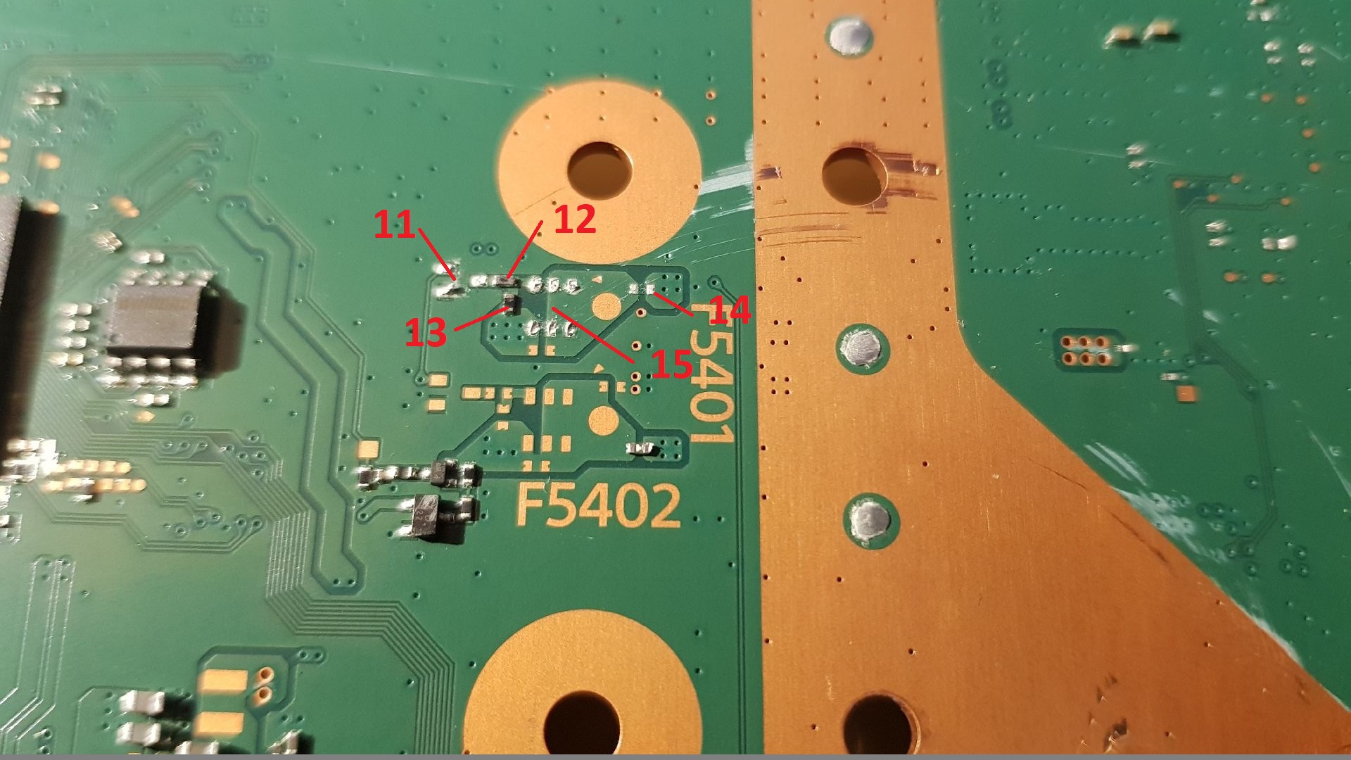

Remove your jumper cable on that SOT236 PAD and see if you still have BLOD
those 10 caps is just filter/decoupling caps for the wifi chip. Wont lead to BLOD without them

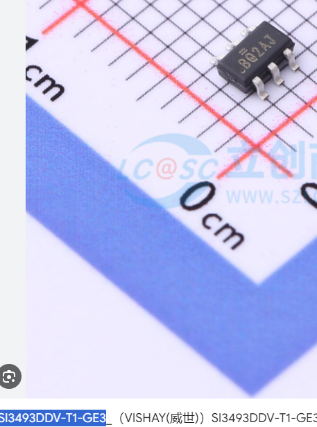

I guess that No.15 missing chip maybe SI3493DDV-T1-GE3, 90% sure

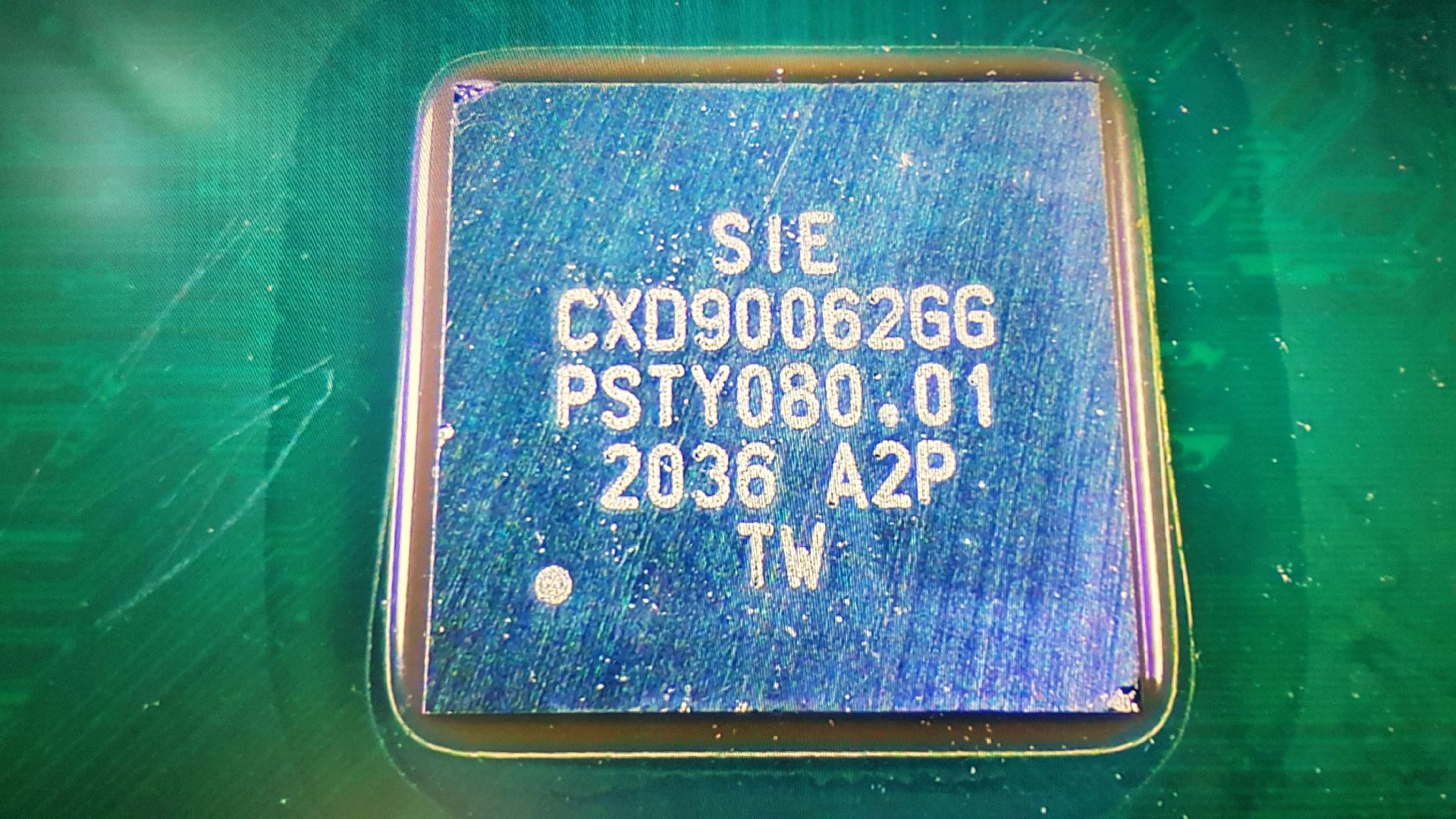

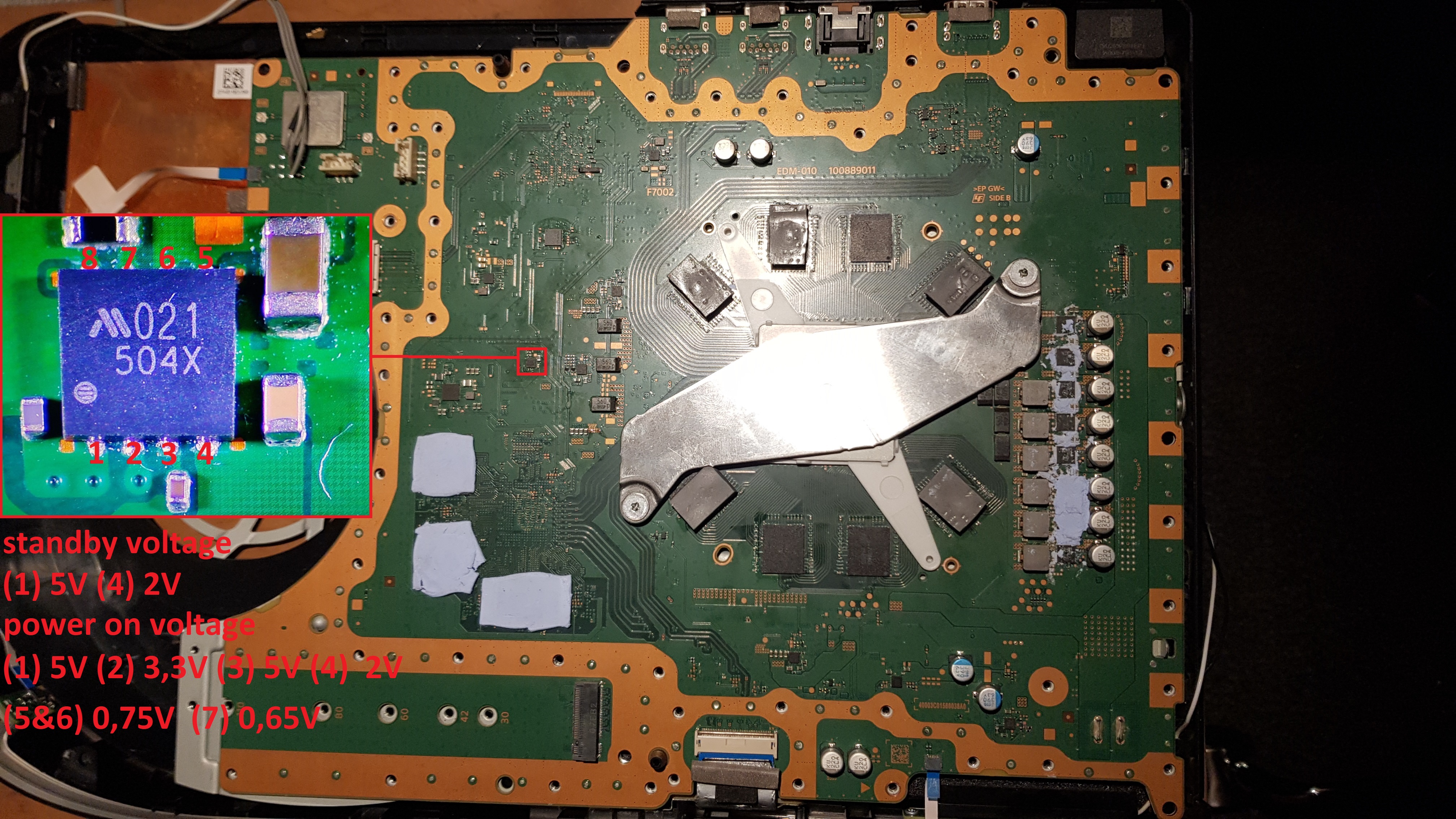

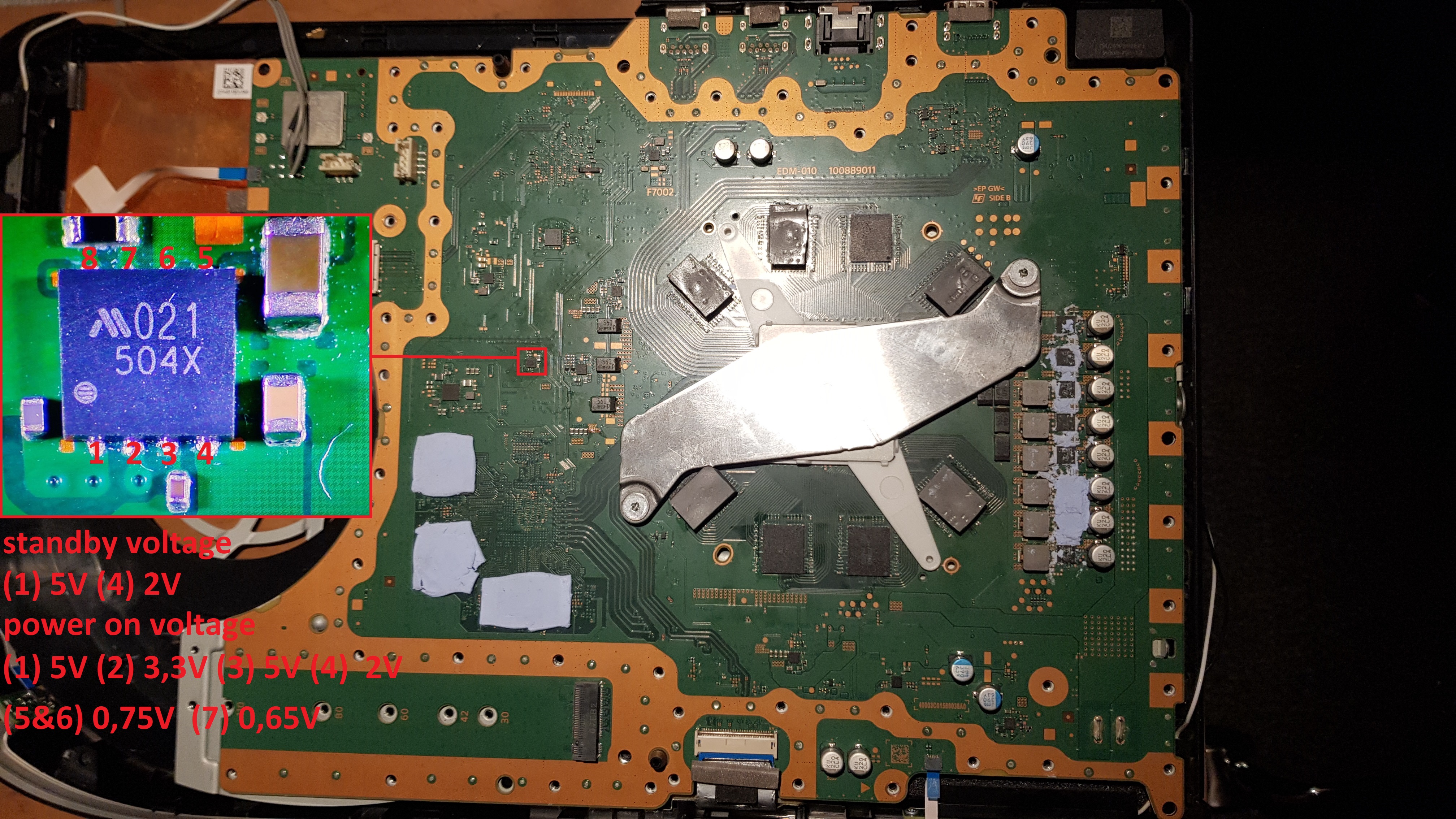

I think I found the problem
The M021 504X chip gets very hot and can burn fingers
I'm not sure, but it looks like the chip is cracked
Can anyone tell me where I can buy this chip
Error Description
long blue light of death
ps5 error code ce-108262-9
PS5 UART error code 80800000 Kernel Panic Shutdown
get RT9048A instead
