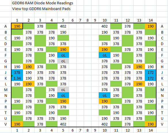

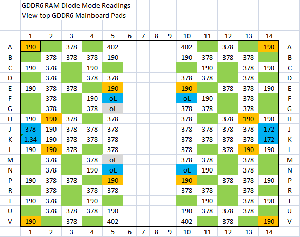

Hello Everyone, thanks to @stetofix i did an analysis on RAM pad.. some wrong value... so i did a full reball of the ram chip and a REFLOW of the APU, it start working perfectly :)
first of that @alex1kgr please check all other common cause ( Fuse, voltage line, short on common capacitor, thermal test). if all of that are ok you can try to check value under the ram pad and if it is wrong proceed with apu reflow (that was my path)
