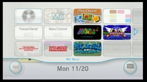

Thanks for the reply,
I can get to the homebrew channel from bootmi.
I can put a game in the disc slot and it doesn't do anything.
I can download the emulators from the hombrew browser, then install but can't get to the channel page to launch the channel.
I posted an image of the channel page im referring to. ( my wii doesnt load that up anymore)

You should be able to reinstall a working system menu and all the correct and up to date IOS and cIOS using modmii, it will download everything you need to do so and set up your sd card for you ready to go. I also suggest that you might as well update to 4.3 at the same time, just tell modmii when it asks what firmware you want to be on.
