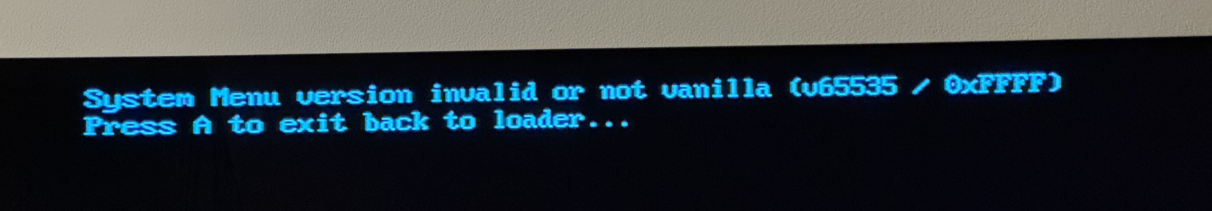

Old Wii cannot install Priiloader: "System Menu version invalid or not vanilla (v65535 / 0xFFFF)"
  • Thread starter Thread starter hillcow
  • Views Views 5,349
  • Replies Replies 15
hillcow
Jun 17, 2024
17
6
68
Germany
I cannot get around this error and hope to find an expert here on the board. I will shortly explain what state my Wii was in, what I already did and tried, and what state it is in now.
I modded my Wii ages ago and decided to fire it up again and update all the tools. I followed https://wii.hacks.guide/ to re-install the homebrew channel (update it). Also took a NAND backup. However, when I started the Priiloader Installer, after a few seconds I got this message:

Someone on another forum suggested the mistake was having this old, German mod of Priiloader installed: Priiloader v0.6(beta v2) (German Mod: BöhserOnkel)
So I uninstalled it. But the error was still there. Currently I do not have any Priiloader installed on my system. I guess I could probably install an older version from back then without any errors.
ModMii
I proceeded to follow the ModMii guide "ModMii Wizard" completely, in order to update my system. I stayed on 4.1E, but updated everything else from the guide. But that didn't do it either. Still the same error.
hacks.guide/cios
In a last attempt I followed the guide from https://wii.hacks.guide/cios to update cios according to their docs. Didn't help either. Priiloader still fails with the same error.
So I ended up with this setup:

I don't know where to go from here? Install an old version of Priiloader and then attempt to update to 4.3E, since the error is about the system menu? But I don't want to lose any data from the Wii. Happy about any hints.

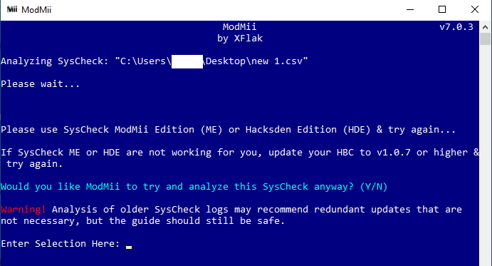

Drag and drop your syscheck.csv onto modmii.exe and it will tell you what to do. Alternatively run the main Modmii Wizard again and this time choose a different system menu version so it gets changed/updated
The issue is your system menu version is customized at 65535
Thank you!
1. I cannot use ModMii for my SysCheck, because the SysCheck that is working on my system is not the ModMii Edition.
Instead, I found this online tool with the following recommendations: https://syscheck.wii-homebrew.com/#!YTk3MDVlZmE4ODlm

2. What exactly does it mean that my system menu is "customized at 65535"? I'd like to understand.

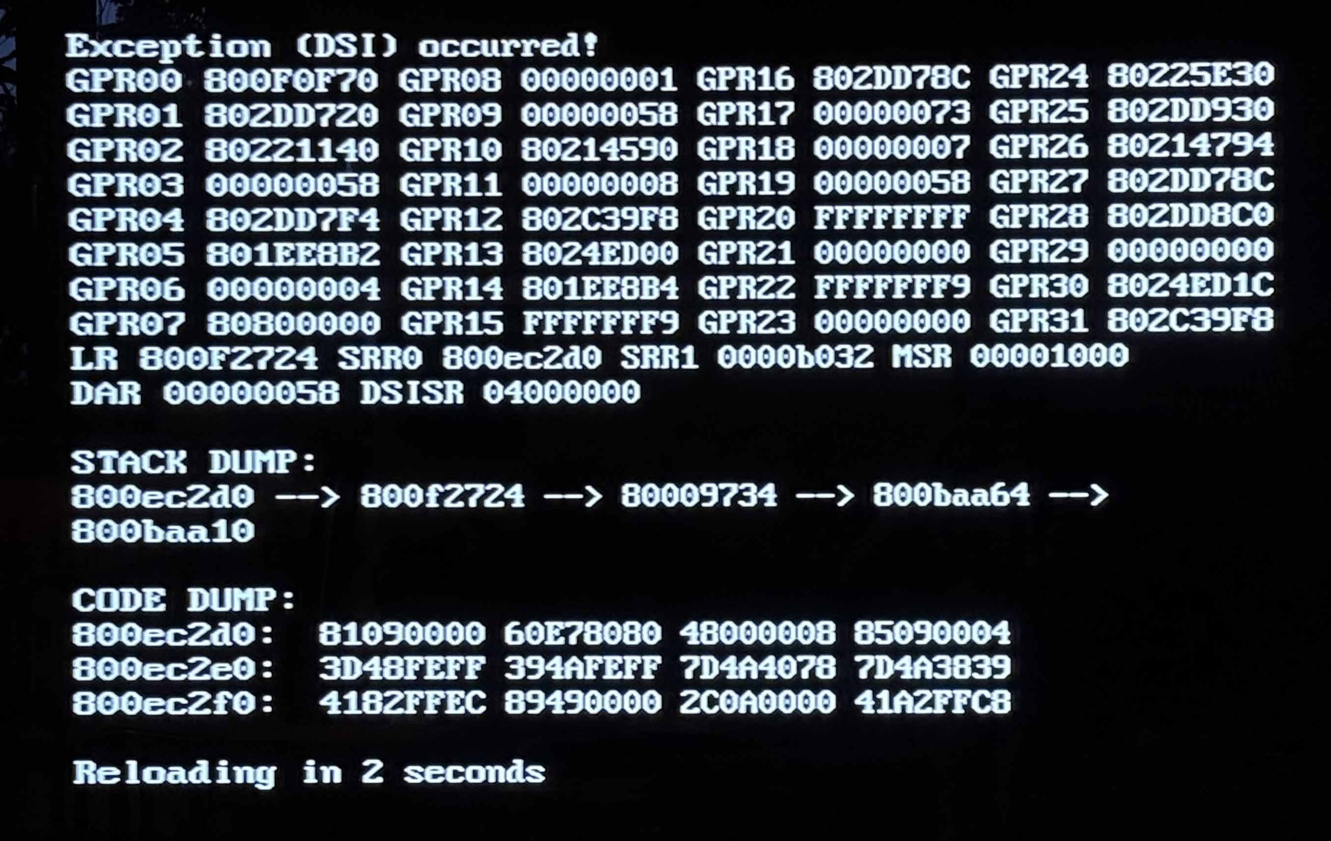

Is there an error log somewhere that you'd need? Because this doesn't look very useful to me.

Your homebrew channel is out of date likely causing the issue
You said you used the modmii wizard, but it doesn't look like you did in your syscheck.
If the syscheck was taken before following the main Modmii mizard guide, u should be able to run syscheck modmii edition now

I will look into updating the homebrew channel and try to run the modmii edition of syscheck again.
I did use the modmii wizard, but I followed the guide https://wii.hacks.guide/cios afterwards.

In the meantime if you edit your syscheck.csv in notepad and change "sysCheck v2.1.0b5" to "SysCheck ME" ModMii will proceed to analyze it for you. It will recommend some redundant steps that you have already done but it is still safe to follow (i.e. it will tell you to install HBC v1.1.2 or v1.1.5, system menu IOSs and cIOSs that you already have installed like in slots 11,20,30,40,50,52,60,70,80,248,249,250,251). If you choose to do this, you can first disable ModMii's extra brick protection option in order to reduce the redundant recommendations. Optionally re-enable this afterwards.
Ultimately all you need to do is install a stock 4.1E, 4.2E or 4.3E (i.e. version should not be 65535); you already have unstubbed system menu IOSs installed to slots 60/70/80 otherwise that would be necessary as well to avoid brick. Once this is done, the Priiloader Installer will work.

I'm on 4.1E. When I tell the modmii wizard I want 4.1E it doesn't overwrite it, though. So the system menu stays at v65535. How can I install a "clean" system menu without upgrading to 4.2E/4.3E? And do I lose any data doing so?
I changed the syscheck.cv like you described. The suggestions from modmii include upgrading to 4.3E:
The update for your beta is nice, however, it looks like the version of the homebrew channel is not the reason why syscheck modmii edition is not working on my console.
yes that's right, I'm not sure what's causing your issue with syscheck... hmmm, do you mind testing some stuff for me? Specifically, open up apps\SysCheckME\meta.xml in notepad and change "--forceNoAHBPROT=false" to "--forceNoAHBPROT=true". If that doesn't work try erasing the line with "<no_ios_reload/>", and if that doesn't work, try erasing or renaming the meta.xml file entirely.
The version of syscheck you got working does not have ahbprot\no-ios-reload arguments so I suspect it's one of these things that are causing the issue.
Does SysCheck HDE (Hacksden Edition) fail for you also? https://github.com/modmii/modmii.github.io/raw/master/temp/SysCheckHDE.zip
Also, can you clarify when SysCheckME fails? Does it fail immediately or after telling it to run the syscheck?
Back to your specific issue, it's safe to follow the steps to install 4.2E or 4.3E, you won't lose anything
edit: also perhaps you can test if this version works? I suspect it will fail as it too required ahbprot\no-ios-reload arguments
https://github.com/modmii/modmii.github.io/raw/master/temp/syscheckb19.zip

--forceNoAHBPROT=true: FAILS
erased <no_ios_reload/>: FAILS
erased meta.xml: FAILS
ModMii edition always fails at the end of running through the ioses, which is why I tested this by selecting only ios3 (fails faster then). Maybe something doesn't work when trying to access/write to the SD card?
SysCheck HDE (Hacksden Edition): runs through, but then fails when confirming to show the results by clicking A.

So Hacksden Edition syscheck file fails in modmii wizard due to region. syscheckb19 works fine though and has a different outcome. This time it suggests re-installing 4.1E:

Should I proceed with this guide re-installing 4.1E .wad and the suggested stub IOSs? Here is the generated guide:

Or would you suggest following the previous generated guide instead to install 4.3E?
Can you share the 2 syschecks from HDE and b19?
When you say HDE fails in modmii due to region, what do you mean? Is it saying you have a region mismatch and should proceed to use the region change wizard to "change" to your current region?
Installing 4.1 is safe so long as you have IOS60 (unstubbed) installed, which you should (and if you don't yawmme should prevent you from installing). Same goes for 4.3 except with IOS80 (and 4.2 with IOS70)
I already did here.
So which would you recommend?
Not sure how I missed that, thanks! so the HDE syscheck reports your system menu version as Systemmenue 4.1Ï (v65535), so it's detecting a mismatch, but in b19 it's reported as 4.1E which is aligned with your PAL region. Basically the analysis modmii is doing is correct based on the input provided.
Assuming your custom system menu didn't touch any other system files (likely since your region is still PAL), should be no need to do a region "change", but if you did it too should resolve your issue. Simply installing a stock 4.1E, 4.2E or 4.3E system menu should get everything up and running and allow the priiloader installer to run
There's really no substantial differences between 4.1-4.3; personally I'd give 4.2 a slight advantage just because bannerbomb v2 is a bit easier\faster to access than exploits on 4.1 or 4.3, but realistically this is done once and that's it anyway
After you install a stock system menu, can you check if syscheck ME starts working again for you? Perhaps something about your custom system menu version itself is causing the issue... in which case a nand backup from before installing a new version may be helpful in the future if we want to try and improve it... so perhaps start by making a nand backup if you haven't already
Reactions: hillcow
Thanks! I installed 4.1E as described in my previous comment.
Everything works now: Priiloader is installed, syscheck ModMii edition doesn't crash any longer.
