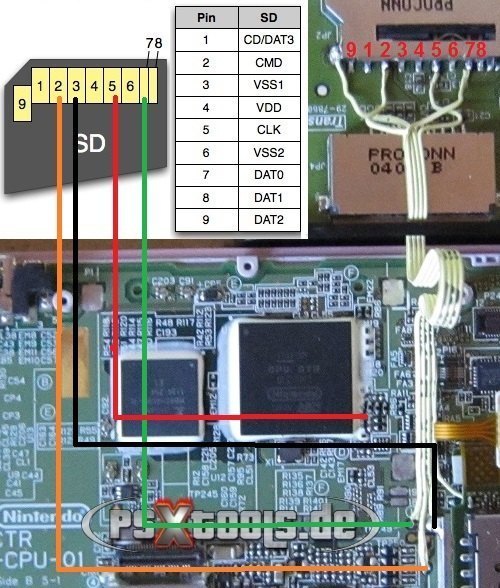

I have a non XL o3ds. So I was trying to do something I had done at least 10 times before (format emuNAND via Gateway launcher.dat) so it was working as expected until suddenly it stopped and shut down my 3ds. I tried to turn it back on but alas, I got nothing but a pitch black screen. The blue LED turned on but not even recovery mode would start. So I'm assuming I need to do a hardware mod, but I don't know what I'm actually supposed to be doing. I see stuff like: https://gbatemp.net/attachments/vrije-opmerking_20140126_123816_01-jpg.6106/ but I don't have a clue what that actually means and what I'm supposed to do with the other side of the wires or how I'm supposed to connect that to my Pi2. I have an RPi2 as well as a soldering kit, NAND backups and another o3ds on 4.5. Any help/links to tutorials on what I should do?

You have to solder and reflash your nand dump with win32diskimager.
alternative CLK (easier to solder but it's on the other side of the motherboard)

you won't need a raspberry pi to unbrick that's only for blue screen bricks (and i dont think the pi2 would work anyway, even the b+ wasnt compatible with the unbrick software)
anyways if your lucky you may have the rev2 motherboard which has a much easier CLK point, but you will need a nand backup.....and if you dont feel like risking doing it yourself you culd drop @hundshamer a PM
If you don't think you will be able to do it yourself, I recommend @hundshamer. They were very helpful and fast setting up a nand mod for my o3dsxl. Just a tip when you restore your nand backup, if you are using a laptop with a built in sd card reader, it might not work. I had to buy a usb sd card reader, and this allowed me to backup my nand. Good luck getting your 3DS unbricked!
