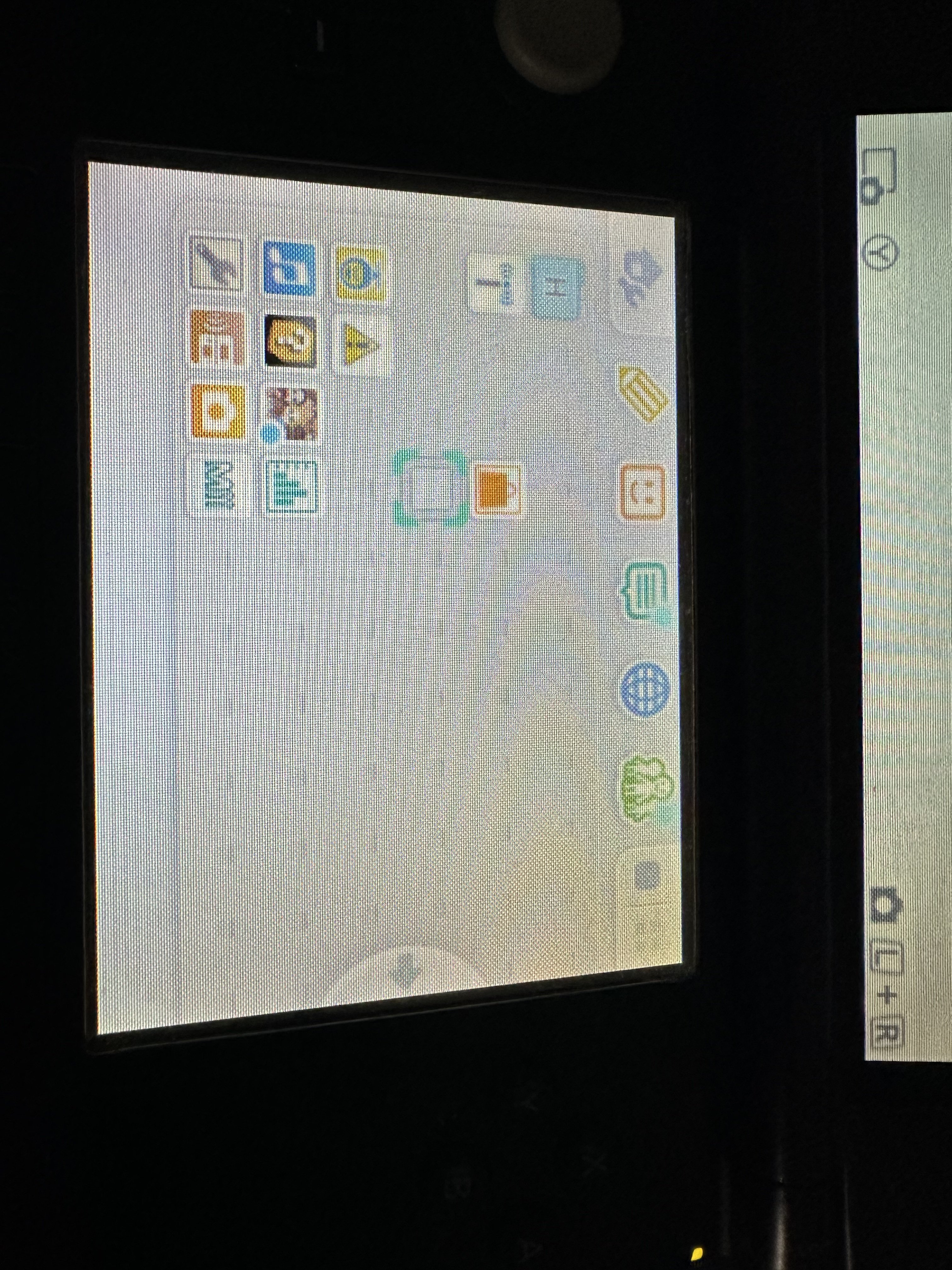

Just bought a old 3ds XL. The bottom screen is faded/heavy ghosting. Top screen tends to flicker some when loading a game. Bottom screen goes completely black for a bit while games load (sound for those games works fine while screens are both black). However, after playing for a bit the bottom screen reverted back to being fine, before fading again.
Any idea what the issue is? More specifically, is it the screen itself or the ribbon cable?

Facebook marketplace. It was $100 with 19 games (15 or so of which are first party). I have experience working on 3dses, Playstation 3s, and 360s so I assume I'd be able to fix the problem. Originally I was thinking the screen was the problem, but then my son played Smash Bros on it for a couple hours and the bottom screen was fine for the majority of his playing. So now I'm leaning more toward a ribbon cable issue. I do plan on opening it up later tonight, was just wondering if others have had the same issue so I could order the part.
I'm not sure if it's the screen or ribbon cable
Try reconnecting the ribbon cable and see if anything changes or it goes away
If it's both displays then I have a feeling that the motherboard might be failing
Replaced the bottom screen and it still does it, so motherboard seems likely

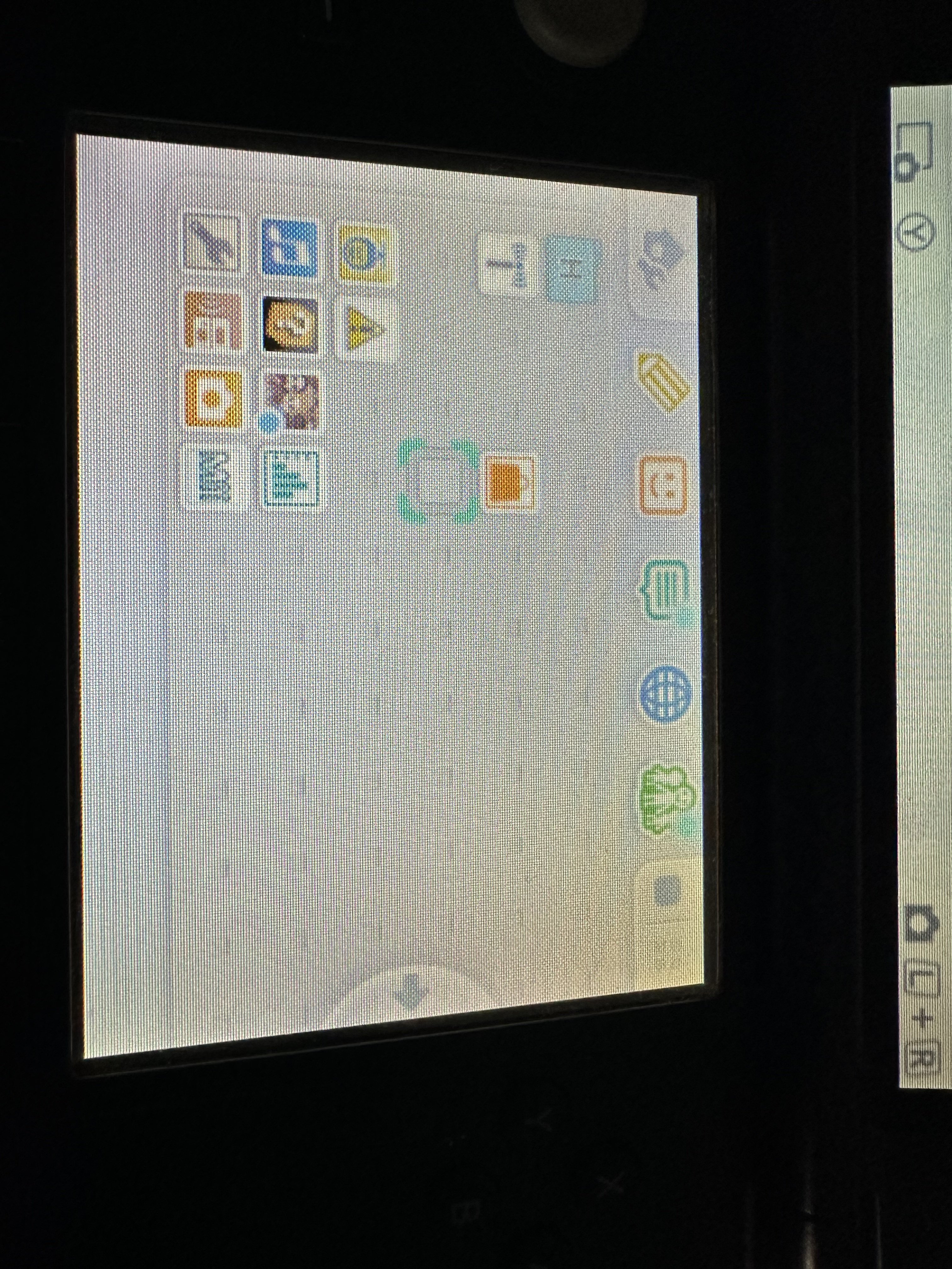

I Got the same thing on my 3DS swapped the screen but still the same result might be a failing and resistor or something. Can someone help me finding the broken one?
