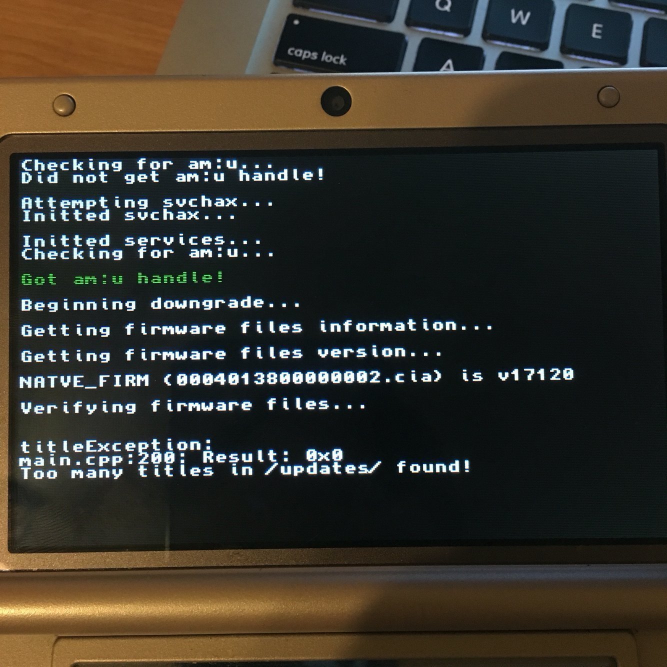

I just went through the downgrade using the new guide and all I can say is the new "sysdowngrader" is terrible. It just won't stick and I had to switch to the old plaisysupdater which worked on the first try.
What entrypoint and what firmware were you on?
So far I've only downgraded from 10.3 (multiple times), and always get 100% boot and downgrade rate when using Freakyhax
I had an 11.0 o3ds, i downgraded via fieldrunner to 10.4. After that I used menuhax as entrypoint.
Basically, whenever I used sysdowngrader it will give me this error
Werid, afaik both PlaiSysUpdater and sysDowngrader were made by the same person (Plailect)
Since some people are having trouble with sysdowngrader. Here's my experience.
SysDowngrader works well when using it to downgrade Old 3DSes (tried it with 10.3 and 10.7) however using it to new 3DSes I experienced the same problem on 2 different new 3dses. In the middle of the downgrade proccess, the 3ds will display an error on the bottom screen and prompts me to press and hold the power to shut down. This will leave me with partial downgrade, using plaisysupdater seems to fix the problem. So from now on, i'll be sticking to plaisysupdater until sysdowngrader is updated.
