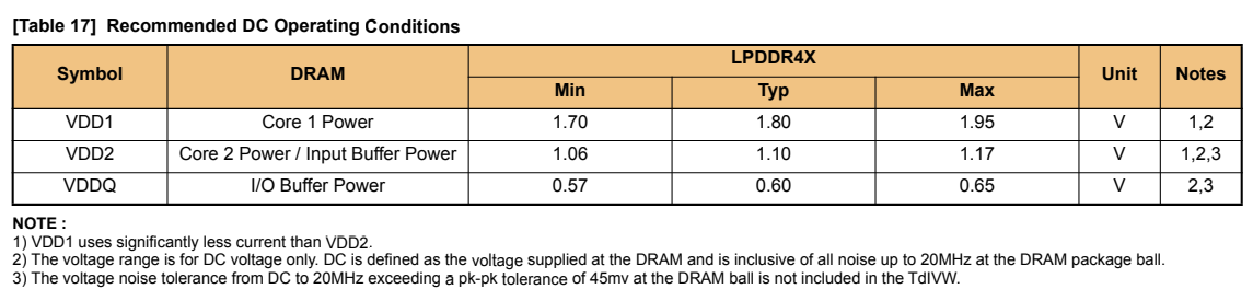

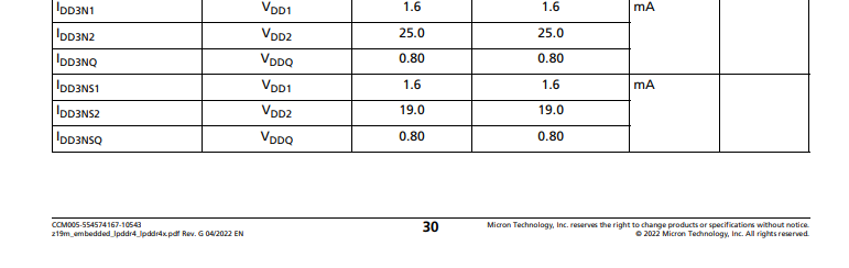

1375 mV vdd2 RAM is unsafe.
GPU above 1305 MHz is also unsafe.
Where this specification from? I can also make random screen from random specification. As far as it is not critical voltage, it must be safe. Not stable, but safe. You return defaults and it will work as usual. Anyway, i'm not strong enough in this topic and will lean on @Cooler3D answerting that.

The screenshot is from the k4U6E3S4AA-MGCL datasheet, one of the LPDDR4X RAMs built into many Mariko switches.
And it's not like overclocking a PC with blue screens. 4ifir makes it possible to significantly exceed the pmic hardware limit which causes damage.
But go ahead, it's your switch.
To be honest i would rather believe the people who reverse engineered the hardware for years with this one. If they say voltage X and clock Y together are the limit then it likely is. If you go over the limit of total power the PMIC chip can deliver you risk damage. But as always with overclocking. Going above the clocks and power limits the hardware was designed for is always a risk.

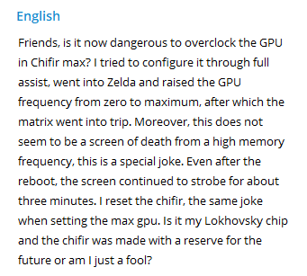

hello! in the first attached picture is my message from the 4IFIR user chat. maybe someone will be interested in my history of using 4IFIR. I found out about 4IFIR more than a year ago, it seems that version 1.1 was then. after trying it, I was surprised that it was possible to overclock Switch at all, so it's also so easy. since then I have started following the project. in general, I have never experienced problems with this product, the only thing that could infuriate is the increased battery consumption at maximum overclocking (the charge goes away in a couple of minutes and one percent remains, which lasts for several hours), this was solved by the desync tool, but I never tried. in general, I always updated my 4IFIR to the latest versions and used overclocking at optimal frequencies to play 60 fps in persona 5 and other not the most demanding projects. sometimes I was surprised that it turns out to get 60 fps (not the most stable) in TotK, but again, the problem with batteries was very annoying. perhaps because of my ignorance, I could not make these 60 frames stable, who knows. and so my few years passed with 4IFIR, until yesterday came. as always, I updated 4IFIR to version 1.9 (it seems to be in beta) and decided to go in Zelda and try maximum overclocking and it turned out what you see in the screenshot above. if put everything together, then I don't have any special requirements for 4IFIR, it's a pretty user-friendly product that helps to get acceptable performance at optimal settings. for the sake of the purity of the experiment, I will try other overclocking products (from hanai3Bi) and it will be possible to form an accurate opinion there. thank you for reading.
