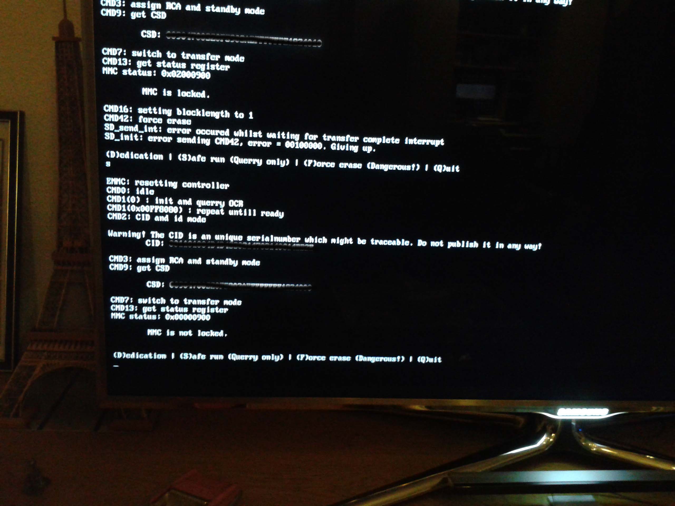

And some more good news :grog::grog:its alive 2.
Checked my soldering, clk was not correct connected.
Updated the Pi, unlocked the 3ds and restored my back-up.
Thanks to all, well done.:toot:

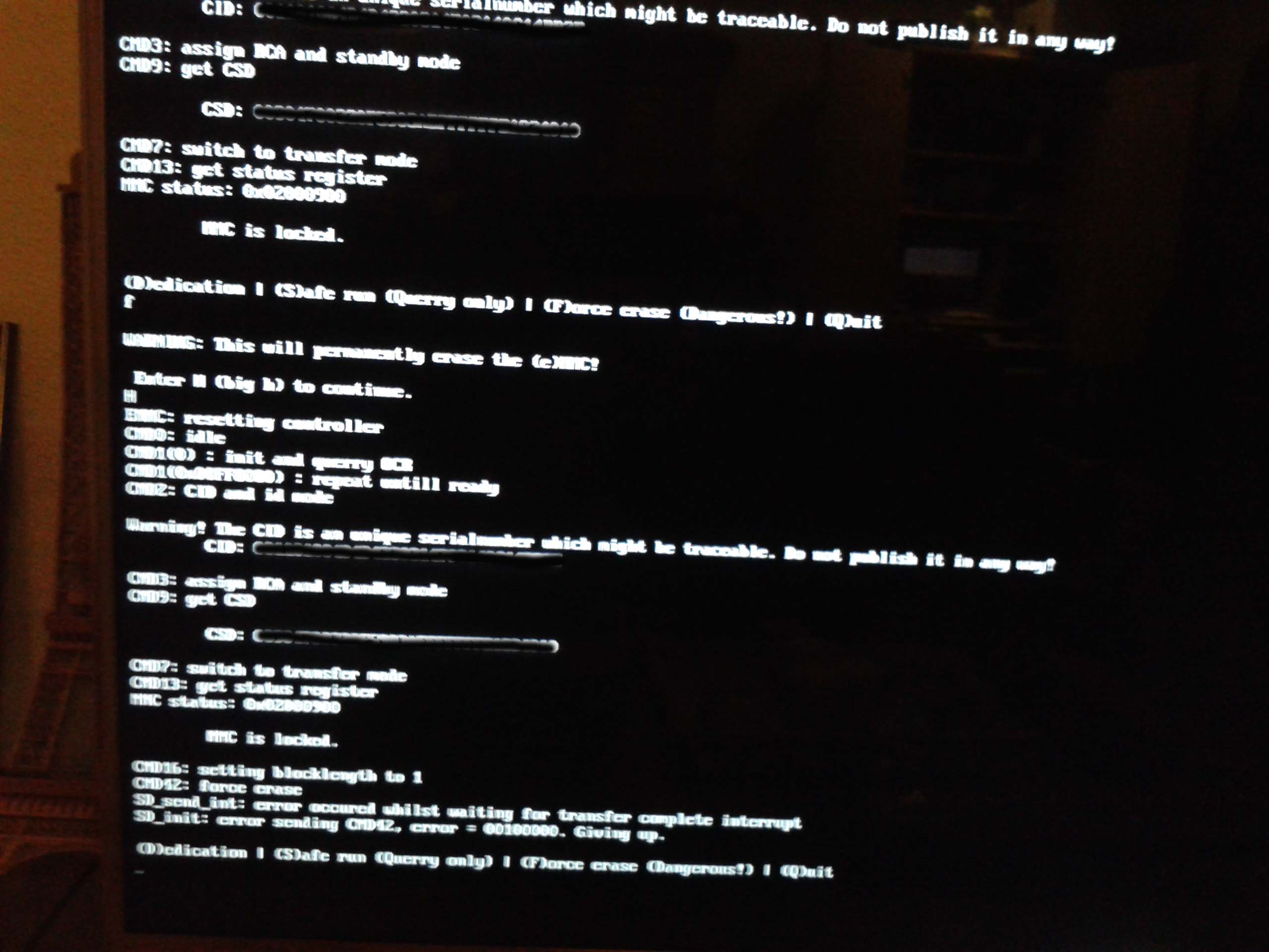

No matter how many times I tried to force erase it never erased since DAT0 was "not soldered".
I just soldered to the correct pad and get a "MMC is not locked." now.
I'll finish unbricking it and greet you with a fine "national" art, if you know what I mean (step 18 rulez)
