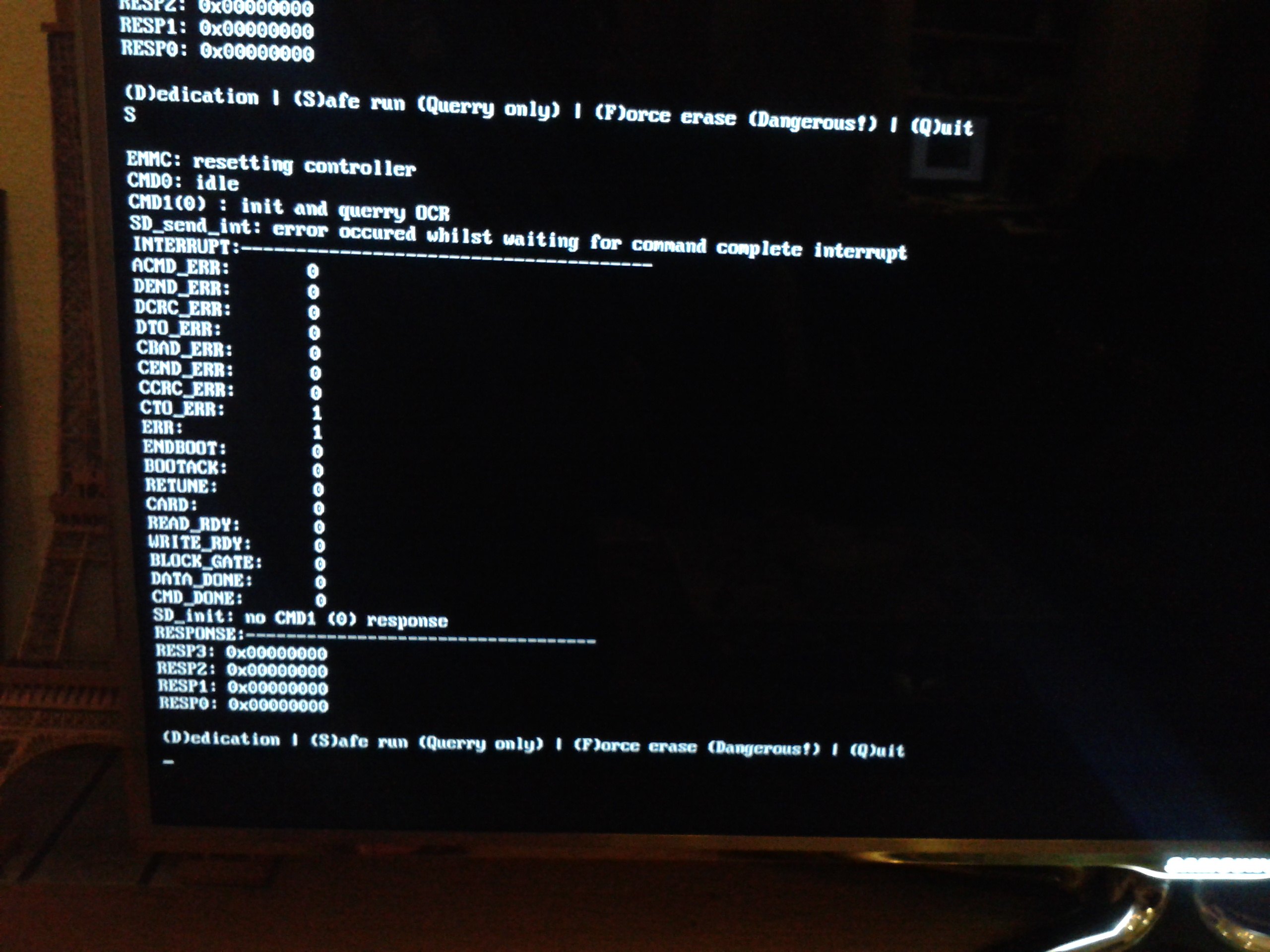

Hi,
I received my Raspberry Pi today and hooked it up.
But I get this, see picture.
Is there something wrong.
I get the same when I put a sd card in the Pi.
:blink:
I have a normal 3ds.
I put the files from bkifft on it.
Connected with 4 wires.
View attachment 6303 Hi,
:blink:
check cables and soldering
mesure voltage on sdcard adapter between ground and dat0, ground and cmd
verify clk soldering (it s very sensitive)
shorten your cable if longer than 20cm
try with a sdcard reader on linux, and check dmesg output
(to see if it's detected or not by sdcard reader)
