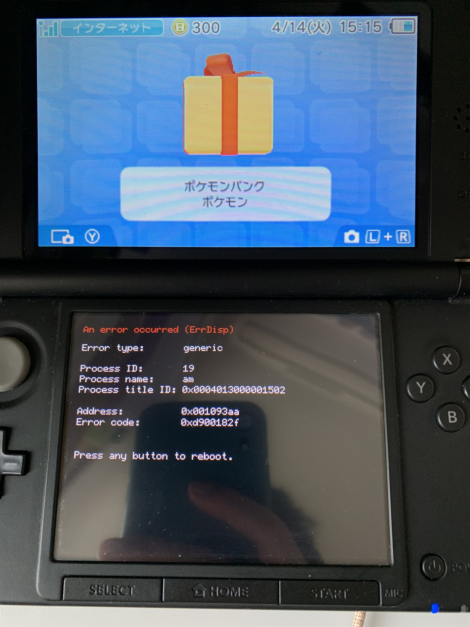

Hacking 3DS An Error occured (ErrDisp) error type: Generic error code: 0xd900182f

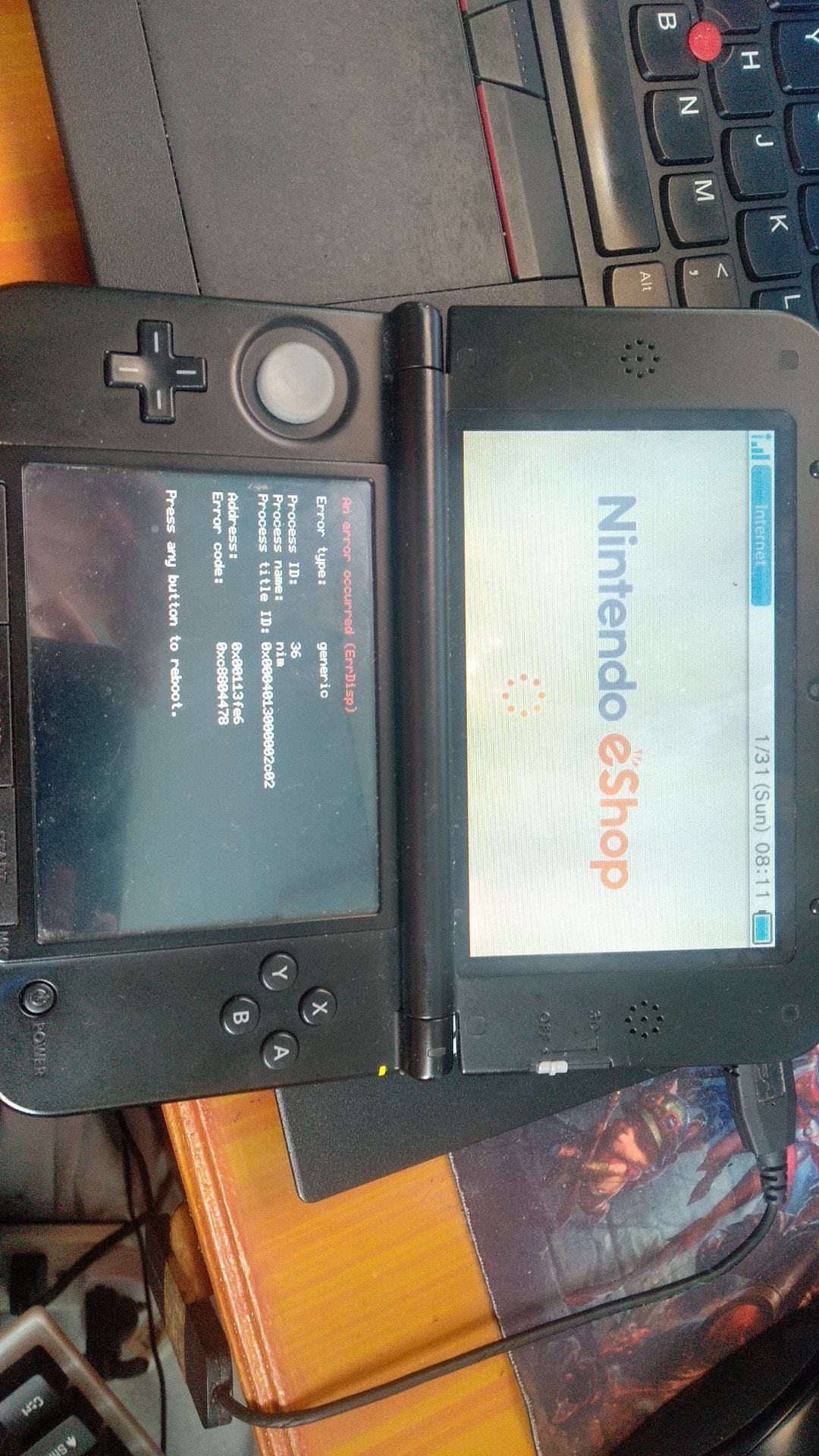

TurdPooCharger Plz can u help me ?
i ve met the same problem: when downloading the game it appears. BUT there is a question that if i reformat the sd card my whole documents is cleaned up ,so after checking out with H2test, how do i restore my b9s documents? Is simply pasting of copy into SD card feasible ?
Judging by your UK flag flair and JPN firmware, was your o3DSXL originally EUR but region changed to JPN?
TurdPooCharger, it's an original japanese one .
Follow in order the troubleshooting steps found in posts 2, 4, and 8 *. Copying files off an SD card and putting them back on will not affect or remove sighax/boot9strap custom firmware.
* For post 8, if you happen to reach Option C, substitute Decrypt9WIP CTRtransfer instead with gm9 script CTRTransfer (Type D9).
Also check against this SeedDB list for games that require additional decryption. Here's a reference post for info about importing seed.

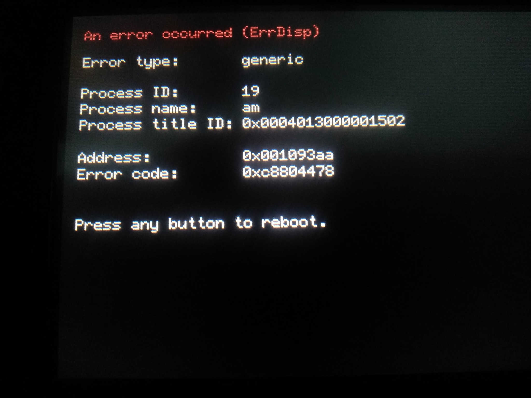

I tried to follow this steps when I got to the Nintendo Eshop I am still getting the same errors. Sorry I'm new at using 3DS console but my 3DS is running Luma 10.2.1. Hope someone can help me. Thanks
EDIT* This is my h2w test results
Test finished without errors.
You can now delete the test files *.h2w or verify them again.
Writing speed: 5.08 MByte/s
Reading speed: 16.3 MByte/s
H2testw v1.4
H2testw v1.4
About this:
3ds-error-1-jpg.244326
Perharps same error occurs when you just turn on the WiFi connection (and no error while you turn it off)? If yes, then it could be a WiFi card hardware disconnection or failure
My 2DS started doing this after I took it apart. I think i put in a bad wifi card. I have not changed it out for another one yet.
I'll try to turn off the wifi and see if that error will be there. Now I'm facing another issue I'm not seeing the homebrew apps and CIA installed apps after testing my SD card. I think I'm lost now hahahaha..
