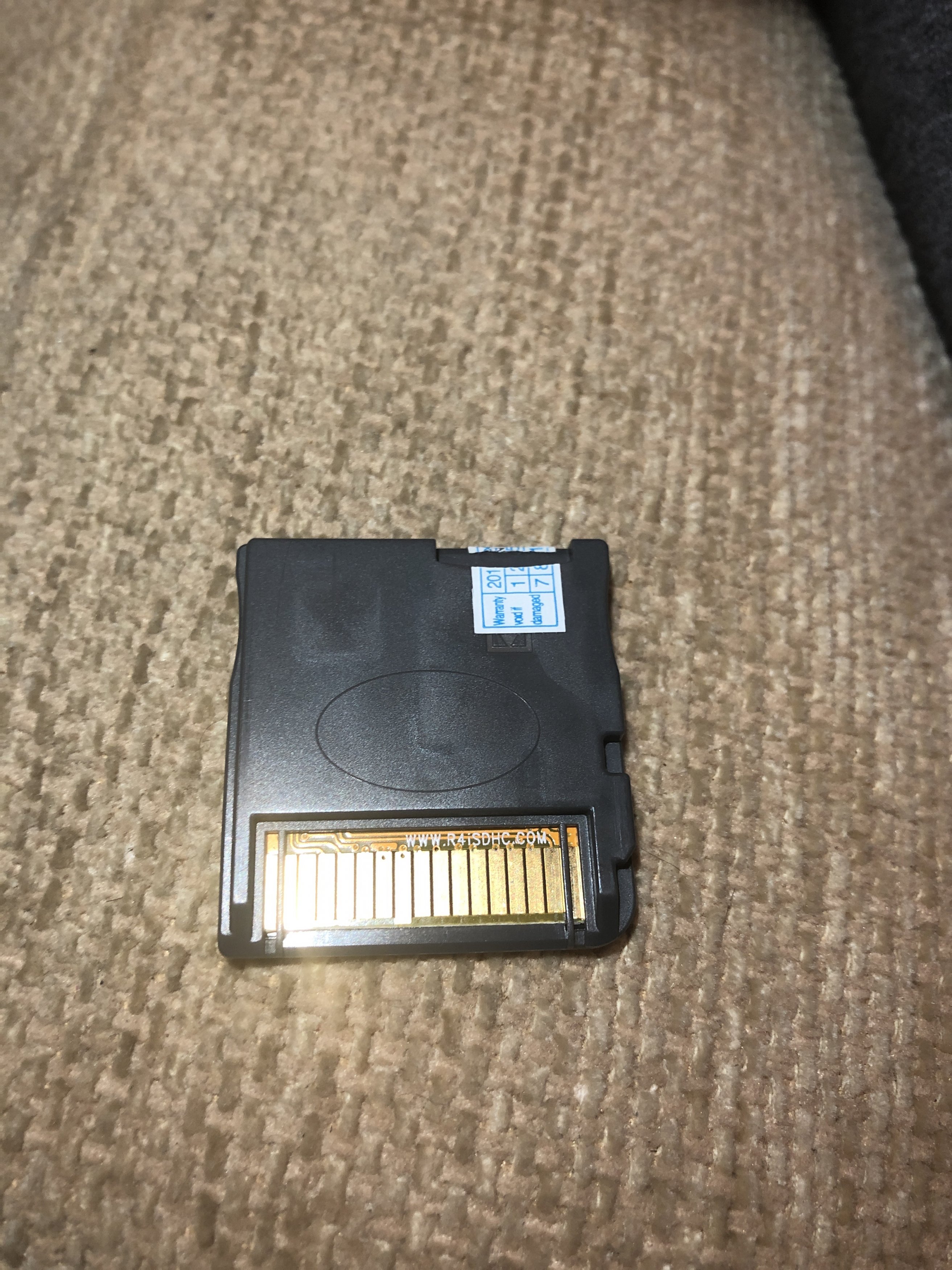

can jou make a picture of the backside of the card mainly at the ds connection side sometimes is printed a website.
if not, could you open the case to see the chip (it's most likely click system, sometimes there is one screw hidden behind a sticker.

Also, can you take a picture of the card's backside? They used different pcb colors for different years and models.

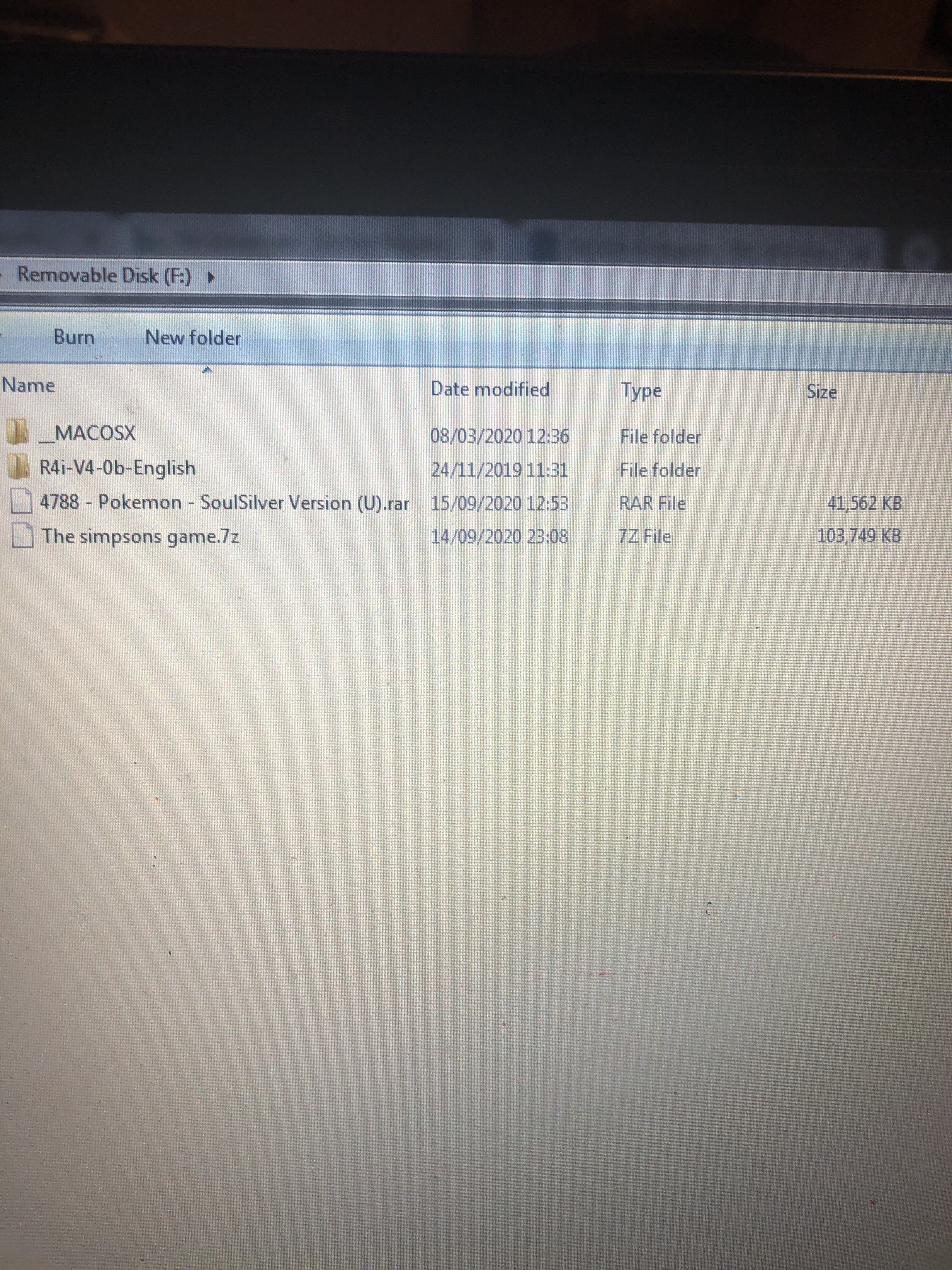

This is the back of the chip! I downloaded a firmware called R4i-v4-on-English.zip, extracted it.. put it on the sd with a game.. It still did nothing ‍♀️ I’m close to just giving up lol

This is what’s on the sd at the moment. There is an r4.dat and a r4i menu :)

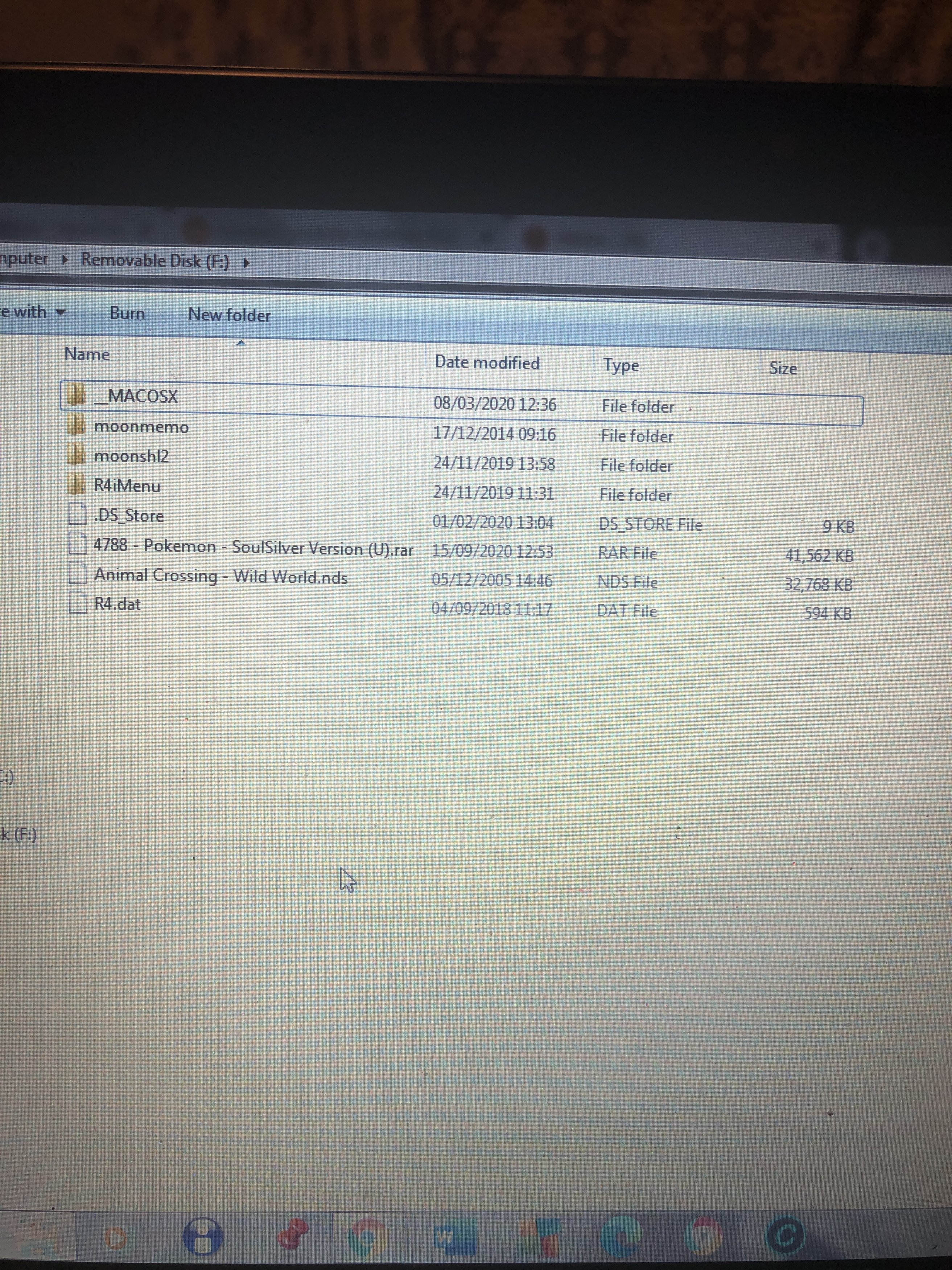

You need to move everything from the "R4i-V4-0b-English" folder back a level.
So just go into that folder, select everything, cut, then go back up a folder level (Alt + Left or Alt + Up, shortcuts), and paste those files.
So, your sd card should have the "R4.dat" file, the "R4iMenu" folder and whatever other folders they included.
Ok so I did that and this is what I have now? Does that look right? Thank you so much for this!
