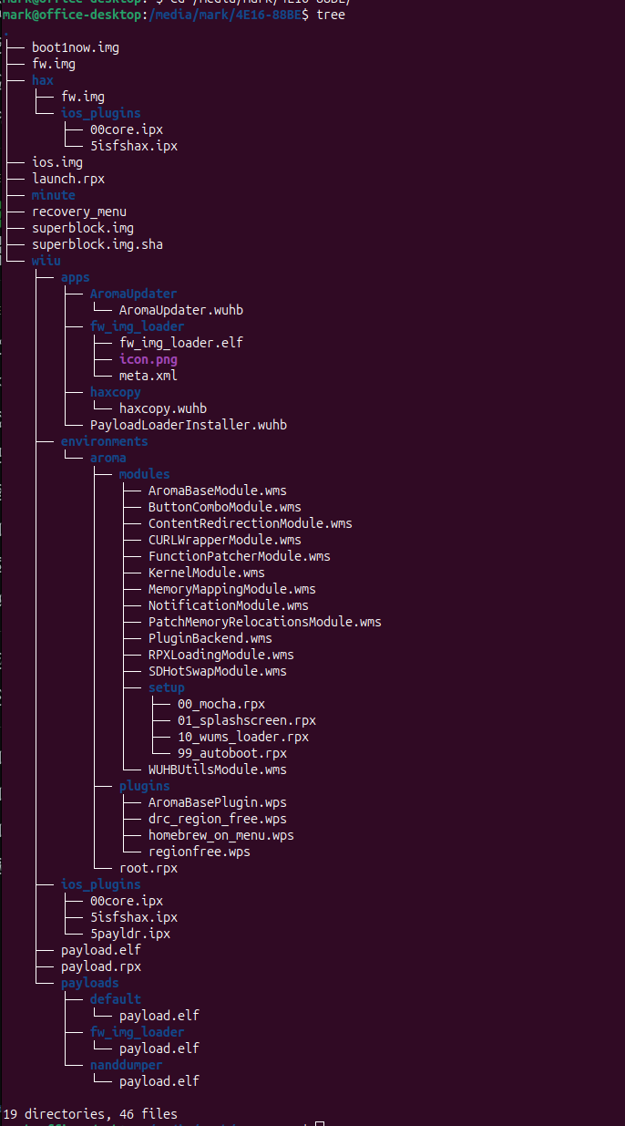

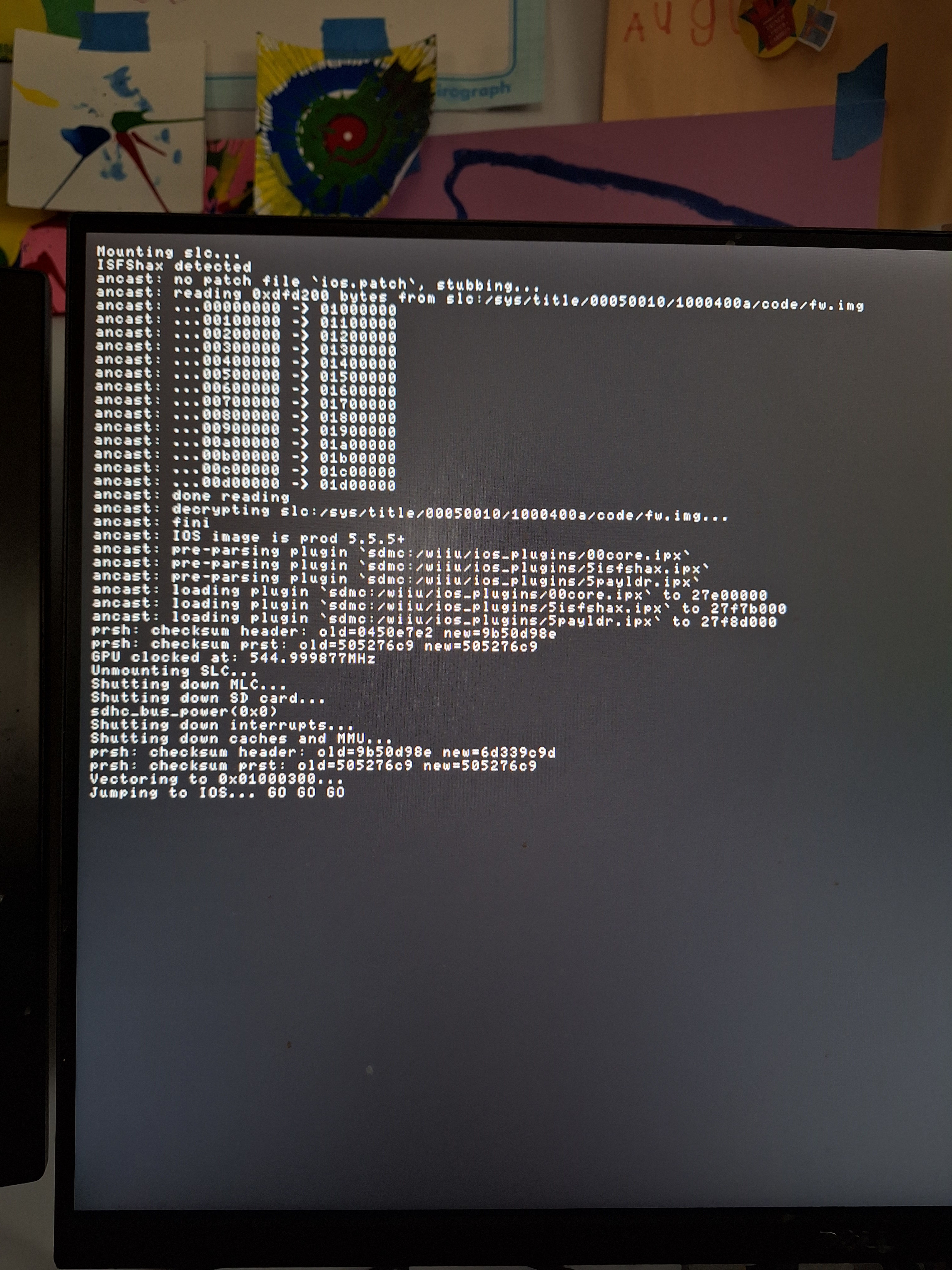

Can you try with a clean SD card again? Put only fresh ISFShax files on it with the payldr and the Aroma files including the environment loader
I built a new SD card with the files you mentioned and I attached a screenshot of the file structure. When I try to boot without rednand it freezes at the black screen in the other image
