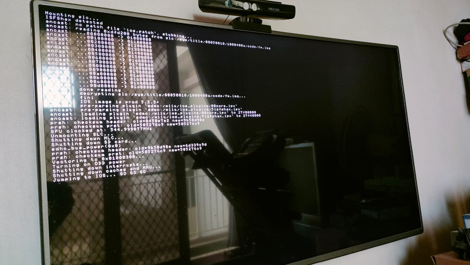

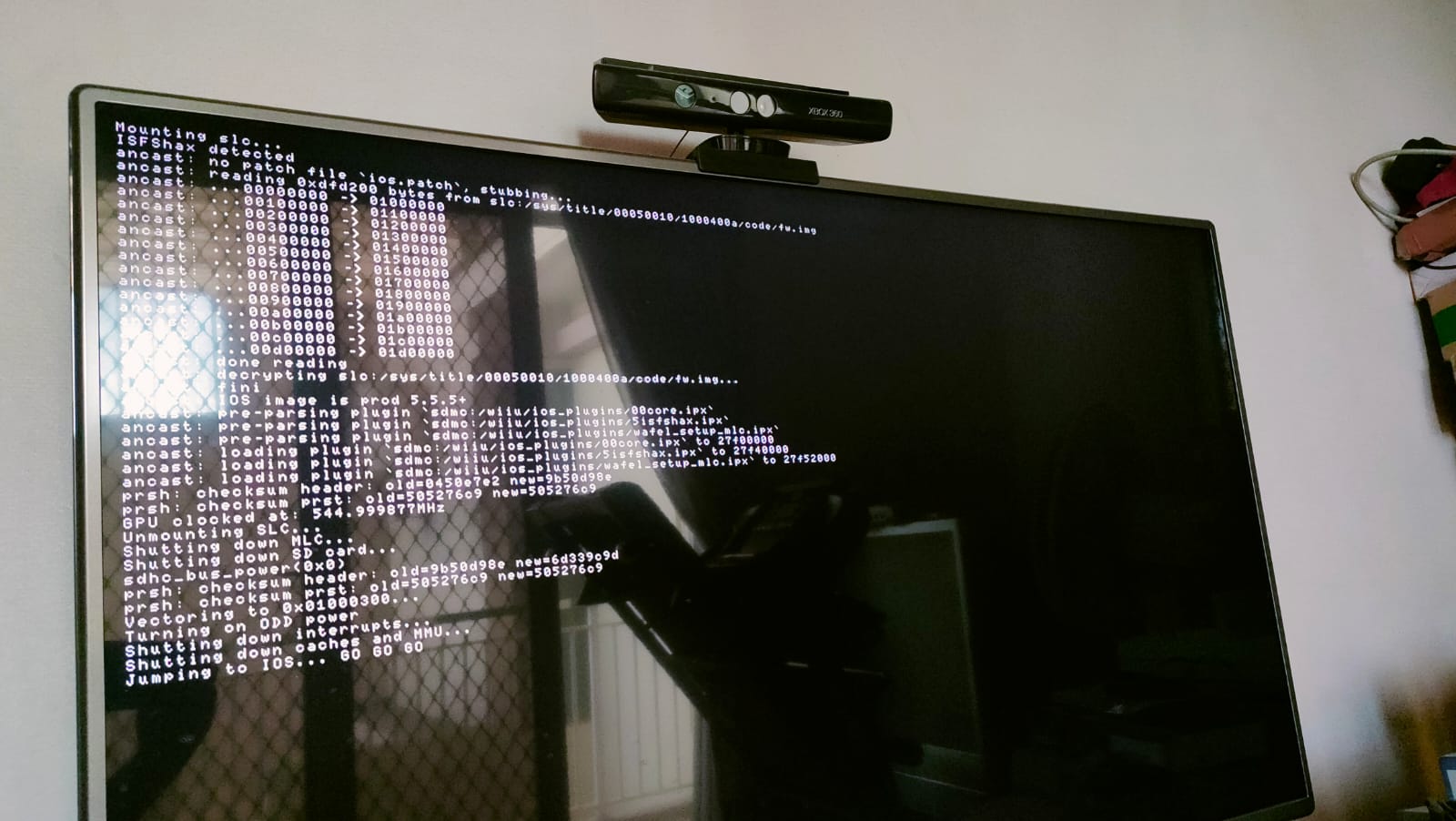

my wiiu brick solid purple light, Boot the third option, delete wafel, boot the third option, but result always Jumping to IOS... GO GO GO , can you help, whats wrong, thanks, if file wafel ipx exist light is orange (pic1), if autodelete wafel light is purple (pic2)
