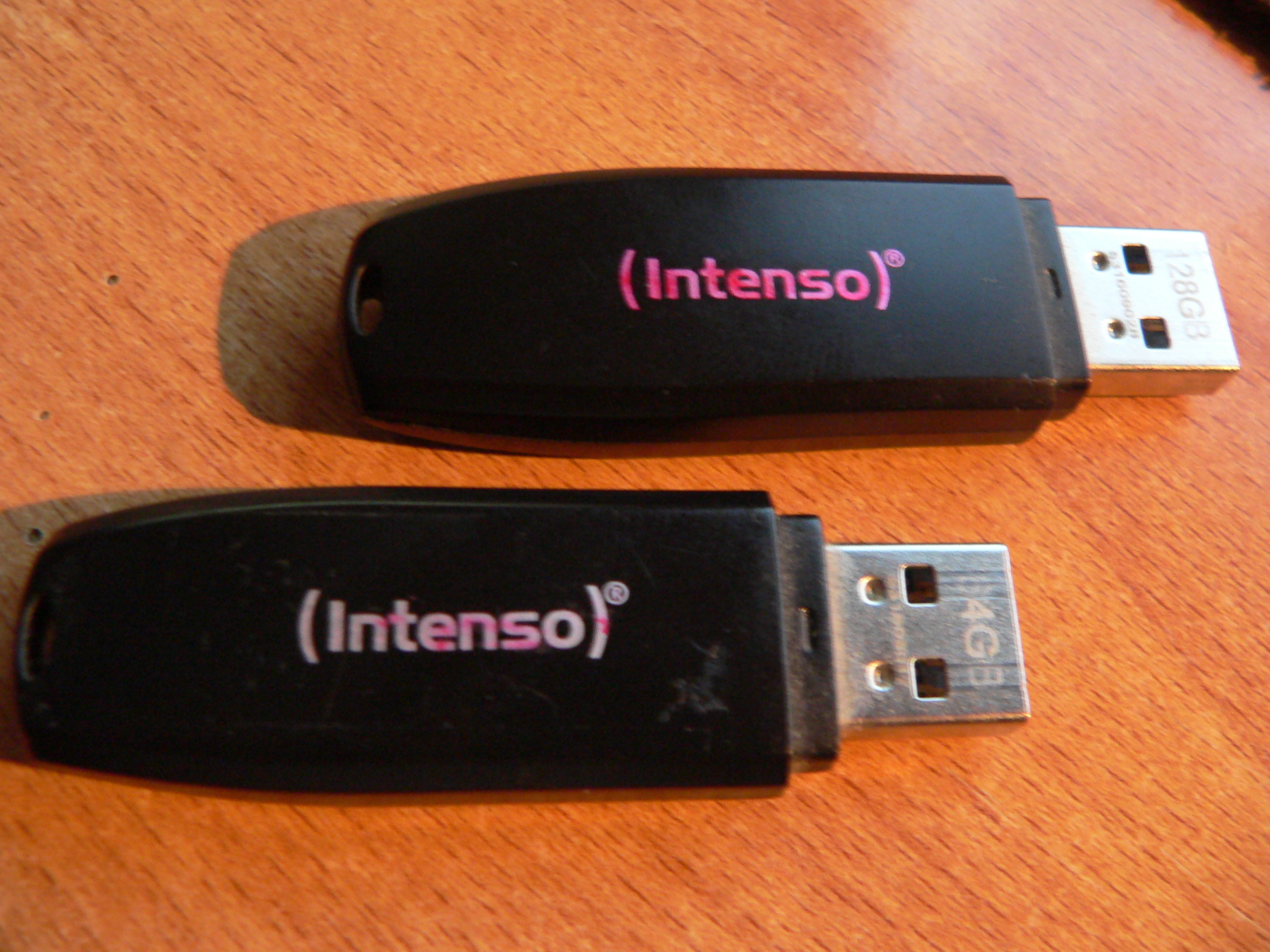

Hello.:)
I use this USB Sticks since 3 Years on my Wii´s:
Intenso USB 3.0 with 128GB and 64GB
I format it for Test Purpose with NTFS and/or FAT32 but mainly use FAT32.
For me very reliable and good Products for the Wii.
Used FAT32 and GameCube/Wii Games on them.
Plugged/Unplugged it several Times and played a couple different GameCube and Wii Games.
No Issues or Data corrupting/erasing with WiiFlow v5.4.0.:)
It Is strange that only the newer Version makes Troubles to your USB Device.:(
(I know these USB Stick "Things" from USBLoader GX v3.0 r1272).
I can not say,what causes these Data erasing.
Thank you.:)
