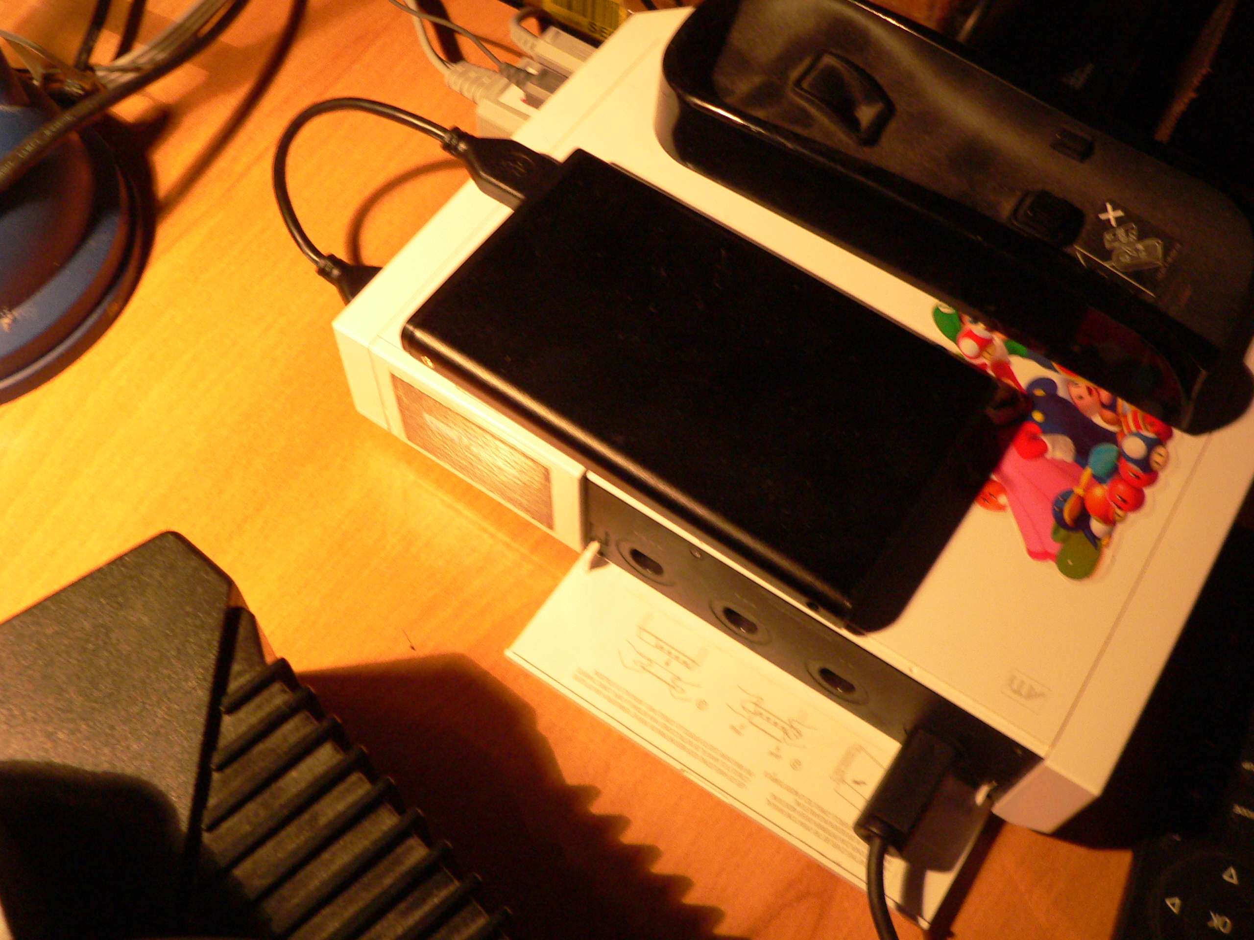

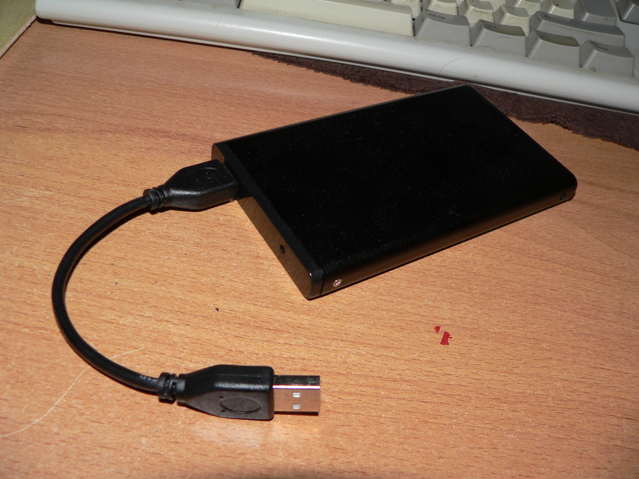

Thanks man.
But you will also need a shell to connect it to wii, what did you use?

Thanks man.

You will maybe notice it on Cover Load,if you have +200 Games on USBLoader GX for Example,also on the Emulators.
It is definetly not for the Game Loading Time.
Everyone can get an Idea of it and everyone can decide for himself what Type of Hard Drive he wants to use.:)

View attachment 191828 View attachment 191829
Thank you.:)
