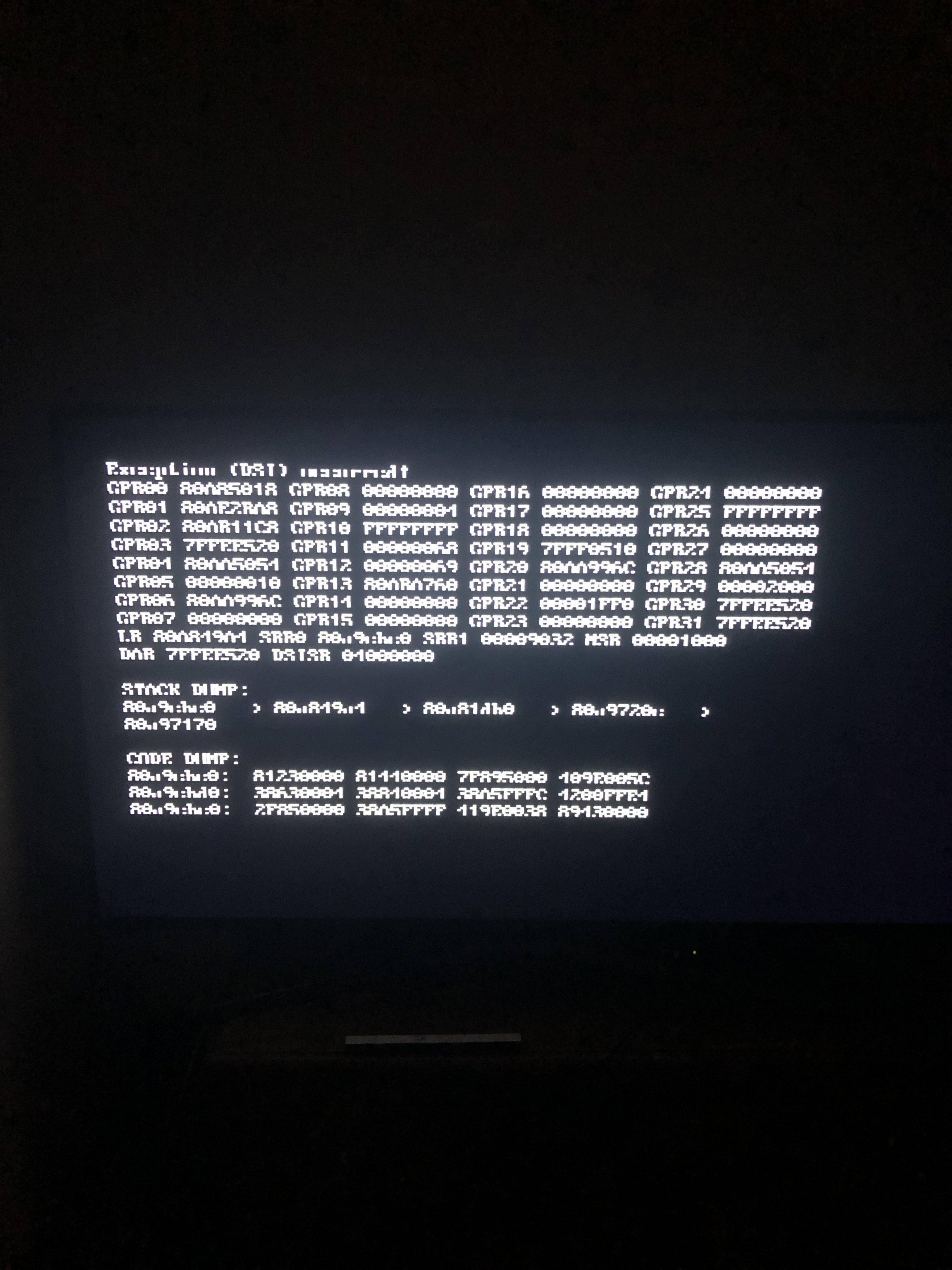

Sorry to bother you :( but now I have encountered this problem. First time I load a game on WiiFlow, and this happens. Do you maybe know what is it?
Code dumps can happen for many different reasons:
- Corrupted game
- Corrupted HDD or SDD
- incorrect cIOS installation when you modded your wii
These are the most common ones.
Some more details from you would be helpful.
Which game is it? All the games?
What storage device are your games on? And how is it formatted?
How did you transfer your game to your device?
What file format is your game?
Can you post a syscheck, so we can know more about your system files?

On the Wiiflow, the error message has appeared with the Mario Kart Wii game. However, any game I choose is unplayable. A black screen will take the screen and never leave. My games are in a hard drive,(HDD USB 2.0 FAT32 format) and all games are .wbfs (and some have a .wbf1 idk what that is. I bought this game hard drive :( )
I hope this is enough information, and if not, please don't hesitate to ask me again!! I appreciate the help <3

Make sure your HDD is formatted with MBR and not GPT.
Are you using WBFS manager to transfer your games to the HDD?
I'm not the best one when it comes to syscheck analysis, but your mod could be a little outdated. You coud try to re-mod it with ModMii
IOS245[56] (rev 65535, Info: d2x-v8final): Bug Trucha, Acceso NAND, USB 2.0
IOS246[37] (rev 65535, Info: d2x-v8final): Bug Trucha, Acceso NAND, USB 2.0
IOS247[57] (rev 65535, Info: d2x-v8final): Bug Trucha, Acceso NAND, USB 2.0
IOS248[55] (rev 65535, Info: d2x-v8final): Bug Trucha, Acceso NAND, USB 2.0
IOS249[38] (rev 65535, Info: d2x-v8final): Bug Trucha, ES Identify, Acceso NAND
IOS250[58] (rev 65535, Info: d2x-v8final): Bug Trucha, Acceso NAND, USB 2.0
These are the first issues I see,...
And here's where I'd correct them using d2x-cios-installer
IOS245[37] (rev 65535, Info: d2x-v10-beta52): Bug Trucha, Acceso NAND, USB 2.0
IOS246[38] (rev 65535, Info: d2x-v10-beta52): Bug Trucha, Acceso NAND, USB 2.0
IOS247[53] (rev 65535, Info: d2x-v10-beta52): Bug Trucha, Acceso NAND, USB 2.0
IOS248[55] (rev 65535, Info: d2x-v10-beta52): Bug Trucha, Acceso NAND, USB 2.0
IOS249[57] (rev 65535, Info: d2x-v10-beta52): Bug Trucha, ES Identify, Acceso NAND
IOS250[56] (rev 65535, Info: d2x-v10-beta52): Bug Trucha, Acceso NAND, USB 2.0
And add this for good measure:
IOS251[58] (rev 65535, Info: d2x-v10-beta52): Bug Trucha, Acceso NAND, USB 2.0
Unless anybody else thinks I've missed anything..
Reactions: Alexander1970
IOS248[38] (rev 65535, Info: d2x-v10-beta52): Bug Trucha, Acceso NAND, USB 2.0
This will be the new recommended setup by modmii and wii.guide very shortly
251 with base 58 was recommended by some guides just for one game, SpongeBob's Boating Bash, and that game works with d2x base 58 AND 38 (as well as hermes cios's). D2x base 38 also provides keyboard support for animal crossing so there's really nothing that base 58 does exclusively that another cios can't do and more.
So to summarize, 249 base 57 can play 98% of games, 250 base 56 takes this up to 99.5%, and 248 base 38 takes it up to 99.9%.

So @XFlak , is it gonna be recommended to leave it as is, or is there some easy way to reclaim 251 without somebody trying to think they need to try and "uninstall a wad"??
Actually we're still debating, base 57 to slot 249 and base 56 to slot 250 are certain, and the 3rd one is certain to be base 38, but we're debating whether to install it to slot 248 or 251.

Thank you, guys for your help! So, just to clarify. This is what I should change using d2x-cios-installer, right? I can't download ModMii since I don't have a PC, only a MacBook :(
From IOS245[56] (rev 65535, Info: d2x-v8final): Bug Trucha, Acceso NAND, USB 2.0
to IOS245[37] (rev 65535, Info: d2x-v10-beta52): Bug Trucha, Acceso NAND, USB 2.0
From IOS246[37] (rev 65535, Info: d2x-v8final): Bug Trucha, Acceso NAND, USB 2.0
To IOS246[38] (rev 65535, Info: d2x-v10-beta52): Bug Trucha, Acceso NAND, USB 2.0
From IOS247[57] (rev 65535, Info: d2x-v8final): Bug Trucha, Acceso NAND, USB 2.0
To IOS247[53] (rev 65535, Info: d2x-v10-beta52): Bug Trucha, Acceso NAND, USB 2.0
From IOS248[55] (rev 65535, Info: d2x-v8final): Bug Trucha, Acceso NAND, USB 2.0
To IOS248[55] (rev 65535, Info: d2x-v10-beta52): Bug Trucha, Acceso NAND, USB 2.0
From IOS249[38] (rev 65535, Info: d2x-v8final): Bug Trucha, ES Identify, Acceso NAND
To IOS249[57] (rev 65535, Info: d2x-v10-beta52): Bug Trucha, ES Identify, Acceso NAND
From IOS250[58] (rev 65535, Info: d2x-v8final): Bug Trucha, Acceso NAND, USB 2.0
To IOS250[56] (rev 65535, Info: d2x-v10-beta52): Bug Trucha, Acceso NAND, USB 2.0
And finally adding this
If this is what I must do, do I have to do the same process I did to install the cIOS I already have? or is there an extra step I must follow in order for me to change these? Thank you again in advance <3
Another thing is certain, modmii will never recommend someone uninstall a wad. If users who know what they're doing want to uninstall a cios, that's fine, but for most ppl leaving unused cIOSs in a couple extra slots isn't a big deal
I think maybe one Thing is:
d2x- v8 -final
d2x -v10-beta52
makes "maybe" a Difference on today´s
Flash Drives (many,many Users are still using it against Recommendations)
and HDDs (in Detail their used Controllers in the External Housings)
So maybe a Wii with 249(56) d2x v8 works perfectly with an WD Passport Series
wheres the same Setup is not working in an Wii with an Seagate Expansion Portable or vice versa.
But that is onyl a Assumption and, I think,it also cannot be proven....
Maybe also an unproofed Thing is:
The Releases1271 and 1272 from the USBLoader GX
works Way better with Loading with Base 57 in Slot 249.
The Enhanced Mod r1272 works better with Base 56 on Slot 249.
Both tested with IOS58 as Loader´s IOS.
But that is also not a Fact.
Thank you.:)

Base 57 to 249, base 56 to 250, and that's all u need for pretty much everything except 2 games. For that install base 38 to either 248 or 251. If u install other cios's, that's fine, but they're redundant
