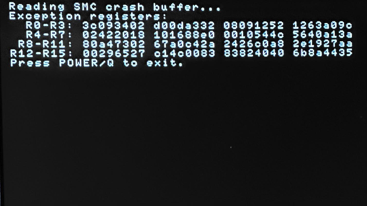

I'm posting this thread looking for some help fixing a retail Wii U I bought while on holiday in Japan.
Some information about the Wii U in its current state, at the moment trying to power it achieves nothing, I'm only given a solid red light.
On initial press of the power button, I've confirmed two things for certain:
- I can see the it pull approx ~0.5A of power as if it was trying to power up
- I can hear the fan spin up.
- Disk does not spin up (not 100% on this, and console is in pieces at the moment)
Long story short, I managed to get ISFSHax installed on the console with problems.
More specifically I managed to install ISFSHax but immediately things seemed a bit wrong, after the installation of ISFSHax completed, I hit the option to restart the console and while the screen went blank the console never actually turned off (confirmed via a constant ~15w of power draw and solid purple light on console).
Upon reboot, without use of Paid The Beak, the console returns to its original state of not being able to boot and only showing a solid red light. Using the Paid The Beak exploit again gets me back into the minute menu, where trying to install again reports that its already installed. So I decided to make backups of the SLC, SLCCMPT, OTP, and SEEPROM.
Trying to boot from SLC or any variety of it halts at the IOS GO GO GO log line and looking at the console light shows a solid purple light and even after an hour doesn't boot. This is the same regardles of whether I patch the slc or sd. I've only managed to get a flashing blue light by trying to re-install the IOSU, and using the boot ios_orig.img option, though this just stays on the flashing blue light for 3+ hours until I ultimately power it off manually.
I've tried various different solutions to other problems such as setting up rednand and or re-installing IOSU, although I would not be surprised if I didn't do these properly and so contributed to my inability to make progress. I'm happy to re-attempt these if others believe there is some chance in retrying them. Additionally In my attempts I've deleted the consoles MLC and SCFM, which as far as I know will just mean save data or similar is lost which is no problem to me.
I've put my SLC.RAW dump via nandBinCheck and it produced the following logs
