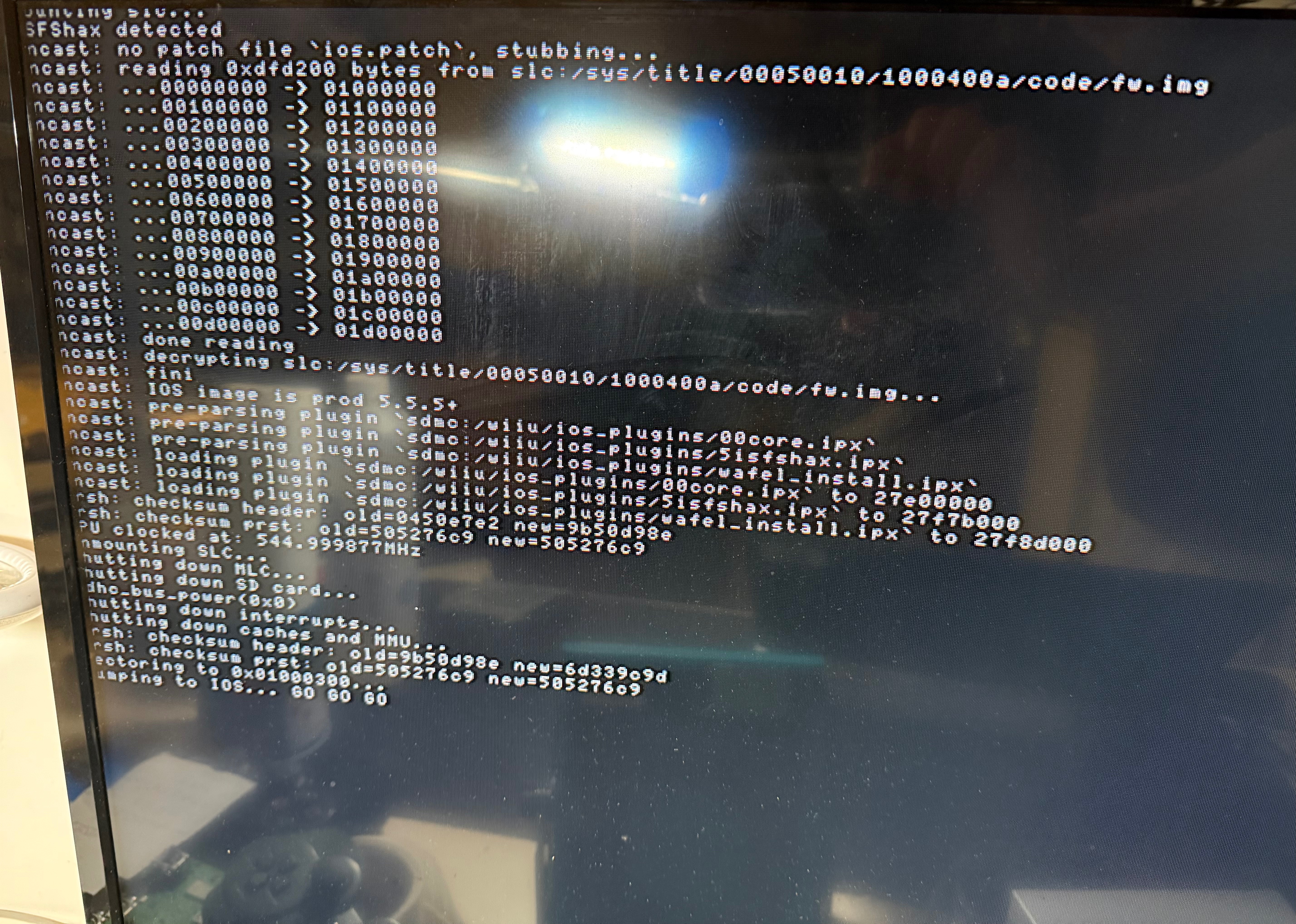

Ok then maybe the rest of the system is just to outdated for the latest OSv10.
Use the MLCRestorer downloader and download the SLC and MLC titles. Then just install them all like you did with the OSv10. (You could skip the OSv10 there since you already successfully installed it). You should now also be able to use the third option instead of the fourth.
It freezes again when jumping to iOS.
It says no patch file /ios.patch/, stubbing...
Is that the error?
There is no log. So it didn't even start, but froze beforehand. I only have the folders from the slc and mlc folders on it. I removed everything else for flashing the ios_orig.img. Should I have left the ios_orig.img on the SD card as well?
The ISFSHAX is on it with the wafel file inside.
Can you show the screen where you are stuck? It's normal to stay there during the install but I want to see the plugins and everything
Sure.

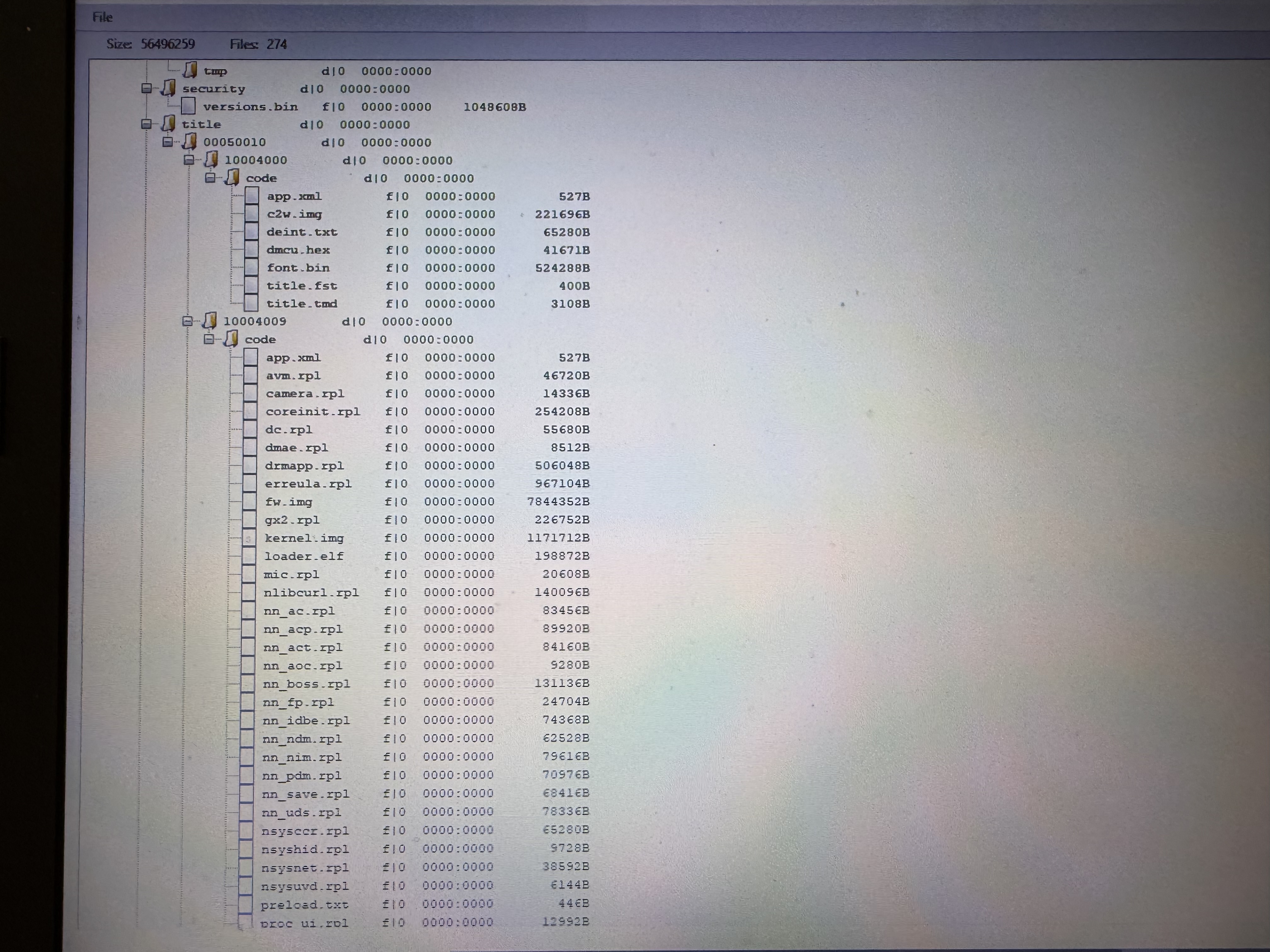

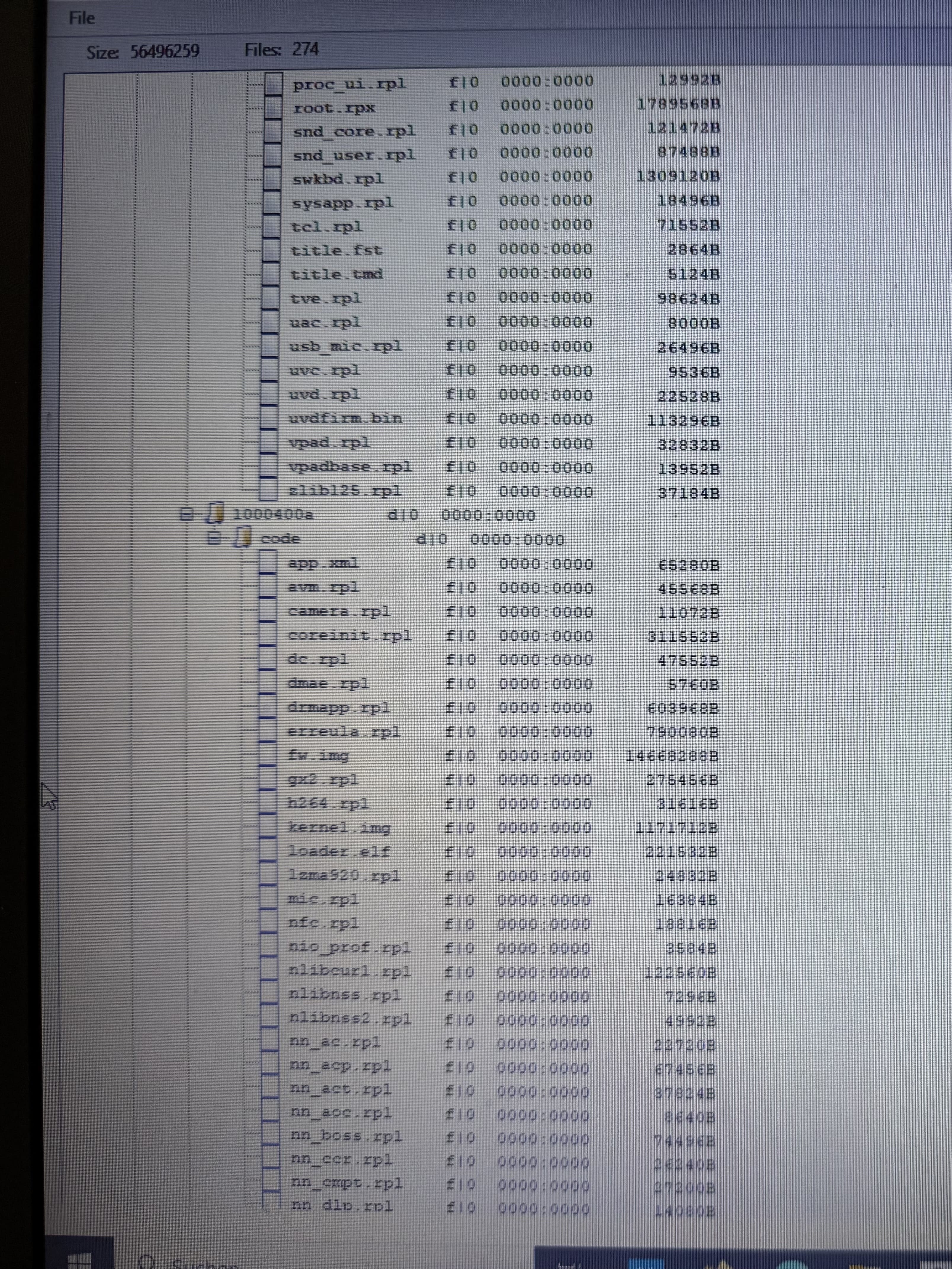

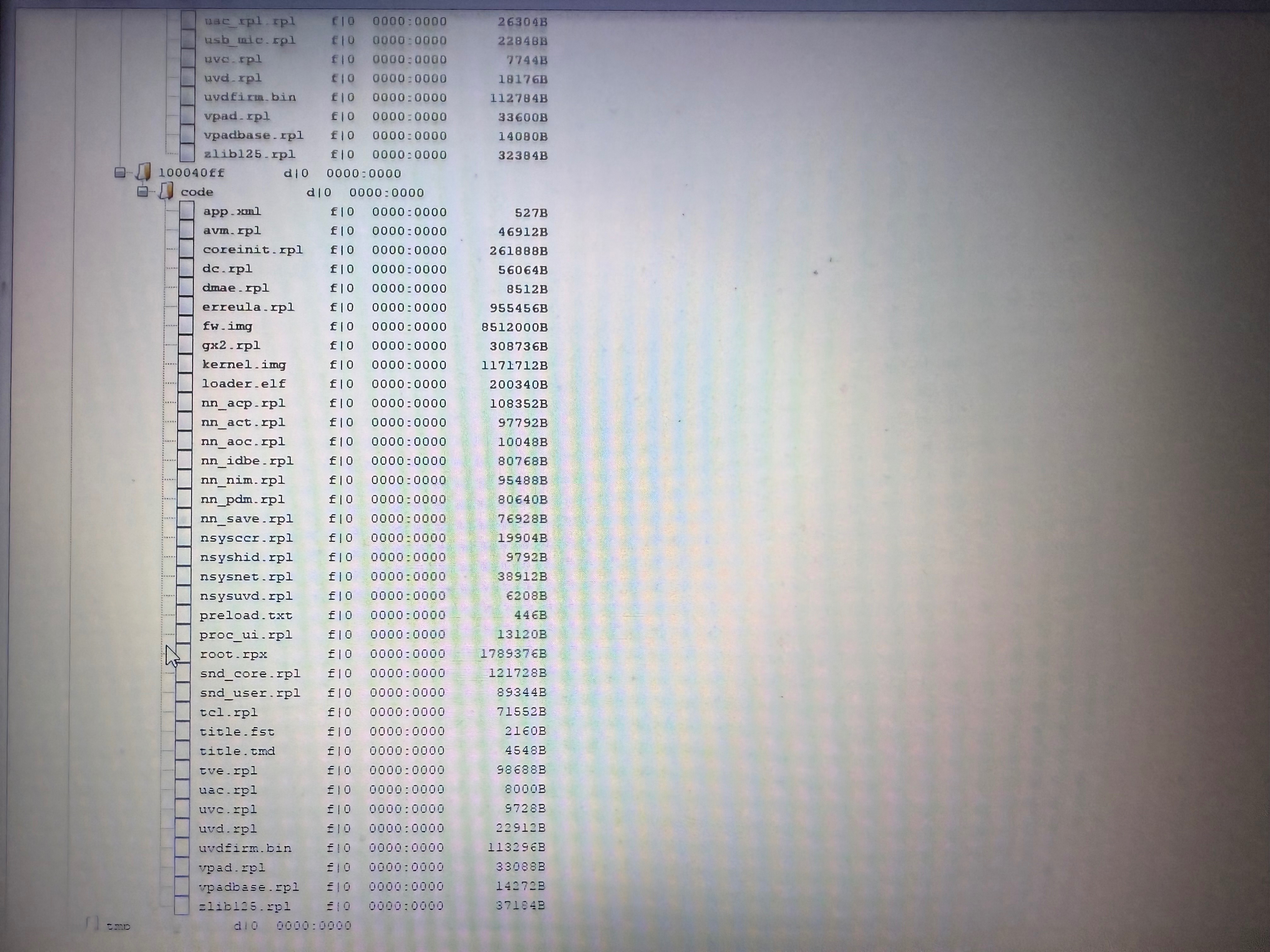

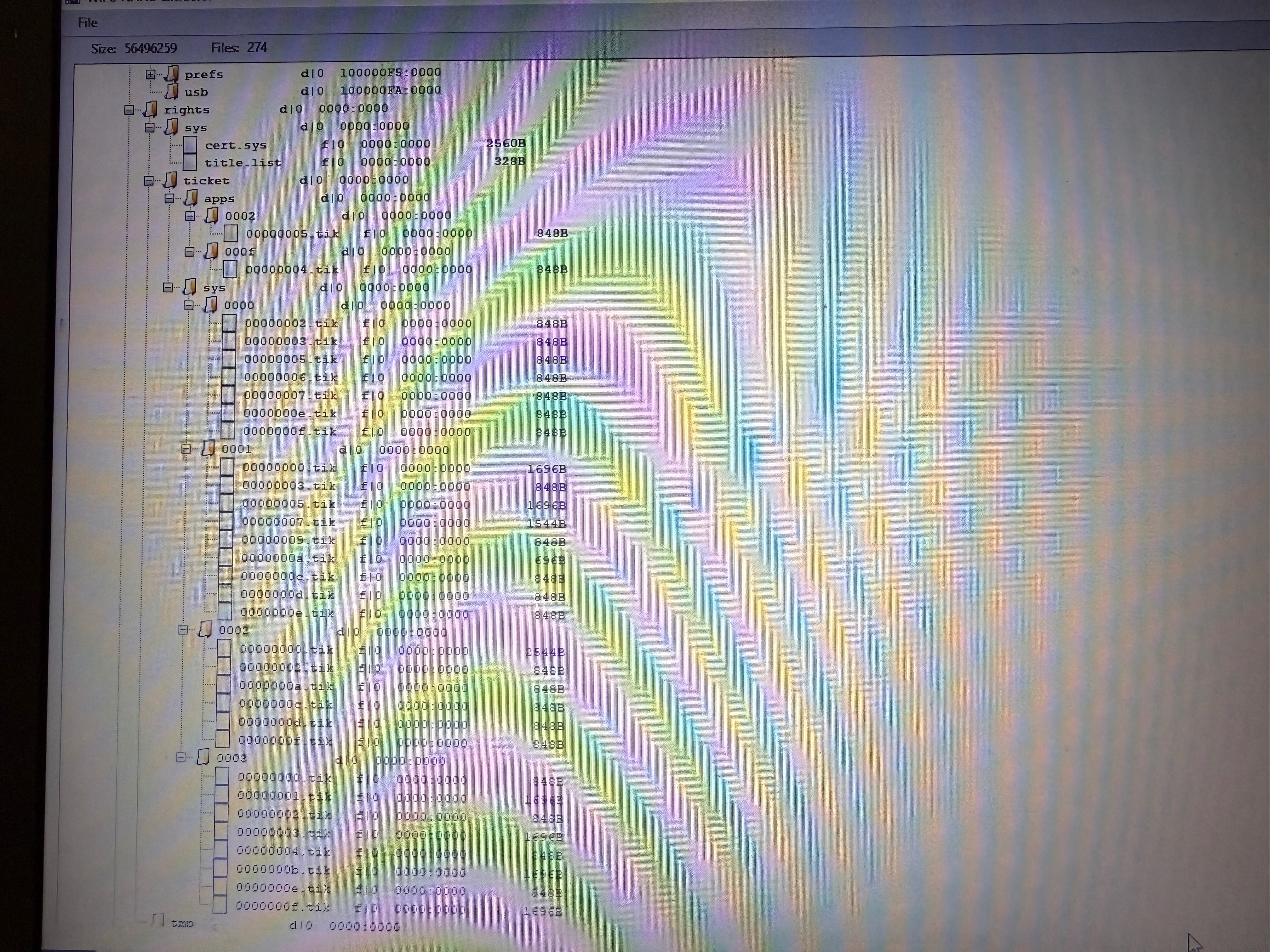

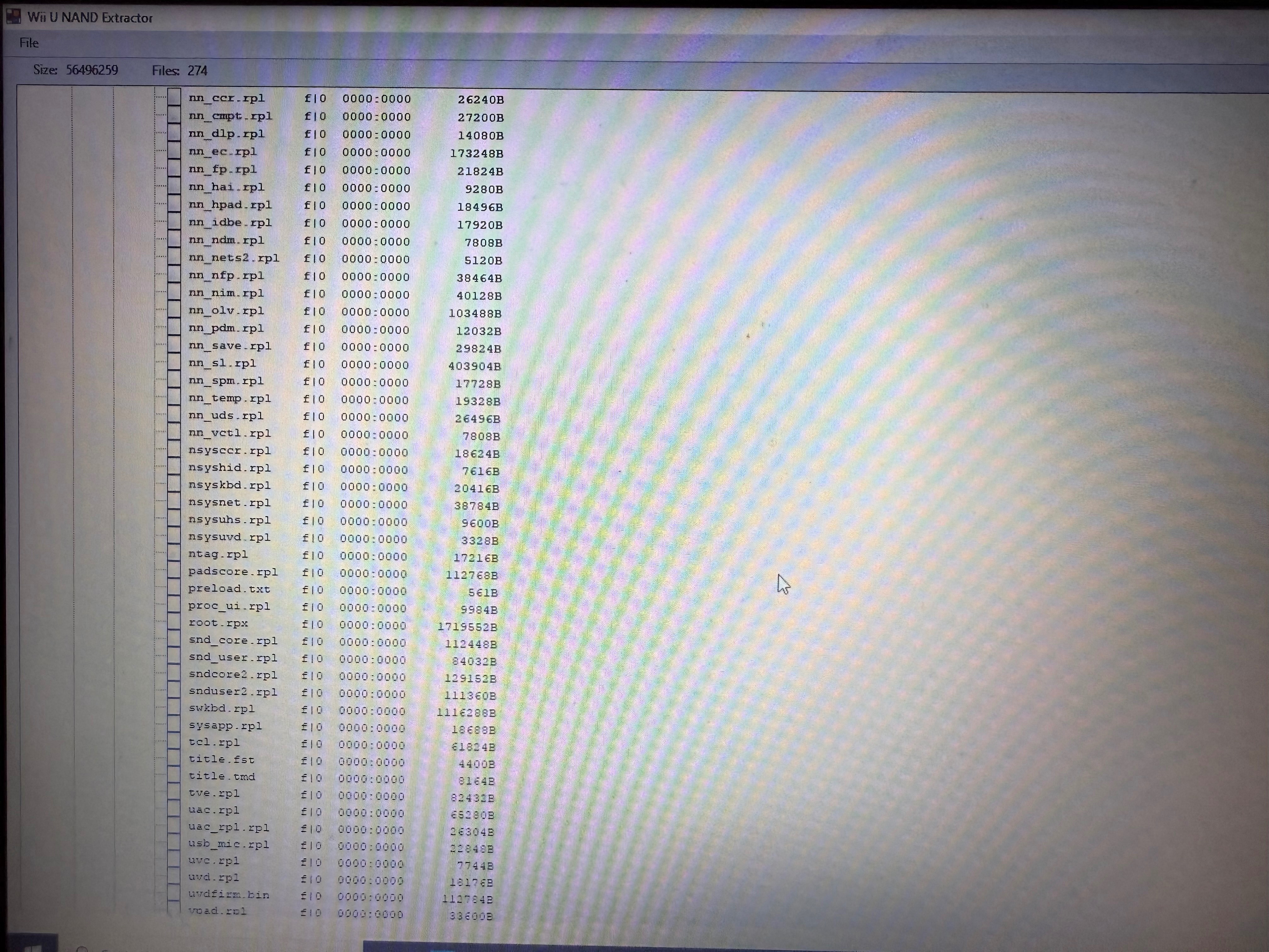

Ok that's strange. Can you run the nand extractor on it and show what's there?
Yes, I can do that.
I loaded the repaired slc.raw file into nand ectractor. But I don't know what I'm looking for. The otp.bin file is in the same folder, but he didn't ask me for it. I assume he was able to access it, right? What exactly am I looking for there? Unfortunately, I don't know what to look for.
There are 274 files and 56,496,259 bytes.

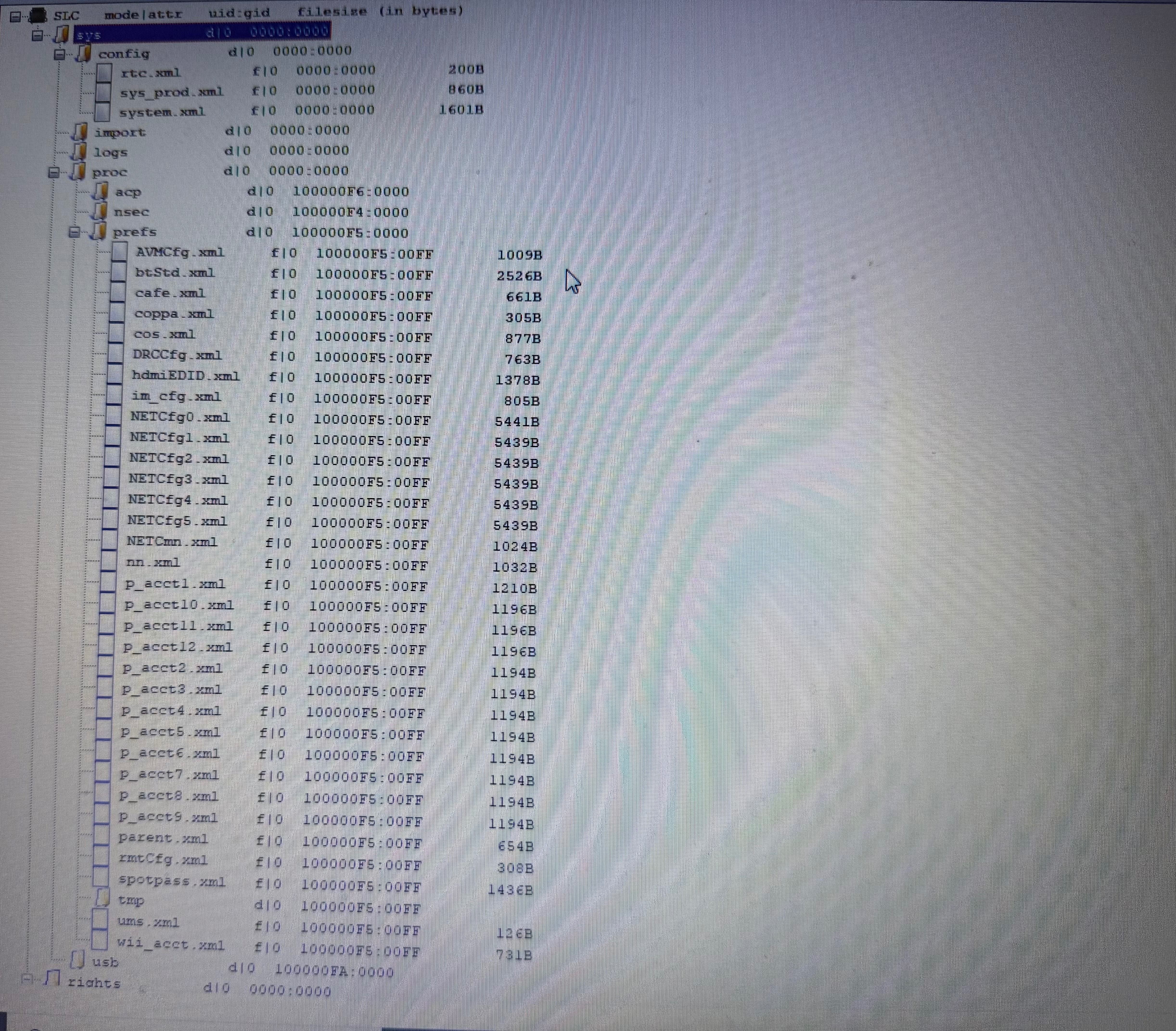

There are no files in the following folders. At least, I cannot open them with + like the rest. The following folders are affected:
tmp, usb, nsec, acp, logs, import
Sure. Of everything?
Apologies for the poor quality.

Ok looks normal. Just no logs for some reason, probably because it is crashing too early.
So just to recap: the install worked when you reinstalled the OSv10. But since you installed that, the install won't start again?
Could you run the nandBinCheck again on the current SLC and post the complete output?

SInce the install was successfull running the third option should do exactly the same as running the fourth with the ios_orig.img. But something on your slc seems to have broken from that install I guess. So can you run the nandBinCheck
I tried again. It was quick because I had left the SD card in. Now the LED is flashing. I found my mistake. I forgot the wafel_setup_mlc file and used wafel_install_pix instead. I'm really sorry for keeping you waiting so long because of this little mistake. Let's see if it boots once it's finished.
