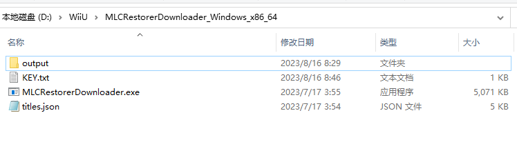

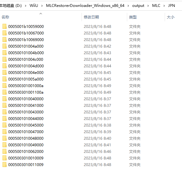

The command window has disappeared, I just got these titles. I can't find the logs. I have always believed that this is my network error, so I have never mentioned it. You know, in my area, browsing certain networks requires the use of magic(VPN).

Done. I don't know what was different this time, but now I have 52 folders.
Should I now attempt wafel_install (basically all the steps involving wafel except for destroy)?
