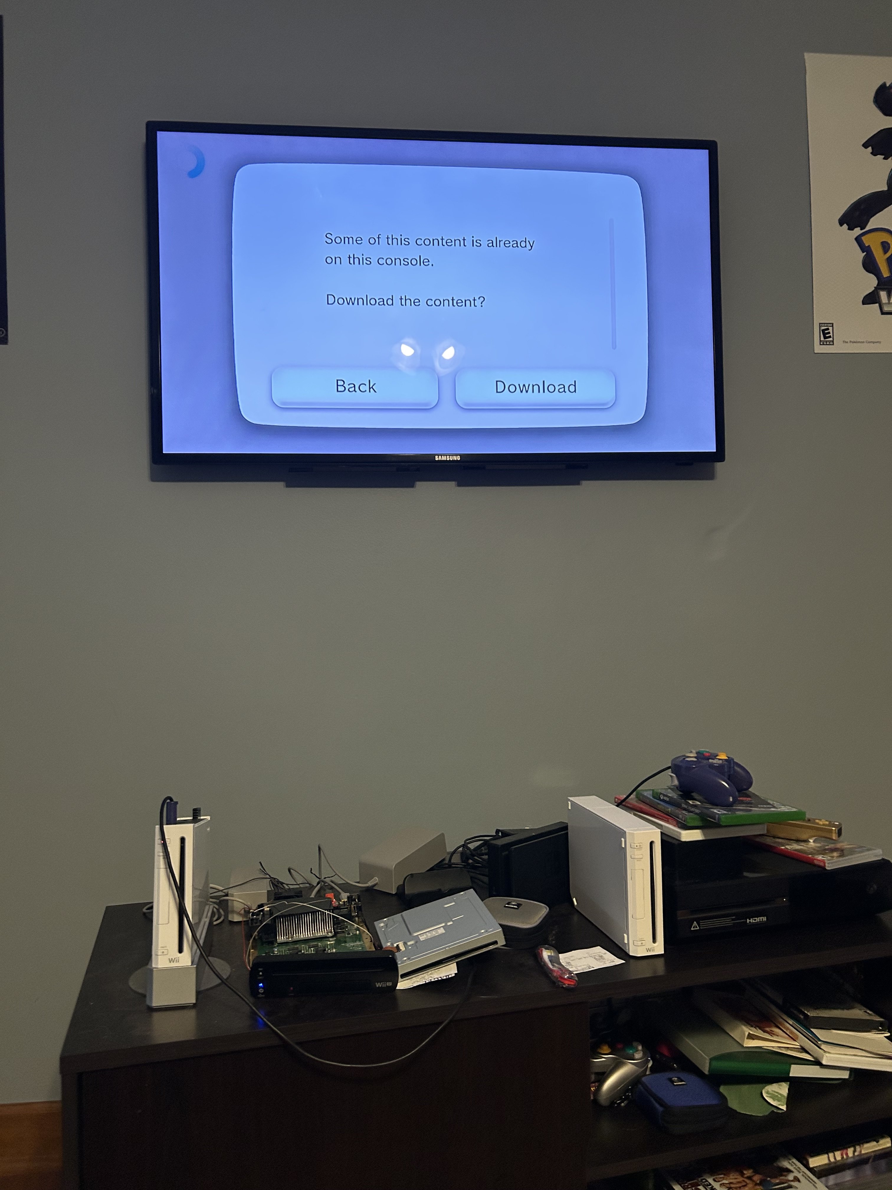

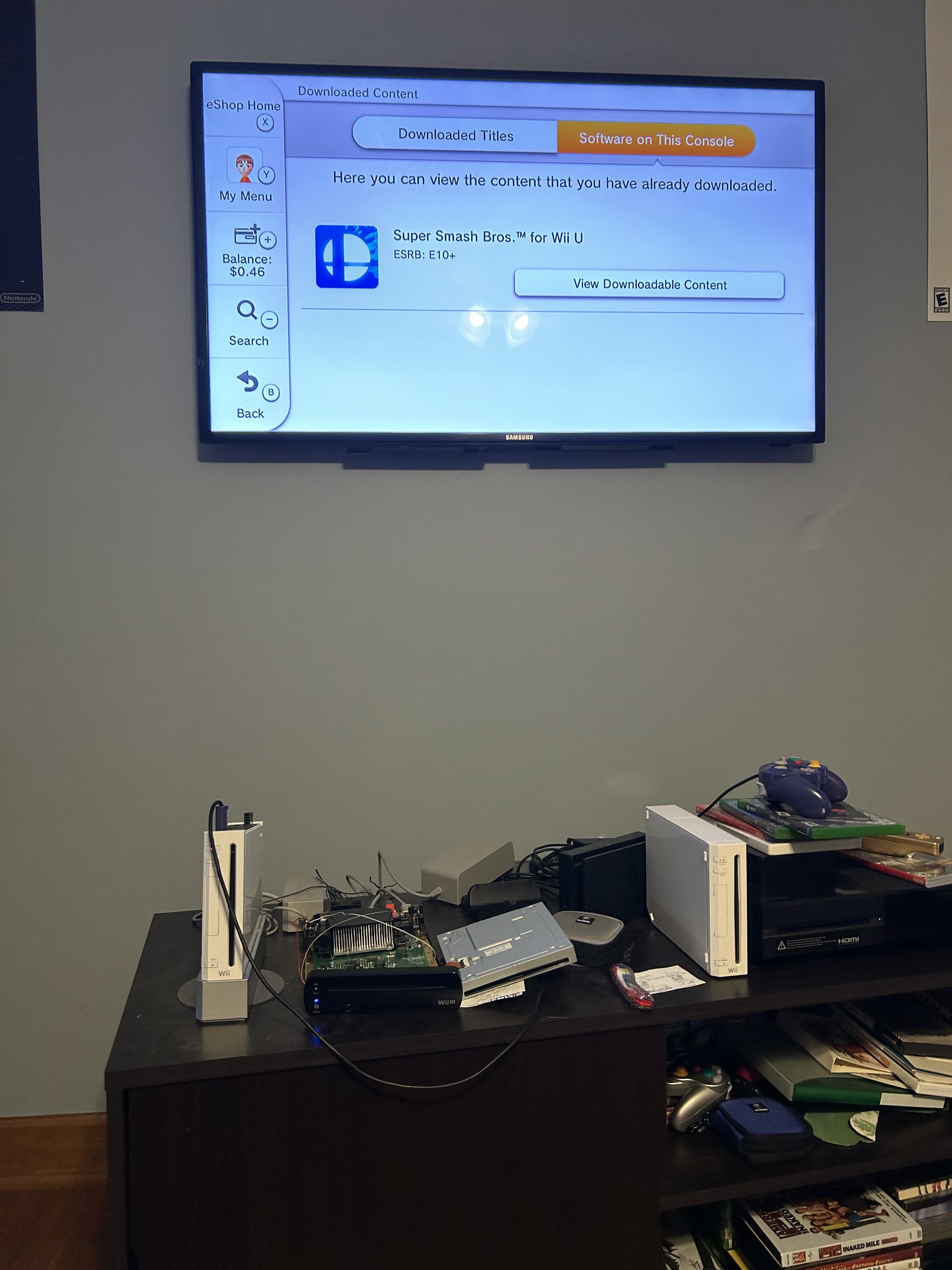

Great news. It seems to be working. I went through the entire system setup and navigated to the eShop with no issue. I never did get an error for the missing disc drive. Something interesting I did notice though is that I went to the eShop to see if I could still download the DLC I purchased years ago for Smash Bros. I received the message that some of the content was already on the system which I would think wouldn't be possible since the mlc was rebuilt from scratch.
Can you show the exact message? Could it be that it just said that you already own it an can download it for free again?
I'll take a picture of it and post it later today when I get home. It definitely did not say I already owned it and could download it again for free. I remember it saying something along the lines of at least some of the content already being on the system.

I’ve attached the pictures showing what happens in the eShop. Would’ve posted last night, but I was very tired. Had a little scare this morning since I wasn’t getting any output to the TV and the pad wasn’t connecting to the system, but I just attached the disc drive and it seems to work fine.

I never saw that message before. What did you click to get it? "View Downloadable Content"? What happens when you you click download?
Could it be that something wa salready installed by SpotPass? Did you look at the data management what is there?
Else have a look at usr/title on the mlc to see what is already there. You can also look at sys/title on the slc, but there shouldn't be anything besides the few system titles
