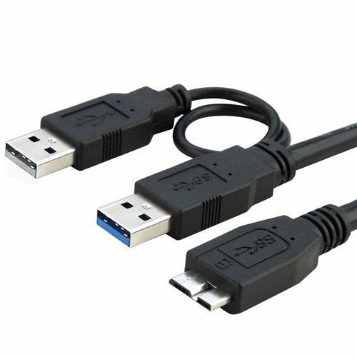

What kind of Y cable are you using?
I used to have the same exact problem until I switched from usb 2.0 to usb 3.0 cables.
I still need to connect the cable to both usb ports on the back of the console, but at least now I can finally play my games without fear of losing my progress to a random HDD disconnection.
The ports on the Wii U are 2.0, but 3.0 is backwards compatible and apparently it is capable of carrying slightly more current.
This is the cable I'm using

As you saw in the video, SSD should work without a Y cable. I have a Y cable that is really sensitive, if it is hanging in the air, it gives disconnection error with the HDD in enclosure. I tried the HDD without the Y cable and the Wii U didn't even recognize it, so I decided to try an SSD in the casing without the Y cable and so far it has worked fine, I did this a few days ago so I can't give any long-term results but so far so good...
If you do have problems buy another y-cable. I've had one for about 2 years now and it has never once disconnected.

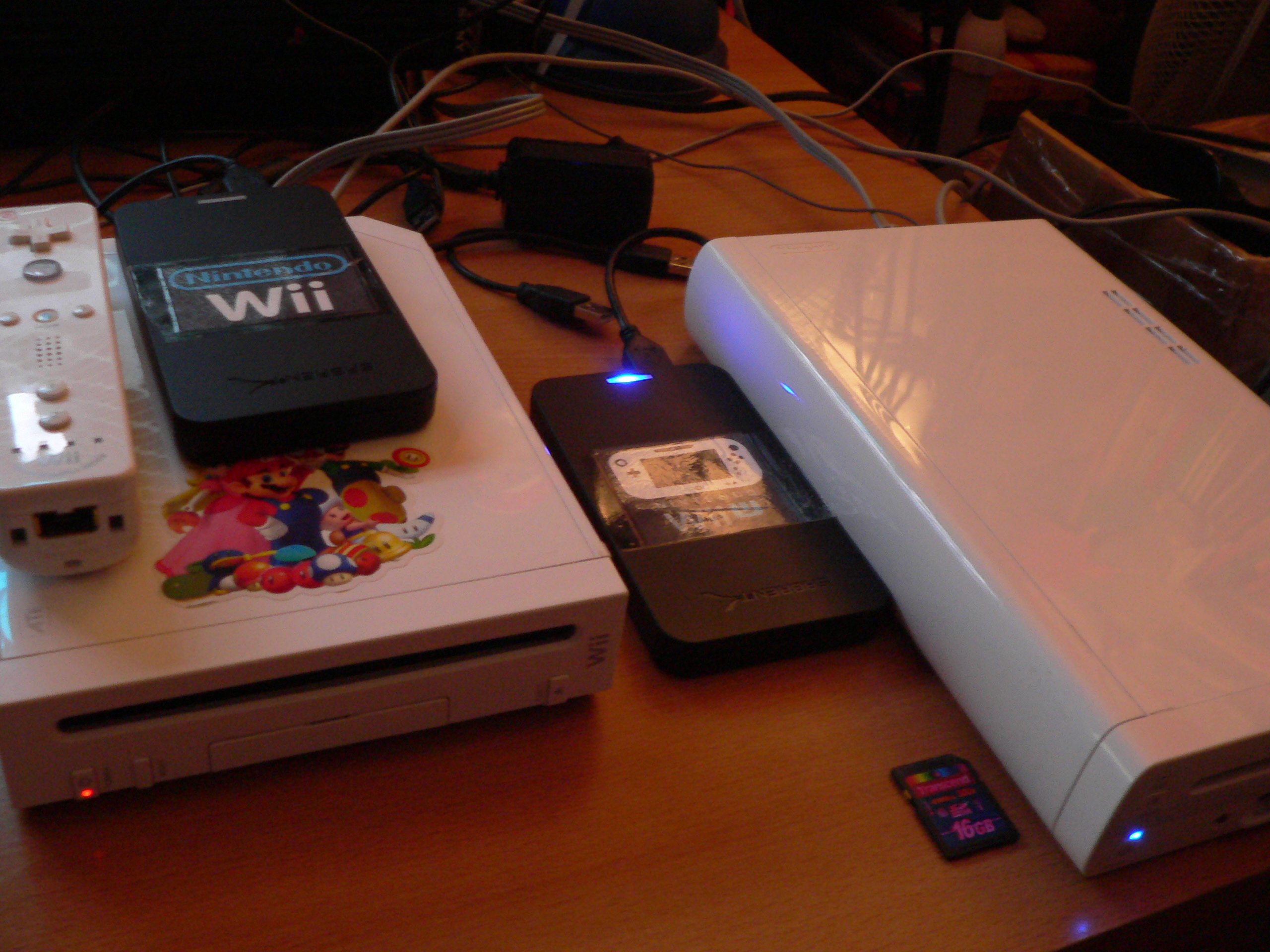

Hello.:)
I use this Enclosure:
https://www.amazon.de/gp/product/B00OJ3UJ2S/ref=ppx_yo_dt_b_asin_title_o00_s00?ie=UTF8&psc=1
with this SSD:
https://www.amazon.de/gp/product/B07VCCZZL7/ref=ppx_yo_dt_b_asin_title_o02_s00?ie=UTF8&psc=1
As you can see it works without Y-Cable.:)
The only Thing please: Do NOT place the HDD ON TOP of your Wii U.:rofl2:

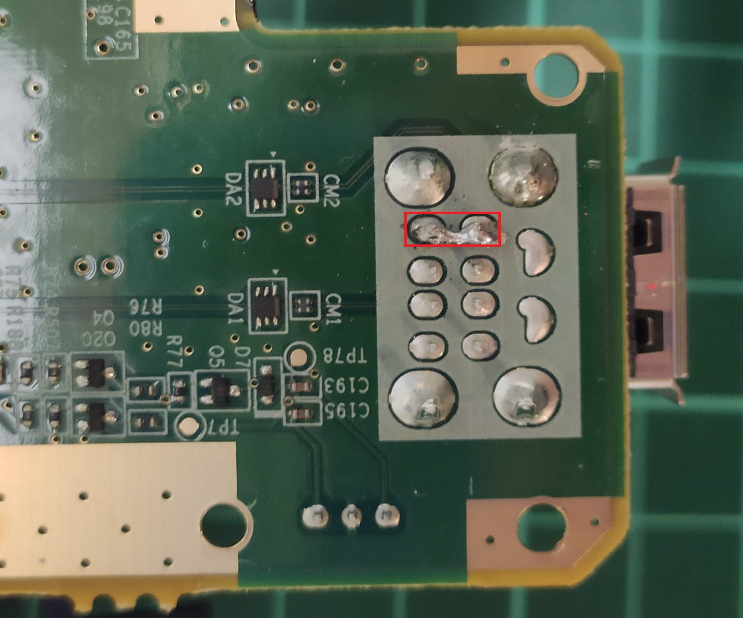

I wanted to do the "unlimited" 5v mod, but it is not the same on my wiiu revision: c656 is missing on mine.
I've soldered the two 5v+ pin on the other side. Works fine without Y usb cable now.
It's missing on most units (it wasn't in mine, too) but that doesn't matter. Let me translate from that german website:
Glad you found some other solution. :)
